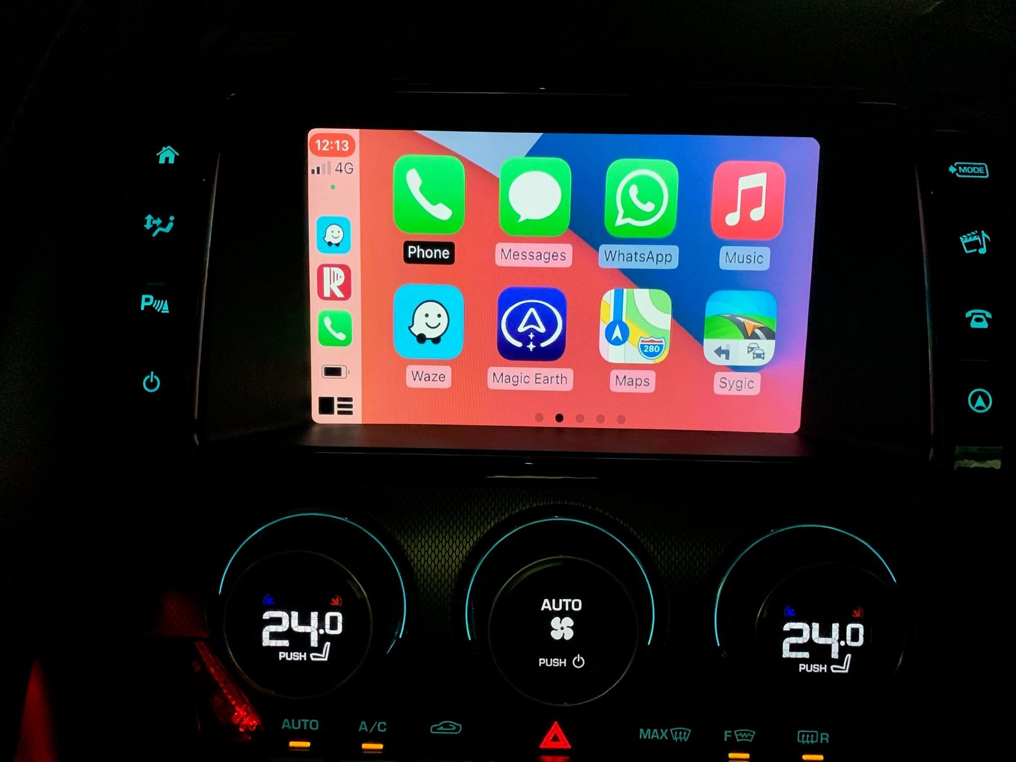

I noticed the light ring around fan is not illuminated.
Anyone have an idea how I can get this blue ring back on?
Ring around fan is not lit up?

is this a new model thing, i've never noticed any of these lights on mine

Can't be a recent model...the photo is of the upper console area of an early 2014 model (note the circle around the P on the park button).

Probably should pop that panel out (pretty easy) and check to see if maybe the bulb is out on the back? Car is ~7 years old now (2014 from your sig), so could have just burned out? Unlikely anyone on the forum will be able to diagnose your issue by looking at a picture of the front of the panel?

Using plastic pry tool remove the gear stick surround and the plastic trim above the climate control unit. Then it is just a few screws and unclipping the wiring harness and it is out. Haven’t opened it so you will be the trailblazer Should be easy enough to isolate the central dial light to troubleshoot. Good luck

Typically with most cars, the whole unit comes out and then you'd have to attempt to disassemble the unit itself. I doubt Jaguar sells individual parts within that unit, it's probably a replace all or nothing as that's what most manufacturers do... You could disassemble it and see if you can find something loose but again, I doubt you can purchase individual parts within the unit if something is broken. Could be something simple as a broken solder joint.

And the illumination will come from an LED, not a traditional bulb.

definite agree it is a led as ring is completely uniform in light intensity all the way around. What we are saying is that you have to open the climatronic unit itself to find the fault on this. Wether it is worth it depends on him much the missing light annoys you and you level of comfort in these things. You could alway take it to your local electronic repair shop and ask them to do it as it is only going to be the LED itself or as previously said the solder joint to this LED
