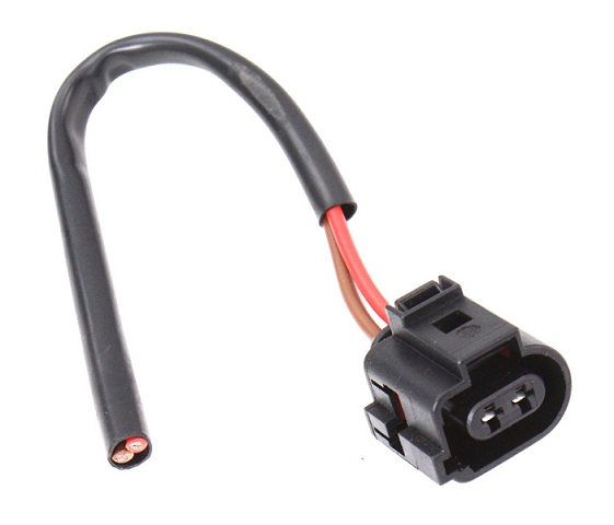

That is good then. But, I need some help from an F-Type owner ...
I do not have access to an F-Type. The actuator for the spoiler is either vacuum actuated or an electric motor. It is not particularly important which. What is important is to understand what the electrical connector looks like on the actuator. This would either be the electric motor or the vacuum solenoid valve.
For example, the electrical connector on the vacuum solenoid valve for the exhaust bypass valves probably looks like this attachment.
Also, is there a fuse block located nearby? For example, in the luggage compartment.
If I can get this info, I can do up an electrical schematic and parts you would need and provide a parts list to install a simple three switch that would give you the function you are looking for.
Steve
