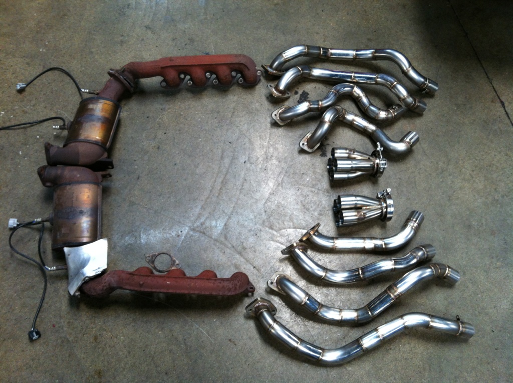

Combo,
I searched for headers on this forum and pulled up and skimmed a few threads. Laughably I found this quote from “Fricken” which is 90% of what I posted verbatim about firing order not mattering with a supercharged engine, Tri-Ys only working on NASCAR N/A narrow power band engines. Remember I also said out of all engines that can use headers (not turbo cars) positive displacement supercharged ones always gain the least. Always. But they still gain. Thing is we aren’t making much boost stock or even with the small blower pulleys on the market now. So when we do start making real boost, the gains will reveal themselves per usual. The old AMG E55s with 3v 5.4L V8s with 2.1L IHI twin screws gained 40-45rwhp and rwtq SAE with LTs with 200cpi cats at stock boost levels.
https://www.jaguarforums.com/forum/f...anyone-140739/
Post #3:
Originally Posted by Fricken
That being said, a proper individual primary setup instead of the log style factory setup would certainly see gains. Limiting heat soak, easing exhaust flow and controlling the firing sequence flow. One large benefit would be cutting back on the heat generated and held in this area.
With the supercharged engine we would see strong gains from a 4-1 style header since one doesn't have to focus as much on vacuum scavenging.
One the non-supercharged, something like a Tri-Y header that is used in NASCAR would benefit. A non-supercharged will benefit more from the exhaust vacuum from each pulse in the firing. Thus drawing the exhaust gases out of the cylinder.
One engine that comes to mind for a comparison would be the 2003-2004 cobra. 4.6L and the same Eaton M112 supercharger. Typical gains on a supercharged engine of this nature is around 30rwhp at the same boost levels.
The Terminator Cobras ran far less efficient superchargers than we have now and with a SC engine that’s really the only thing that matters: Size and efficiency of the supercharger. NA it’s about headflow, cams, intake manifold making the power, the bottom end just has to hold together.
I saw your post about Buckhead Imports LTs (out of business for a reason after one look at their header design, pre cut and weld garbage with cheap collectors and cheater bends or non parallel cut and welds for days):
Click the image to open in full size.
A 700HP car needs a 3” full exhaust period, end of story. 2.5” is simply not sufficient for anything over 500HP N/A let alone blown.
Later in Post #43 of the same thread you state:
Originally Posted by Combo
I still don't understand why you are pursuing the 4-1 design at all.
It's been tried, the results were not great.
It's been confirmed by the guy who actually worked on the development the AJ-V8 that a Tri-Y design (suitably sized) will be better in several ways.
Again, because of the firing order, cylinders 6 & 8 firing sequentially, loss of volumetric efficiency, charge robbing, etc...
Nobody's stopping you from doing it your way, but it seems a shame to make the same mistakes as others who tried it before you.
Do you know when and why Tri-Y headers were conceived? By Ford in the 60s as a space concession in the engine bay, sometimes a 4 into 1 won’t fit, but when they will they always produce superior numbers vs a comparably designed Tri-Y—Unless you are (again stating this) running a very narrow powerband ala NASCAR. 4 into 1s don’t care about firing order because the 4 into 1 merge collectors scavenge from 4 cylinders each, they also increase velocity at the cone/spike neckdown which aids in HP and TQ production. 4 into 1s also always produce more average HP and TQ than a Tri Y, and avg hp and tq is what wins races not peak hp and torque. Now again let me state for the record PD supercharged engines care the least about exhaust design. 4 into 1s are superior but the blower is the limiting factor not the exhaust design. It’s pushing air through the engine at near constant boost levels across the rpm band.
I’m sorry to say that factory engineers are not always Gods or even close to it. Most have never built an engine and have very specific duties. I cannot think of a single supercharged engine that has ever made more avg or peak hp and tq than a 4 into 1.
Post #58
Originally Posted by combo
Yep the RSR engines are a different firing order.
in response to Post #57
Originally Posted by FrickenJag
Tony and the guys did a great job with that engine. I'm dying to get my hands on a billet block and heads from them. Nicely engineered set of headers as well on that engine setup. I just noticed it appears to be a 4-1 collector setup. The cams were modified with a new firing order for more optimum flow.
As you just stated yourself knowingly or not, firing order doesn’t mean anything with a 4 into 1 design, the proof (for the non believers anyway) is in your quote, the RSRs have a diff firing order.
Last word on this as I’m dead tired in Detriot otw to CA now. Properly designed and manufactured 4 into 1s or even Tri-Ys will both gain power and torque vs the stock logs, there is ZERO chance of this not happening. Also the 2.5” to 3.0” increase in pipe diameter behind the collectors or after the final Y is hugely beneficial to engines making 700HP or more with forced induction.
Vmax is willing to do it, they black label headers and catbacks for other tuners, they just don’t think there’s enough demand for such a low production volume car with most owners leaving them stock and others satisfied with the stock exhaust sound—which is pretty damn good for a stock exhaust I must admit. But I’m a power junkie and if enough F type owners come forward we can have a proven full exhaust made in the U.S.A. with U.S. stainless steel and an optimal design. No offense to any other manufacturer.
This is the first time I saw a bigger crank pulley for an AJ133, who made it? Why did you think it was necessary? Last nights 11.7 @ 122 was with stock pulleys, we haven't touched the engine at all.
In any case i'd prefer to step back a bit from this thread.
It's your thread.
It's your car, it's your money, you're going to shoot for the moon regardless of what anyone says. So go for it and let us know the result.
If I find anything more to answer the questions i'll post it up, but now I've got to get back to work.... https://www.jaguarforums.com/forum/i...lies/frown.gif
Combo, first and most importantly no hard feelings brother. We are all in this together. You are more than welcome (I hope you do) to continue to post.
Vmax made it, it should increase boost by 4psi when using a stock upper pulley, a bit more with the smaller 1.8psi I have on now and others use as well. In theory putting me right at the edge of peak efficiency for this supercharger.
Why is adding boost necessary to make more power with a forced induction engine??? Well, how else are you going to make more power and torque besides a larger supercharger after an ECU tune?
Remember, boost is simply a measurement of restriction or backpressure relevant only to the engine it’s measured on. 20psi from a 2.3L stock hardware ZR1 (less pulley) is not the same mass of air moving through the motor as 20psi from a 2.3L ZR1 with ported heads, cams, LTs, exhaust—same boost level, but far more air (HP) being moved. Another benefit to adding LTs and a full 3” exhaust is dropping boost pressure (heat), IATs, and EGTs which not only make power and torque and allow you to run more consistently but also increases engine durability and longevity.
Ok catch you guys tom, I’m BEAT.
Hasta!!!

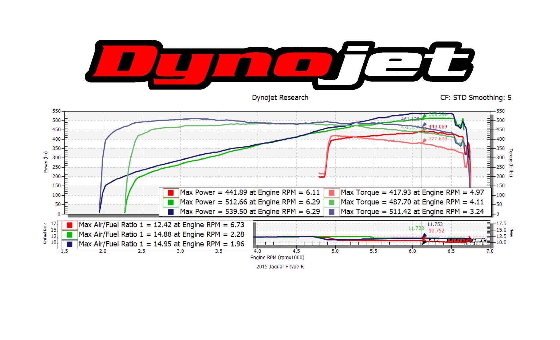

AFR is closed loop, therefore there is no need to teach the ECU what to do.
Check your data log. We did not experience that with the reduction pulley on the V6. It can run over lambda 1.0 (14.5 AFR) at full throttle at lower rpm. The tune needs to correct for that.

Here are my A/Fs on the dyno. Mid to high 11s up top. As you can see the factory tune is very rich especially for direct injection. I’m right where I should be with DI and a positive displacement blower. Enough extra fuel to cool down the intake charge after the blower heats up the compressed air.
Thanks!
Attached Thumbnails My New 2016 Jag F Type R (Pics) Now Tuned-2015-jag-f-type-tune-results.jpg
