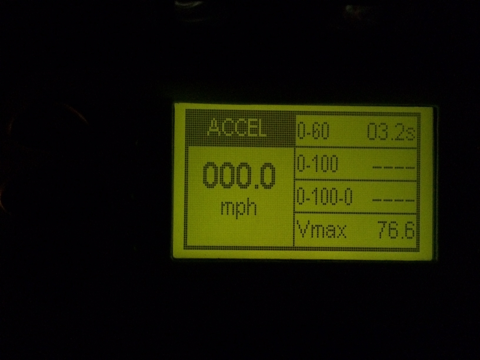

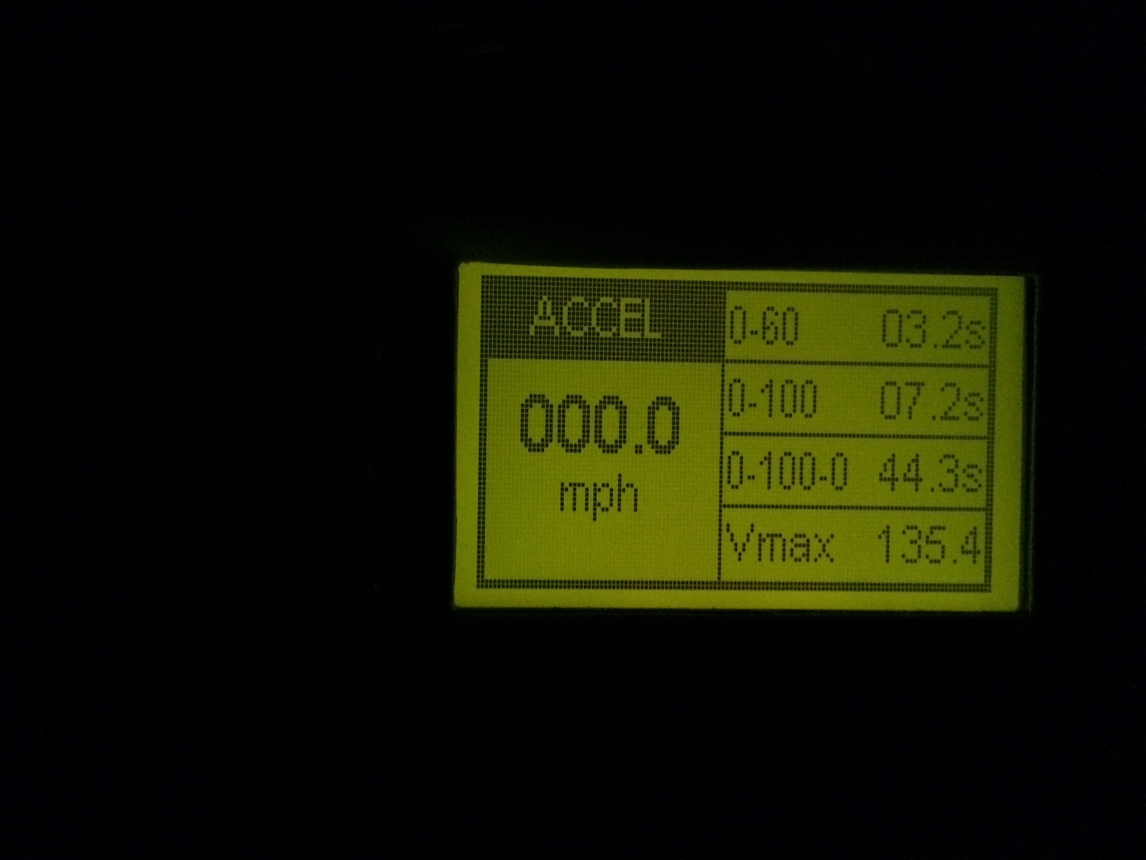

So here we are the last vbox or any numbers from my Jag until spring, car is already in winter storage as of 7am this morning. Going to keep it short and sweet as the numbers speak for themselves and I have to get to bed. I sent the pics and vbox files over to VMax to have them post this for me. They wanted to display the time & speed graphs and I don’t know how to work the Performance Box software like they do. To say I’m pleased with the results would be a huge understatement, thank you VMax!
In the pics of the VBox (what you can see in the car while testing without pulling the chip out and putting it in a laptop while driving) you can see I ran 3.2 seconds to 60 (actually three times) and 7.2 to 100mph (twice). You can also see a breakdown up to 70mph of a 3.2 second 0-60mph run up to 70mph (4.1 seconds to 70mph). Needless to say, happy as hell car is a Beast even with the non performance oriented wheels and tires I have on it now.
Thanks to Jay for the launch tips, I brought the brake stall rpms down to just off idle and still spun a bit but nothing close to what I was doing before!

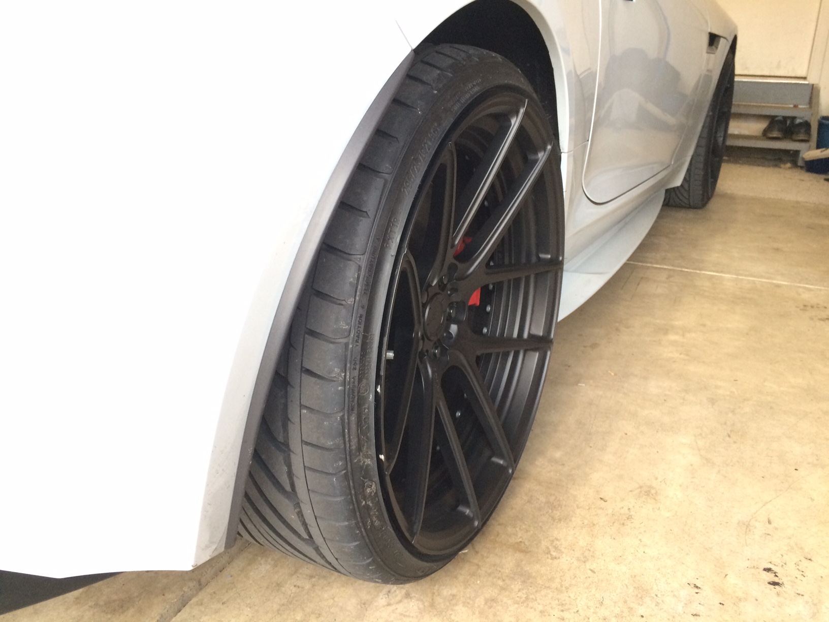

Also attached are pics of my 21” ADV1’s with 295 Series Toyo Proxes. Obviously I’m shooting myself in the foot as far as performance with this wheel and tire package but it looks damn hot and I’m keeping them. J I do wish I would have left the factory wheels and tires on to test with however.
I’ll leave the rest to VMax to add to and post, thanks guys!
James

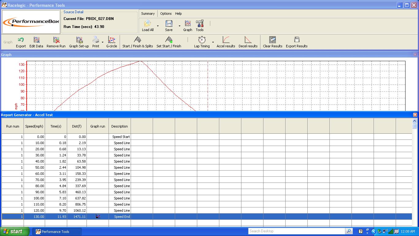

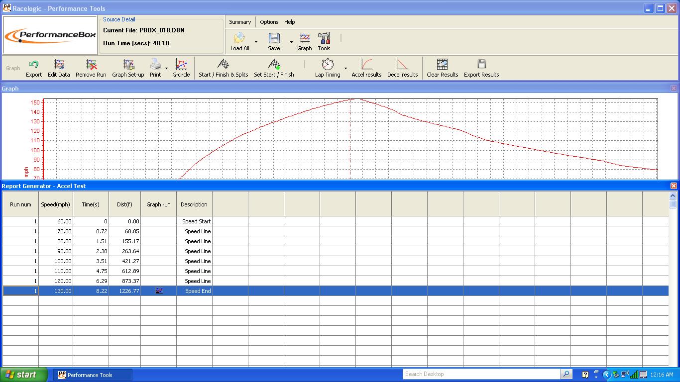

Default vbox breakdown from jamesjaguar's VMax MotorSports Tuned 2016 F Type R
Gentlemen, first of all a giant thanks to James for getting out there and getting us all results, we really appreciate it and we have a pleasant surprise for you, which is why we wanted James to send us the files.
As you can see, and for those not familiar with Vbox’s they round up to the next tenth on the display even if you’re at X.11 or .01 over .00 during any speed or time testing. The display only goes to the tenth, using the files we can get to the hundredth place. As you can see James’ car actually ran 3.11 seconds to 60mph and 7.10 seconds to 100mph then 11.93 seconds to 130mph. This was the from one of the 3.2 seconds to 60mph and 7.2 seconds to 100mph passes he made.
For the simple changes made (our ECU tuning and small upper supercharger pulley) the car is humping to say the least. We can’t stress enough how much the 21s with rubber band tires hurt launch, we very likely may have seen a 2.9x 0-60mph number on the factory wheels and tires. I know there is a lighter rwd F type running drag radials at ATCO somewhere at the top of dragtimes. You sir would be the prime 2.9X 0-60mph candidate especially at the track with VHT on the pad J 60-130mph James ran a best of 8.22 seconds, stock the best we can find using the same Vbox or Pbox GPS based data acquisition system is via Car and Driver magazine at 10.3 seconds.

James - awesome results! So good to see other f-type owners out there really getting at it with their cars
I know those 21's are hurting you...but DAMN those ADV1's are amazing - please post a full shot of them!

They are some great looking wheels, even if they eat a few tenths, I have to admit.
