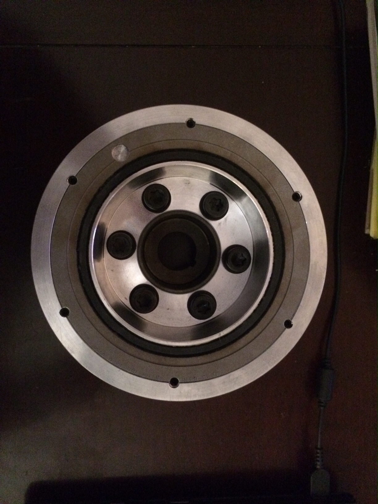

Then the 1.8psi pulley went on that night and the next day we made 540awhp/511awtq STD. Are you sitting down? That translates into a SICK 675HP/639lb/ft STD at the crank!!
After talking with numerous tuners of awd vehicles they all say minimum DT loss for an AWD vehicle making the kind of torque we are is 22%-25% due to the heavy driveline components needed to handle that torque and also because of my steel rotors and our big and heavy 20” wheels and tires. Meaning the factory 550HP/502lb/ft rating is underrated!! Also those with ceramic brakes will pick up another 8-10awhp and awtq due to the lower unsprung reciprocating mass vs steelies!
Using 22% (the minimal factor listed above meaning divide the wheel numbers by .7 and taking the baseline readings we can calculate that our rides are making 571HP/568lb/ft SAE at the crank stock! Thanks Jaguar!!!
With VMax ECU Tune Only, or what they call S1: 658HP/627lb/ft STD at the crank.
With ECU Tune and Pulley, or what they call S2: 692HP/655lb/ft STD at the crank on straight Shell 93 octane!!! I was told if I was to choose to run race gas (ie 100+ octane) the ECU would automatically adapt and I’d pick up another 10-15HP and TQ with no other changes meaning we can crack 700hp at the crank and still be emissions legal.

Vmax is in the process of testing the pulley for durability now for their
+10mm crank pulley for the 5.0L AJ Series SC V8s. That's all I know other
than I have one but was told not to install it until they give the OK

This is the first time I saw a bigger crank pulley for an AJ133, who made it? Why did you think it was necessary? Last nights 11.7 @ 122 was with stock pulleys, we haven't touched the engine at all.
