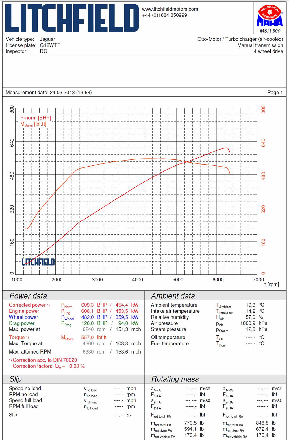

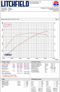

Ran the SVR on Litchfields dyno today and am really impressed with the results as car is stock:

Looks like they may have used a manual transmission correction factor there; probably the reason for the high numbers... Regardless those numbers pretty much mean nothing unless you've got something to compare them to. You could run 600+ on one dyno and 550 or less on the one right next to it.

Is that a rolling road or a hub dyno?

Maha MSR500, it calculates on coast down, it was a GTR dyno day so the dyno knew it was running automatic based cars.
Car was ran in dynamic, TC full off, sport, 5th gear.
Agreed no other Jaguars ran, I just tagged on at the end of GTR day, had to be the end as they had to shorter the dyno too accommodate the ftype shorter wheelbase.
No idea on accuracy but the car is clearly healthy, especially after pulling close to 190mph (speedo) on the vmax 1 mile runs couple of weeks back and smoking every other car off the line.

In the UK we are less focused on wheel power, we like to see what our cars make against manufacturer claimed flywheel power, as no manufacturer advertises wheel power.
Maha are very common in UK/EU, infact I believe manufacturers like Porsche, Audi, VW use maha alongside engine dyno's to test their own cars.
This link best explains the maha and how it works as it does not uses fixed corrections or correction factors:
https://www.monstertuning.co.uk/dyno...ng-road-tuning
They are great for flywheel power as no BS oh just add 20%, 25% to the wheelpower figures as that is total BS, it calculates from coastdown.
Of course if your into wheel power, then on the flip side maha is a bit of a heart breaker, a dynojet even mustang dyno will generally give higher wheel power figures, but can't give you flywheel accurate as they just used fixed percentage / corrections to take a guess.

Sounds like an assumption; your dyno sheet says manual transmission on it.
Anyways, don't get your hopes up on calculated dyno numbers. Regardless of how they calculate it, a dyno is inherently inaccurate. Different temps, atmospheric conditions, fuel quality, etc. all make a huge difference. Unless you ran a bunch of other SVRs on the same day its hard to really say if your car is special or not.
Don't take what they told you as gospel here. That link you provided doesn't tell how the system calculates crank horsepower at all; they just says the dyno calculates it without any more information.

To have some sort of idea how to compare these figures on this dyno it’s needed to compare results from a stock car in relatively the same conditions (also system setup).
What adds to the complexity of comparing is that the ECU is limiting the engine max torque, and dynos use correction factors for temp/pressure.
For engines that do not have these type of limiters, and always are on full power, you can use the SAE/DIN corrections for temp/pressure
For the stock Jaguar engine this doesn’t add up, as the ECU compensates for temp/pressure losses as it will only limit the max power based on the calculated torque. So with dyno corrections, you will get lower results in cold/high pressure conditions compared to hot/low pressure ones.
Therefor I mentioned to compare with relatively similar conditions to get some idea.
I don’t know how Maha is doing there flywheel estimates with, but most use as a basis a roll out after the power run. That does give some insight into the forces at play, including the way the car was strapped down on the dyno and roller types. That leaves out the full power friction losses, but I am sure Maha has done some good testing and knows a thing or 2 about it to come close.

End of the day its just a number, more importantly is the power curve and the torque and power curves are absolutely stunning, no flat spots at all.
On the day my mates GTR made 660HP its a Stage 4, at Vmax one mile racing we did couple weekends back he was on race fuel with 690-700HP and I beat him every time to 150mph at which point he catches back up and then pulls away which is his additional HP coming into play. On the road upto triple digits with him on normal fuel there is nothing in it, even real him in marginally, triple digits he pulls 1/2 to a car length away.
On the day the other SVR which was running had ceramics and I do not, but I won every time, but I put that down to my technique off the line seems to work better.
Main thing is car is clearly healthy, is making the power it should be and maybe a little more.

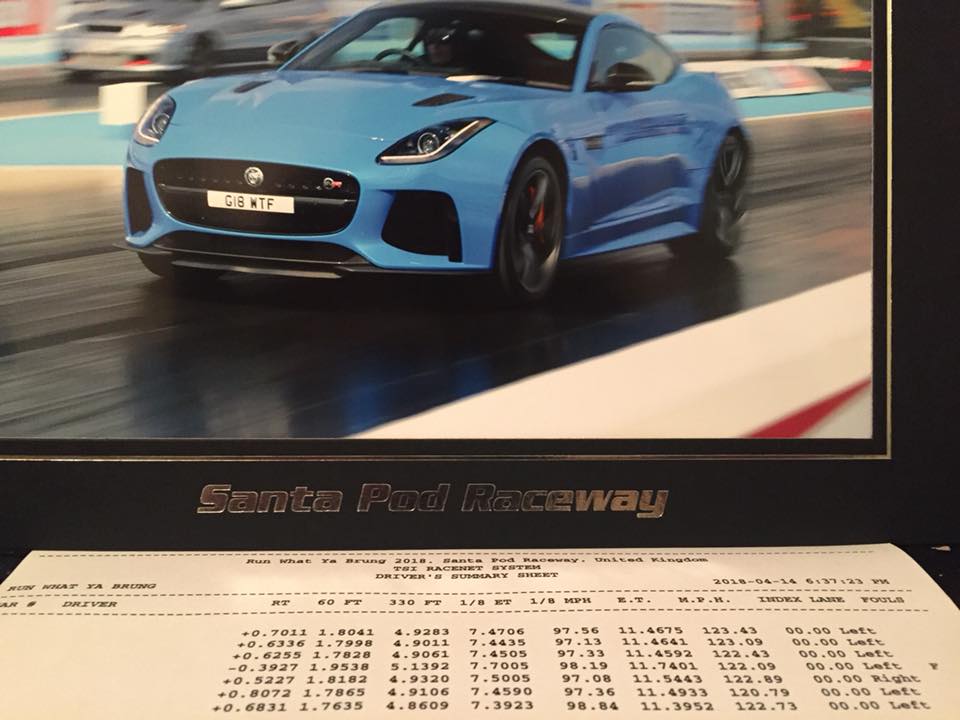

Took my SVR Drag racing today at Santa Pod in the UK, a surprisingly warm sunny day for the UK (22c) and the SVR continues to surprise me as achieved a best of 11.3s today and I think I can maybe improve that a touch more as I was experimenting and my very last run was the best run:
Run 1: Dynamic, but suspension soft, gearbox in normal and letting it change up at limiter. Launch from line with half throttle then full!
Run2: Dynamic, but suspension soft, gearbox in normal and letting it shift first gear, then me afterwards. Launch from line with half throttle then full!
Run3: Dynamic, but suspension soft, gearbox in dynamic and in full auto S mode and just matting the gas pedal hard.
Run4: Jumped the lights, lifted but then decided to get back in it and run.
Run5: Full dynamic mode, even suspension, gearbox in S and just mashing the gas pedal. (Notice how the suspension set to hard has marginal negative impact on 60FT and thus impacting ET.
Run6: Dynamic, but suspension soft, gearbox in S full manual mode and me changing myself and short shifting 4th around 5000rpm to use 5th instead of revving 4th out, result slower and lower terminal.
Run7: Wet Mode, Gearbox in sport and full manual mode, kicking throttle hard but not quite full then flat. Wet mode gave a substantial reduction in 60FT and thus my quickest time of the day at 11.3s
TC was fully disabled for all runs and car was in vmax mode for all runs!
Next week, wet mode it is and perfect the throttle from the line, hopefully 2PC brake rotors on in time for next week, be interesting to see if they have any impact, doubtful but be good to see, would like to crack a 11.2s out the car as that pretty much guarantees a 10s car with tune and pulley upgrade.
Some more photos taken from the day:
So impressed with the performance of this car!
