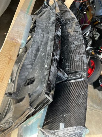

As the story begins, I received the shipment of the SVR hatch. The seller did a great job of packaging and shipping the hatch via FedEx Freight from FL to CA:
Shipment received! The fun begins .....

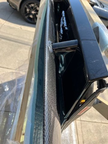

The hatch arrived with the wing in the closed position. In this position, the wing cannot be removed, causing the issue that started this thread.

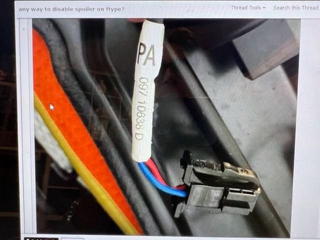

The wing needed to be activated into the open position so that the wing mounting screws could be accessed, allowing removal of the wing. Here you can see the screws mounting the wing to the actuator arms that I am referring to. When the wing is removed the cover plate can come off, allowing further access to the actuator assembly underneath the cover plate.
I ended up cutting an access hole from the hatch interior so that I could get to these wires and apply 12V to the actuator motor, deploying the wing ..... note: the actuator motor can open or close the wing, depending on polarity of voltage applied to these 2 wires

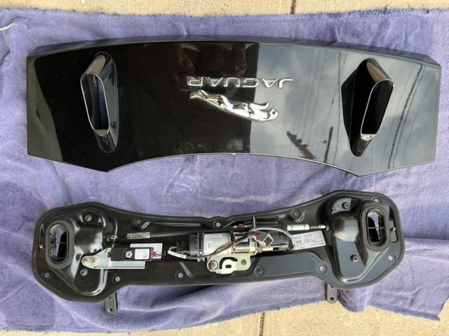

Once the wing was deployed, the project could continue. After removing the wing, I was able to remove the cover plate and then unscrew and remove the actuator assembly ....

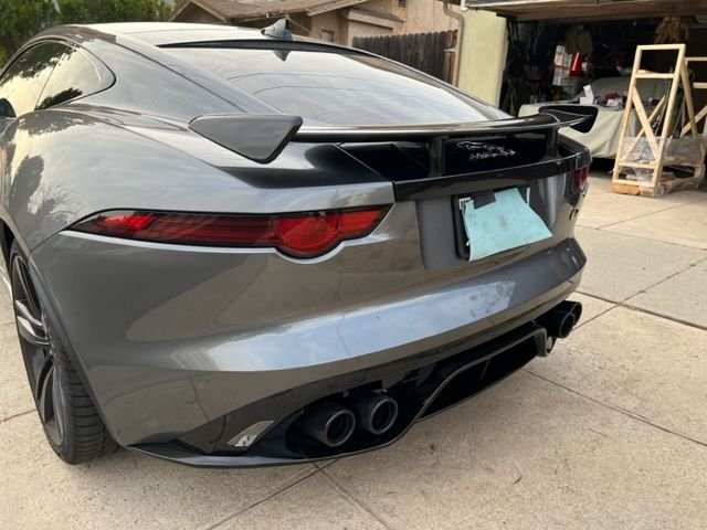

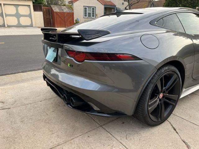

And from that point on, everything was plug and play. Here is a "soft fitting" of the wing.
After the soft fitting, parts will be removed and sent to the painter. I'm still debating if I should paint the lower wind deflector or not (I kinda dig it in black) ......
