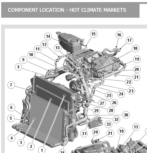

These are build sheets for a V6 base and a V6S
Base model:
-Engine Power Source- 340/450
-LESS Engine Cooling System
-Engine Cooling Fan 500W
V6S:
-Engine Power Source- 380-470
-Engine Standard Cooling System

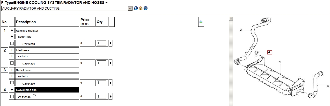

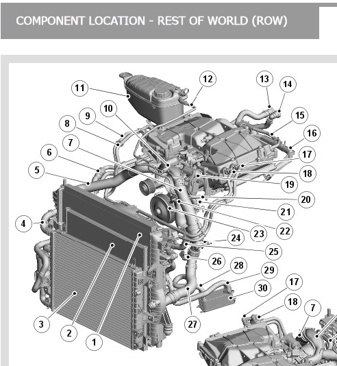

EDIT
OK I know what this means now.
For "Hot Climate Markets" there is an auxillary radiator which is mounted down low, in front of the main radiator.

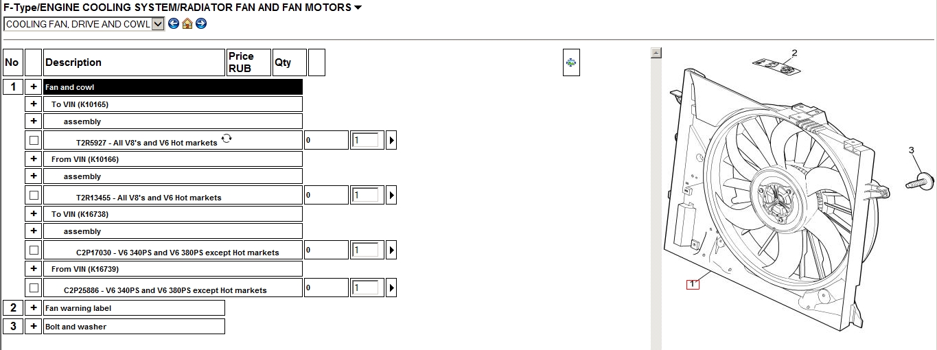

And there is also a different radiator fan for V6's in Hot Markets (the same fan as the V8) the V6's in non-Hot Markets have a weaker fan by the looks.
It's not a case of V6S has better cooling than V6, it's the market specification of the car.

I figured as such but both build sheets are based in Los Angeles. I'm not sure if there's a rhyme or reason on certain cars getting the aux radiator despite being in the same market.
