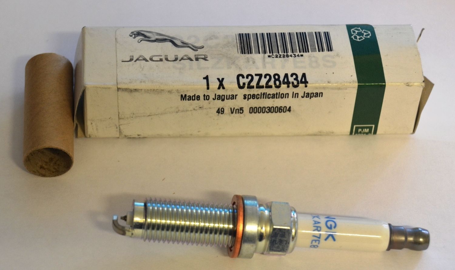

There are actually two plugs listed for the AJ126S, it varies by VIN range.
AJ812988, up to K05405 in the F-Type, up to U04717 in the X250 XF
C2Z28434 from K05406 in the F-Type, from U04718 in the X250 XF
AJ812988 is the SILZKAR7C10S
C2Z28434 is SILZKAR7E8S according to what's under the label of the OEM box.
If you break down the NGK part number into piece....
SILZ KAR 7E 8 S
There is a plug for the Nissan R35 GTR
DIL KAR 8A 8
https://www.ngk.com/product.aspx?zpid=9718
I think that's the closest you're going to get, compare the specs to the OEM part https://www.ngk.com/product.aspx?zpid=47770
