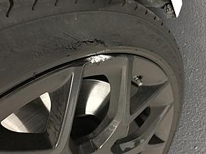

Hello all,
Had a small run in onto a sidewalk. I dont see any tiny fractures other than the obvious scrape. The rubber on the tire also has a small tear but that too is not deep (its more of a 2 cm slice of the rubber)
Is this of any concern? I have a long road trip coming up so wanted to be sure. Any suggestions/tips would really help.
Thank you!

Personally, I wouldn't take any chances; it's just not worth the risk. That tires sidewall appears to be compromised sufficiently that I would absolutely get it replaced (highly doubtful it can be, or even should be, repaired). The wheel can easily be repaired by a good wheel shop...even those who come to you.
Good luck.

Do not go on a road trip on that tire!

+1. Definitely not.

Live a little - superglue the tire, get the rim repaired. Don't be a wuss.
Don't laugh, but I've done exactly that not once but twice!
Each time there was a largish slice/nick in the rim protector part of the tyre and a bit of gutter rash on the rim (not as bad as the OP's), and close inspection of the slice/tear in the rubber showed that it hadn't penetrated anywhere near the structural part (so the rim protector sort of did it's sacrificial job, otherwise the damage to the rim would have been much worse). I simply superglued the torn bits back down, and unless you knew exactly where to look you would never know.

New. Tire.

Thank you for the inputs, I am ordering a new tire...
