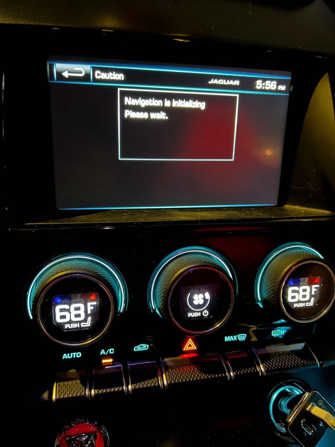

There was a sudden loud, sharp noise that lasted less than a second and music totally went out. No more sound even from the parking sensors nor from the radio. Turned the car off for about 2 hours and went back to check and came back to this.
Notice how the Audio/Video box is darker and shaded off, I can't click on it nor connect my phone to bluetooth. Radio, parking sensors, and anything else with sound doesn't work. Nav doesn't boot, just gives some sort of loading message. Nothing happens when pressing the buttons on the right side either.
Anyone else have dealt with this issue? I've already disconnected and reconnected the battery to hard reset and nothing. Battery is only 3 months old. Fuses all look good.

Weird. The noise could have been a spike but it also could have been a corrupt signal or interference or maybe the aliens are trying to tell you something 😂 The sound and the behaviour afterwards makes it sound like a module or amp went pop, beyond that wild guess I'm not sure I can help much. I'm interested in it tho and will follow the thread, be sure to post an update when you fix it!
I'd post a photo of the loading message that the nav module shows, as well as any other error messages you've seen... also when you say "parking sensors don't work" do you mean they don't work at all, or is it just the audio that doesn't work?

here’s the message the nav gives, no matter how long I wait nothing it doesn’t change.
and parking sensors work fine, it’s just the Beeping audio that’s gone. Even when I press the screen buttons for instance “setup” it used to make a responsive beep but that’s gone also.
My guess is maybe I need an audio software update?
