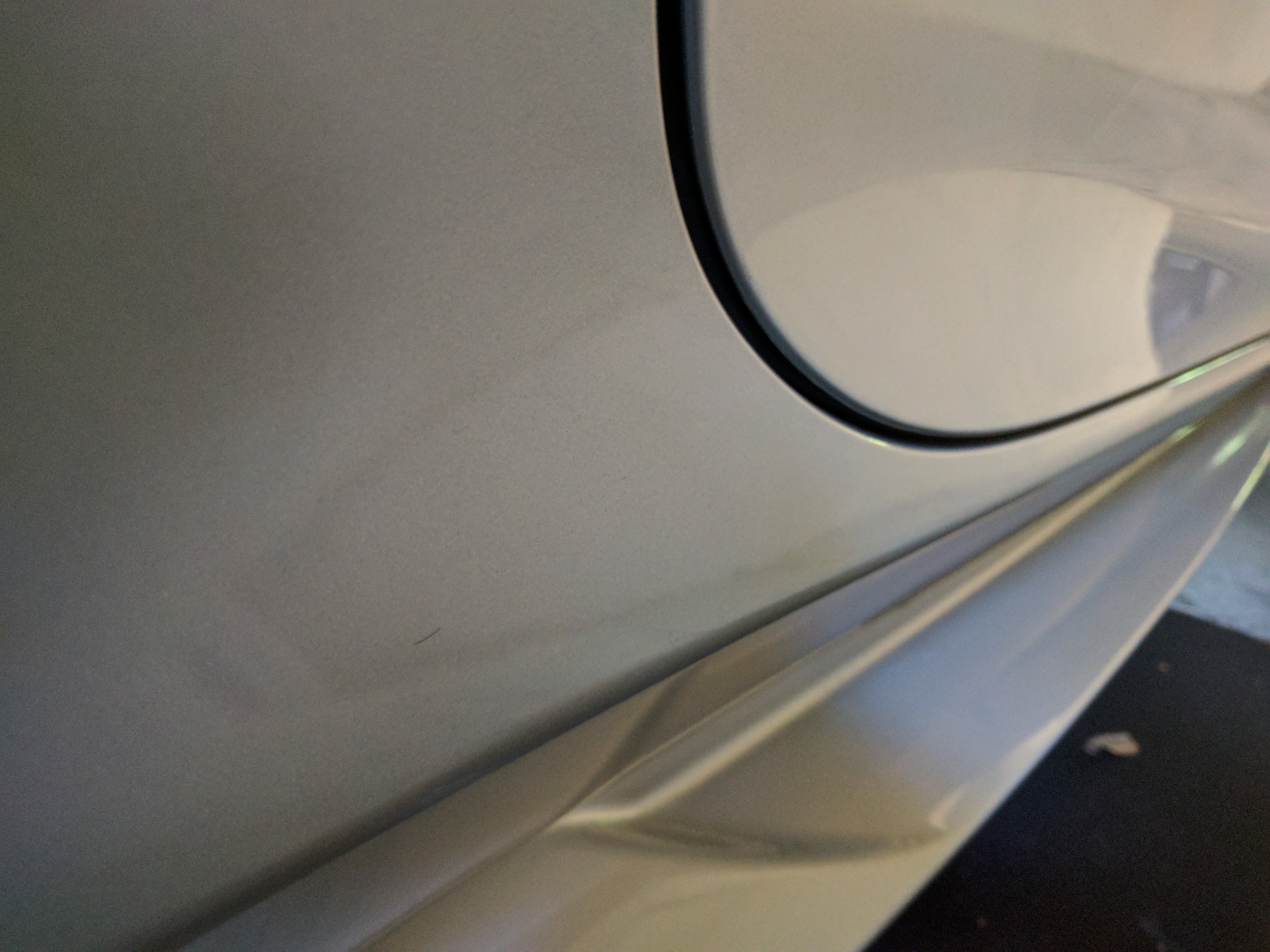

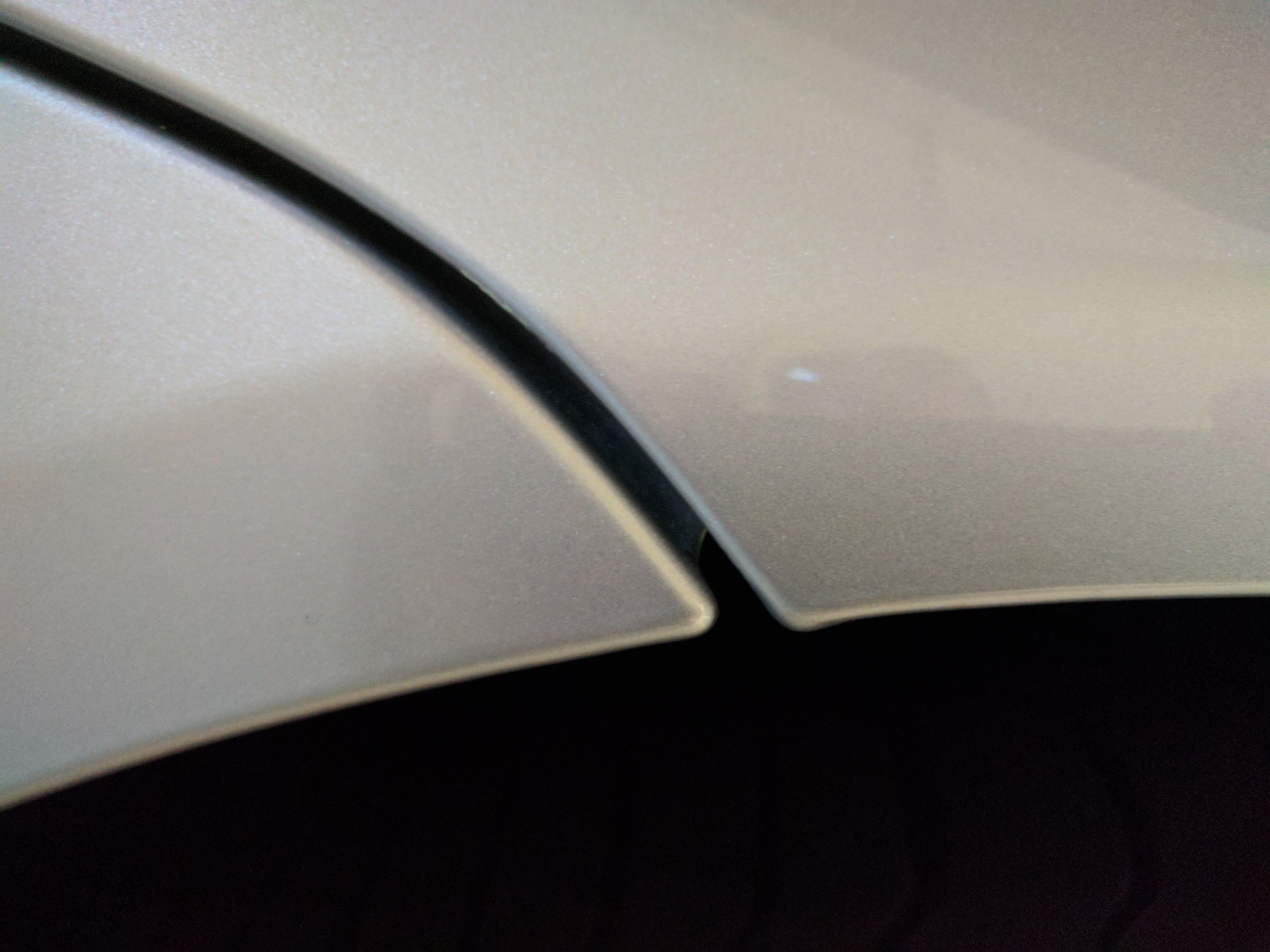

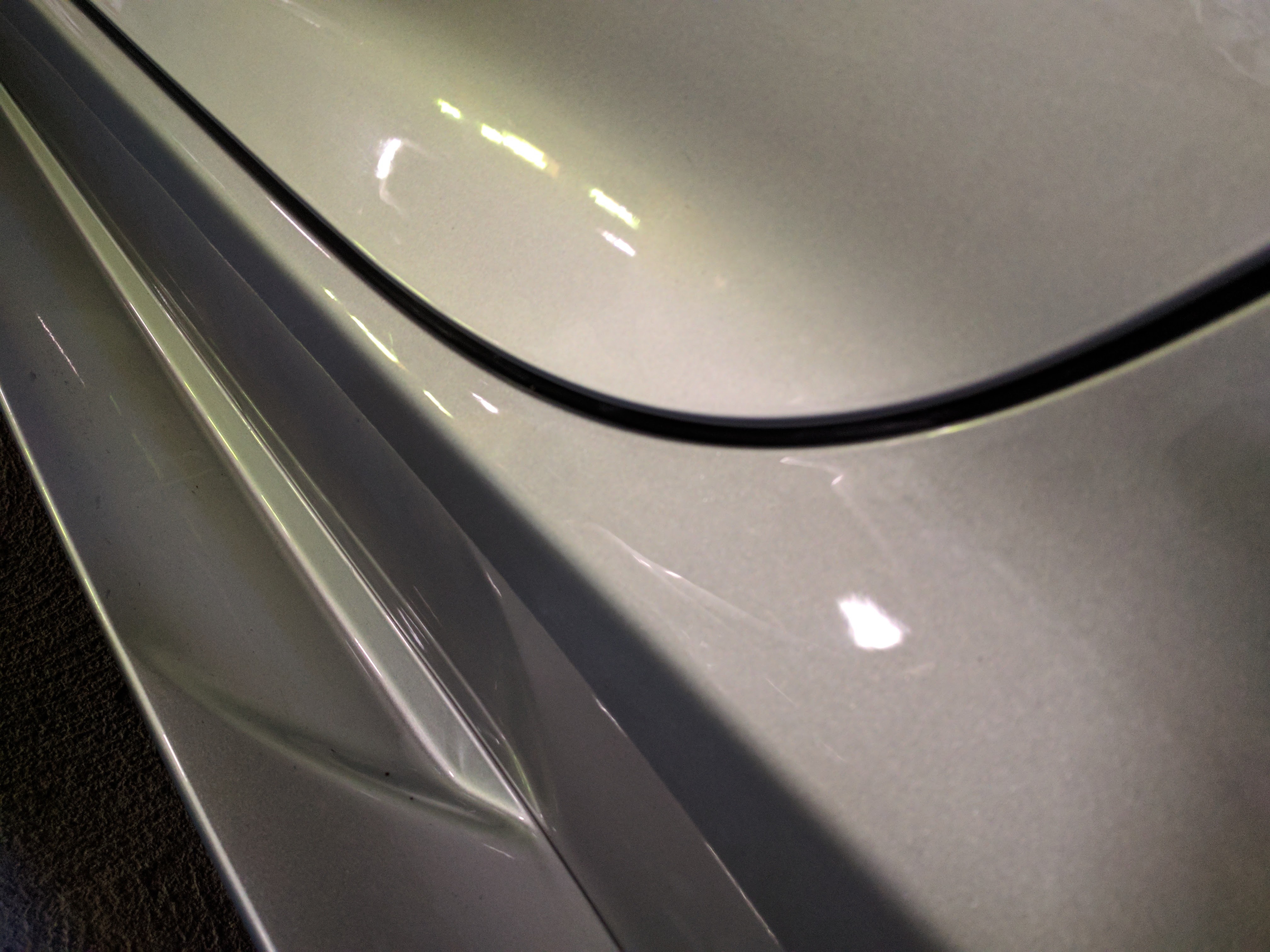

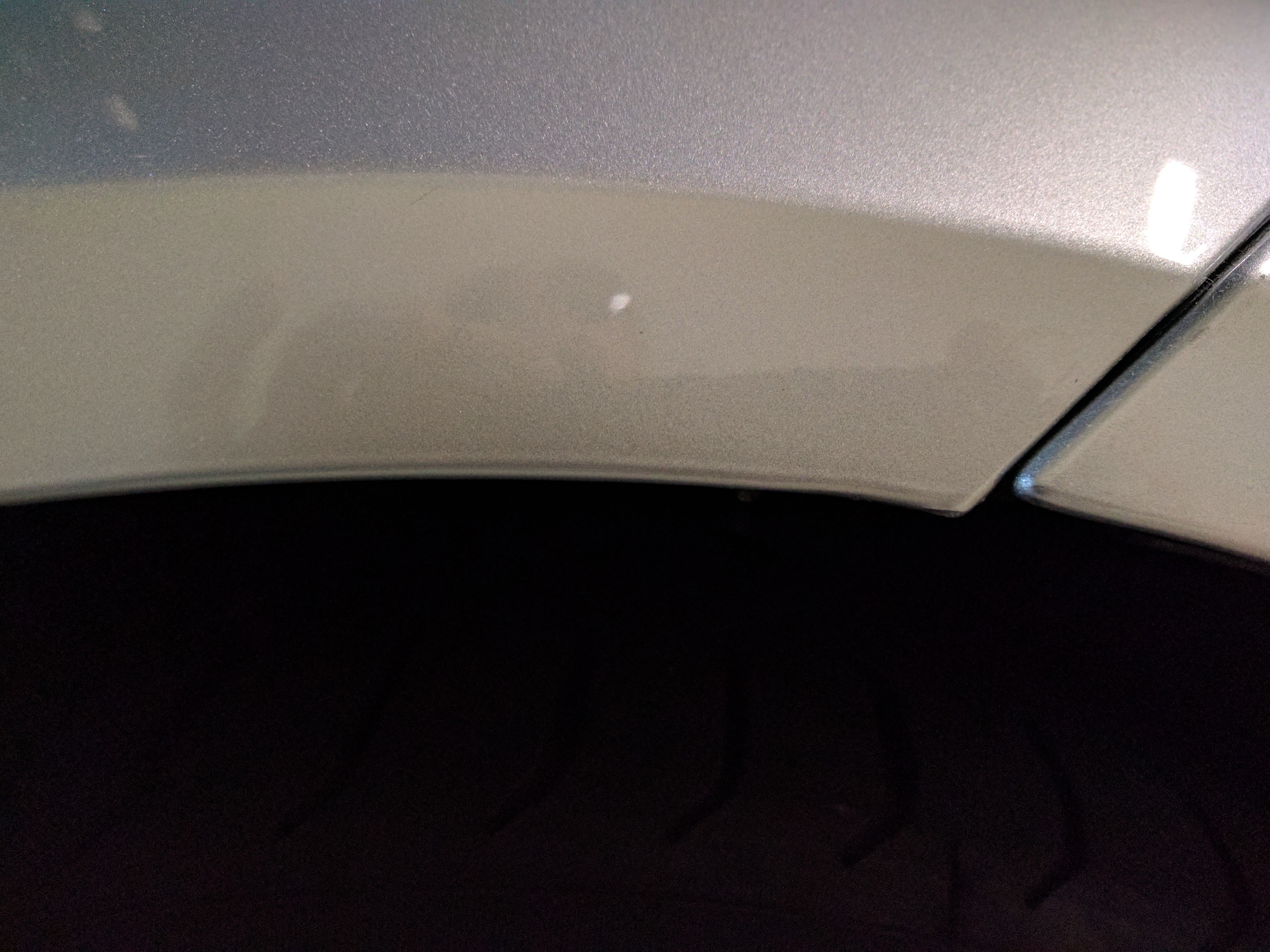

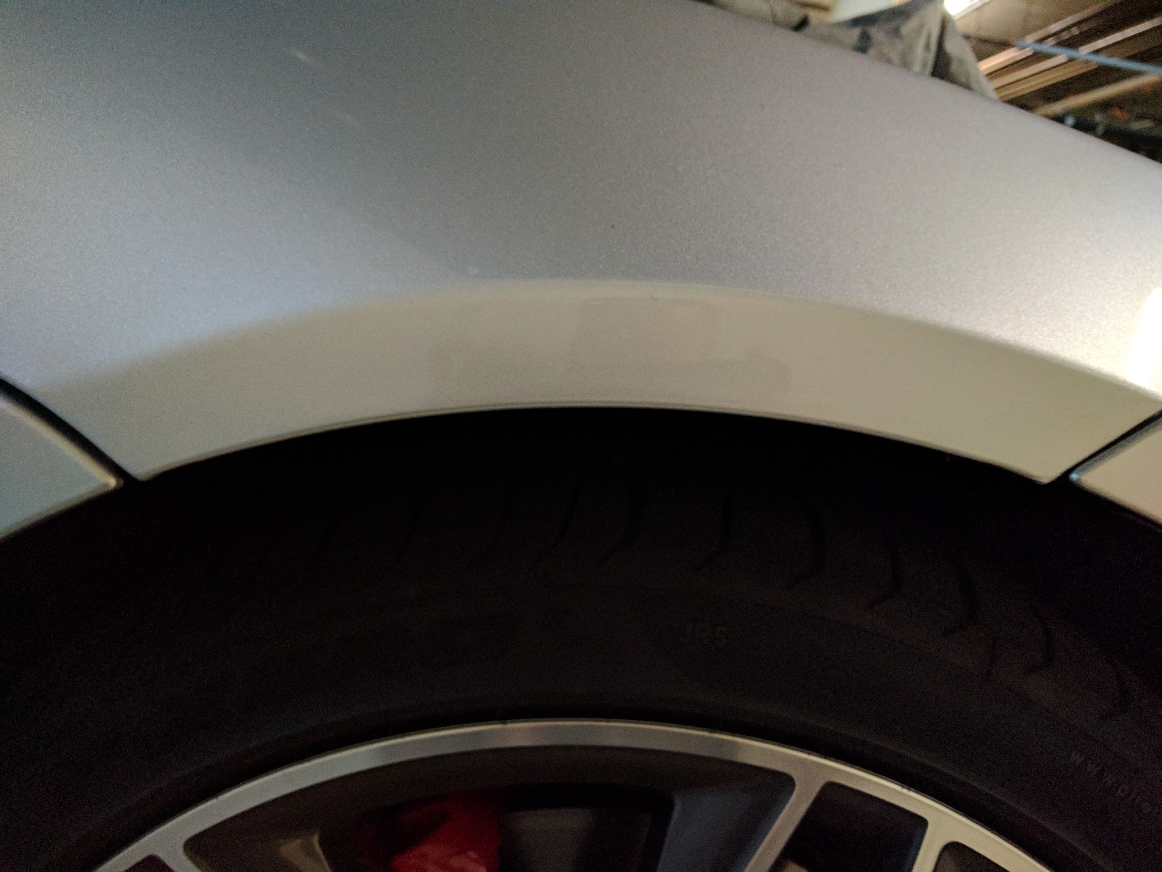

Hi Guys just come over from the XKR forum as after 13 years I sold it and bought a 2016 F-Type R AWD ex demo with 2300 miles. So I am the first registered owner and it still has just under 4 years of warranty and service left.
After I got it home I can see a few issues with panel fit and one issue with paint. The drivers door at the bottom edge does not fit well see pics passenger is better but still sticks out. I also have bad fit passenger side with the hood/bonnet to body at the front above the wheel see pic.

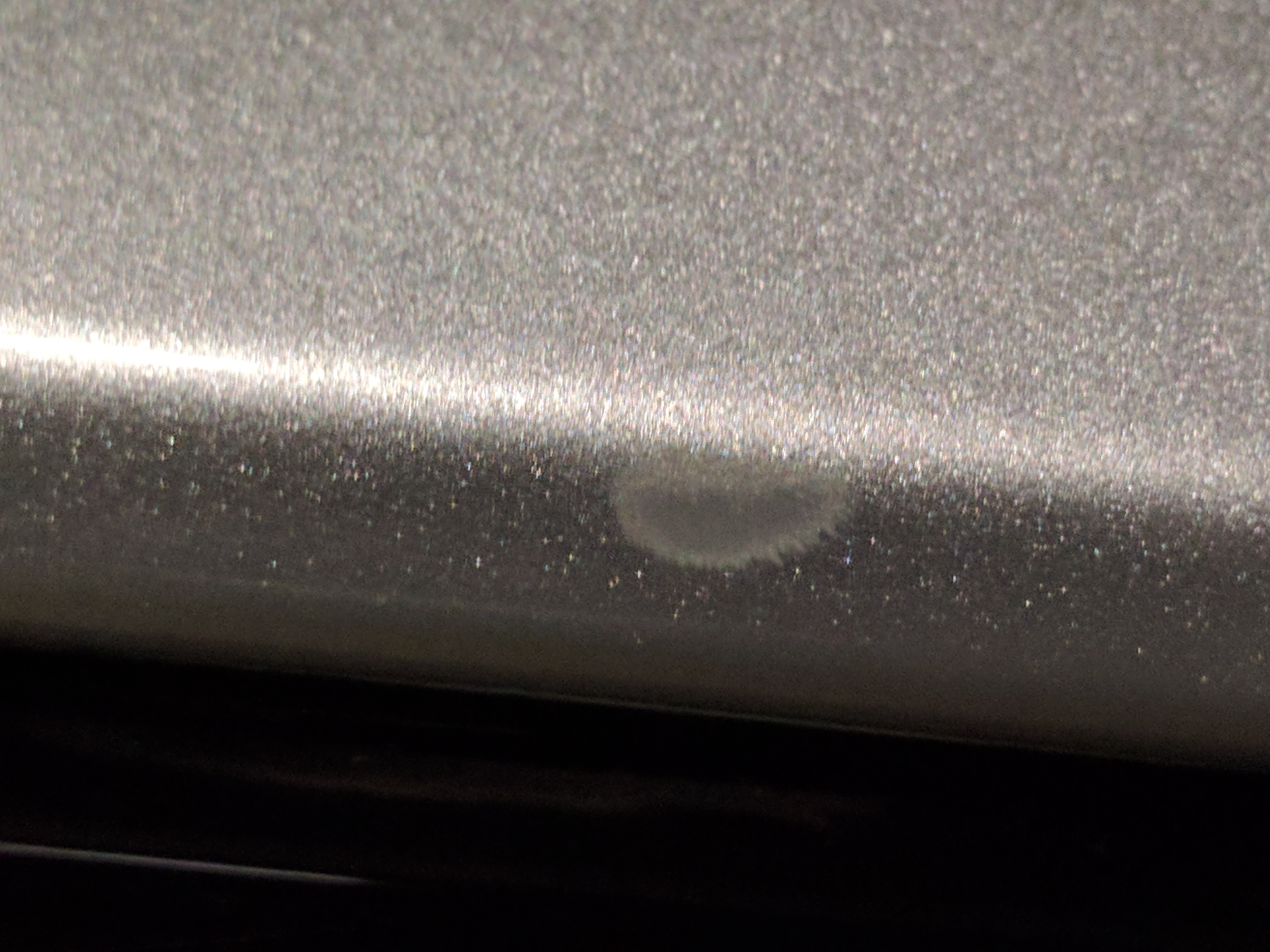

The paint issue see pic is on the front lip above the grill. I could easy fix this I guess.
My question is do others have this problem and will Jaguar fix this or will it be considered to be within tolerance given the dealer made this a demo car just over a year ago.
Also have the issue with filling the car with fuel it pops all the time I assume they have a fix for this now. Yes Im in CA USA

I had similar issues. They should fix if it was sold as new. Only hitch may be the panel alignment warranty only covers first year. I would definitely insist - a good dealer will take care of it. Worst case it might be a few hundred dollars at a good paint/body shop. Also note that closing the bonnet from one side (instead of in front) can tweak the alignment.
There is also a fix for filler issue, but I believe you need to complain (TSB vs. recall)

As Greg mentioned, the hood can close a bit cockeyed if you don't push it closed from the middle. Affects gaps on both sides until you close it straight.

Doors are normal. Mine stick out slightly at the bottom too, but line up everywhere else and weatherstripping seals are good all around.
Hood is an alignment issue possibly aggravated by it not being closed properly.
Front end looks like a scuff through the clear. Could try compounding by hand or buffing, but it looks more like it will need a touch up.

Thanks for the replies the doors seal ok and gap is even they just stick out especially the drivers door. My fear is they would mess the gap up and who knows what else if the try to adjust the doors.
Gap on the hood appears to be the front plastic fender (I can push this up a little) rather than the hood/bonnet as gaps else where are even. I'll take a look I bet I could adjust that fairly easy. Yes I always close from the middle with a slam shut! LOL as its so light compared to my old XKR.
The paint spot is down to the gray primer I have touch up on the way and already have the proper clear coat so that should be an easy fix.
Ok so only thing I'll get the dealer to look at is the filling problem I believe the new part is T2R13703.

It's not the doors - it's the rocker panels. Look underneath and you'll see the fixings.
The bonnet is trickier....

Are the rocker panels adjustable I couldn't see anything, panel under the door looks like its part of the body.
I did notice a video add for an SVR and in the video you can clearly see the hood/bonnet alignment was out as much as mine so its looks to be just how it is

my door is like that as well (passenger is flush, driver has a lip). Pointed it out to dealer and they shrugged. Nobody but me can tell so I stopped worrying about it. Compartment is water tight.
