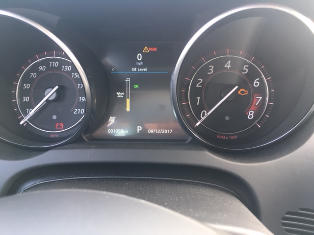

The car in question is a MY2016 base coupe. Up to the first service the oil indicator has always been at the top of the gauge. After the first service it was also at the top of the gauge but has been slowly dropping (first service was in October 2016). Sometime in April/may this year it started showing the oil level at half (and the green OK, see on photo down). Since then it hasn't moved and I check it almost every couple of days.
I read in the manual that this is perfectly fine and that no oil should be added. I just wanted to check what you guys think about it?

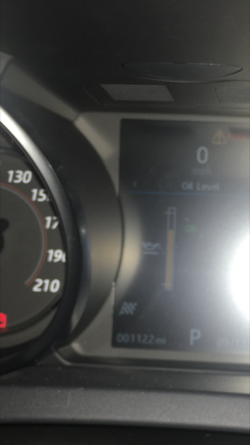

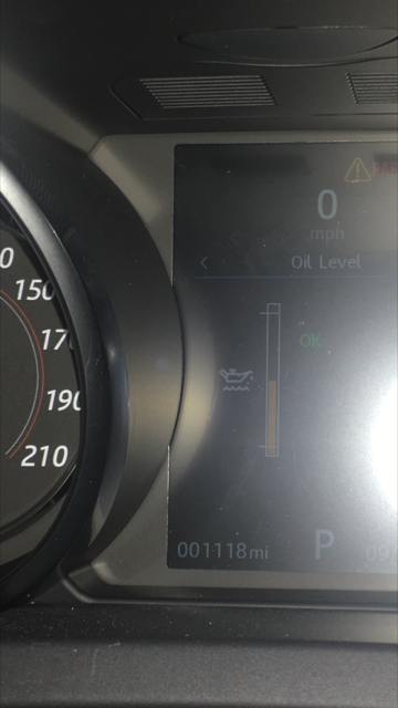

I've been OCD about my oil level as of late b/c of the thread here regarding oil starvation with the V8. I've found that the oil level can dramatically change from day to day, to even a few hours after checking. I took the first pic one day and the 2nd pic is the next day. The 3rd pic is an 1.5hrs after the 2nd pic.

I just went to recheck the oil level and it's still at the same level. First photo was 10 minutes after parking (after a spirited drive), checked it now, exactly an hour after the last check, and it's completely the same.
I'm guessing everything is fine, just the oil OCD (as you call it) kicking in a bit.

Normal driving - you will be fine. However, if you intend to go racing I'd top it off.
Also, as Kief mentioned level reading can be inconsistent. I try to take reading on a completely cold car in the morning while it sits on a flat ground.

Oil level between the two lines is perfectly fine for even spirited driving. As SinF suggests, top it of for the track where g-forces are more likely to expose the pick-up tube. Be careful though: you can only add about half a quart before it's overfilled.
