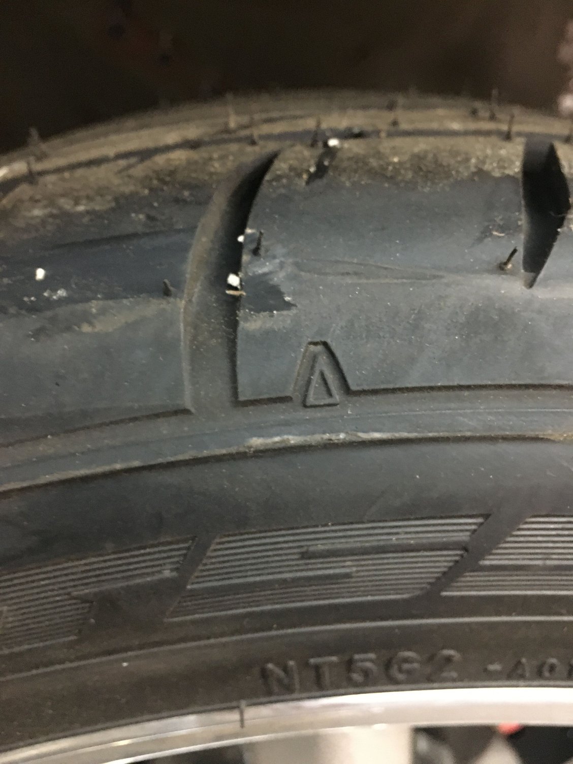

Read the triangles near the outside of the side wall and near the tread. When the wear from turning is at the tip of the triangle, you are at the optimum cornering pressure. Not touching the triangle - let air out. Too much wear on the triangle - add air. Some tires use a tiny logo instead of a triangle.
Triangle is in the recess

now thats a proper arrow!

I should have put my glasses on!
I can see the arrow now - I guess if I scrub the 'Fat man' then I'm a bit too low!
