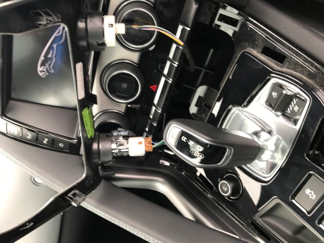

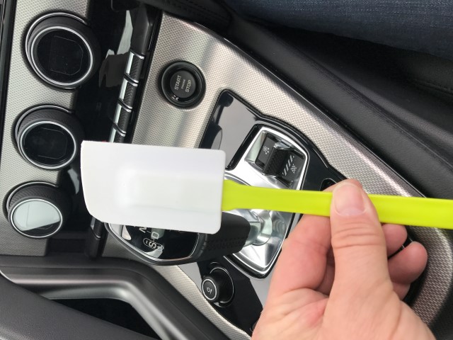

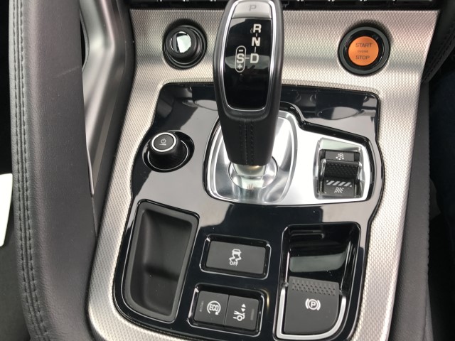

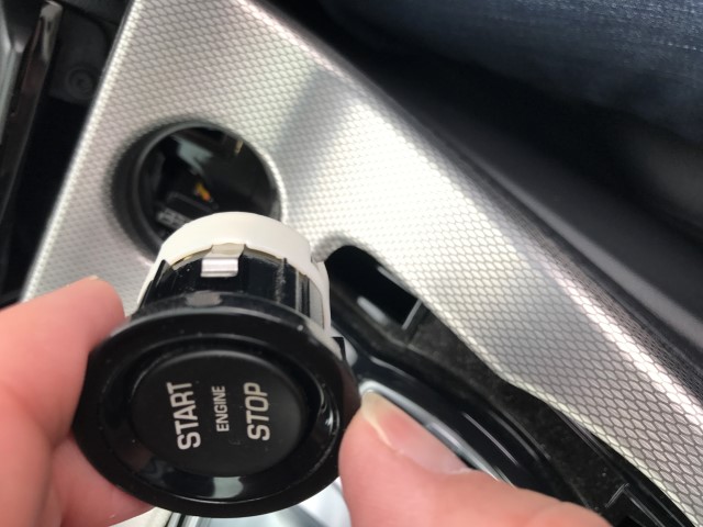

Step by step The button cost me £21.01 from the dealer. Nice job!

Not even necessary to remove the surround. I just rolled up a thin plastic business card, inserted it around the switch and pulled up. The switch popped right out.
