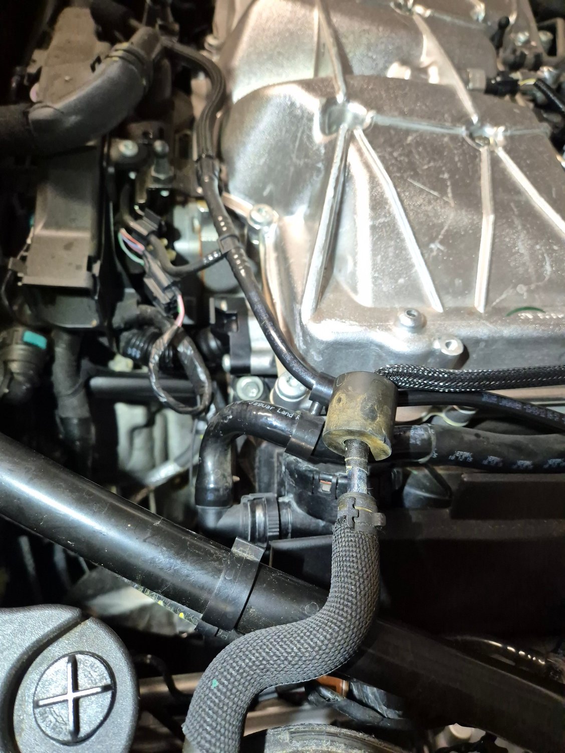

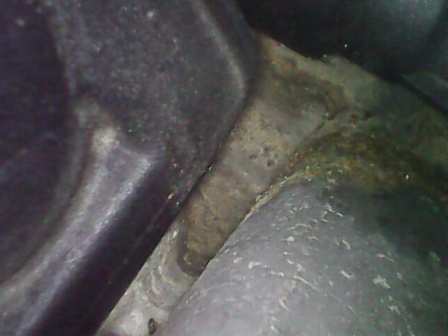

I have a slight coolant smell after drive from outside. I checked everything with my untrained eye, and only thing that looked "not like new" is this part that goes from the coolant tank. Can I kindly ask for the forum's wisdom? Thank you.
Car is 2016, 30k miles. Coolant slightly overfilled and I opened and closed the coolant cap at 5 clicks. Also the car is just after PPI and come back with 0 faults or warnings or defects from the mechanic.

Could be - but black light it in the dark like a crime scene - coolant has fluorescein. Scan everywhere especially the firewall, Please report back.

Check the plastic Y pipe. They will leak at some point.

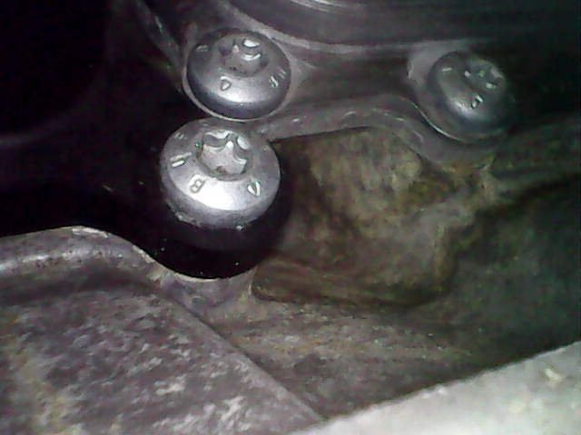

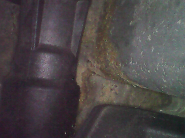

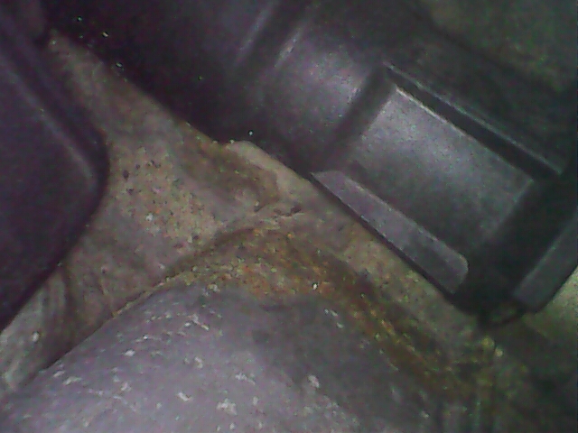

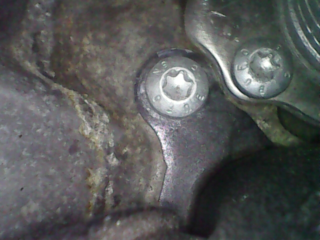

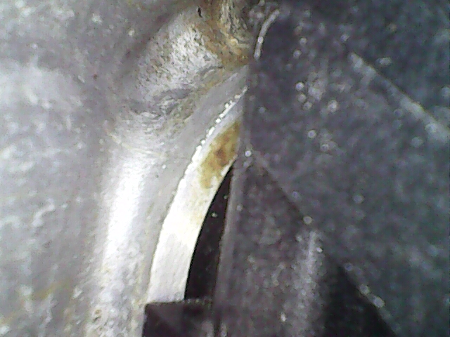

OK so I have checked the engine bay under UV light, in pitch black garage, with yellow gasses. Everything looked intact, including the overflow hose I asked about. I did not disassemble the bonnet and intake, so cannot report from the front. After 3 days when I opened the coolant cap it still "popped". Somewhere I red that you can put an endoscope down to the Y pipe, so I did that too. It is a bit tricky operation and I don't have a 360degree view of the situation, but I managed to take a few pictures (under normal light). Well, here I am not so confident...

@J444G Even without the UV light and just the endoscope light I see specks of fluorescence, and that suggests you DO have a coolant leak.
Next step is to do a pressure test, but even if it passed it is still worrisome unless this is from a prior repair where some coolant was spilled.
If you have the old style pipes it is time to upgrade to the aluminum pipes. There are many sad stories on the forum about overheating from failure of these original pipes leading to engine loss in just minutes.

I have ordered pipes and the pump, and I am interested how the endoscope photos will be interpreted.

@J444G You have inspired me to do mine too preemptively. I will also do some SC work (coupler and new fluid) while I am at it. Your endoscope shows dried coolant with flecks of fluorescein.

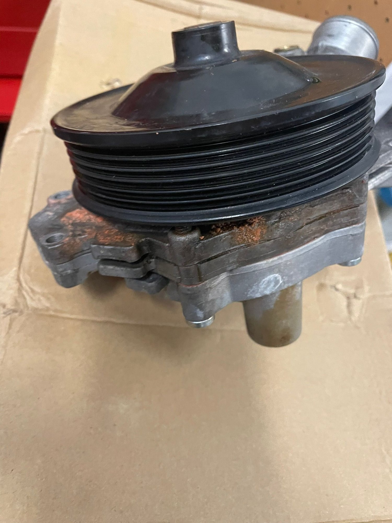

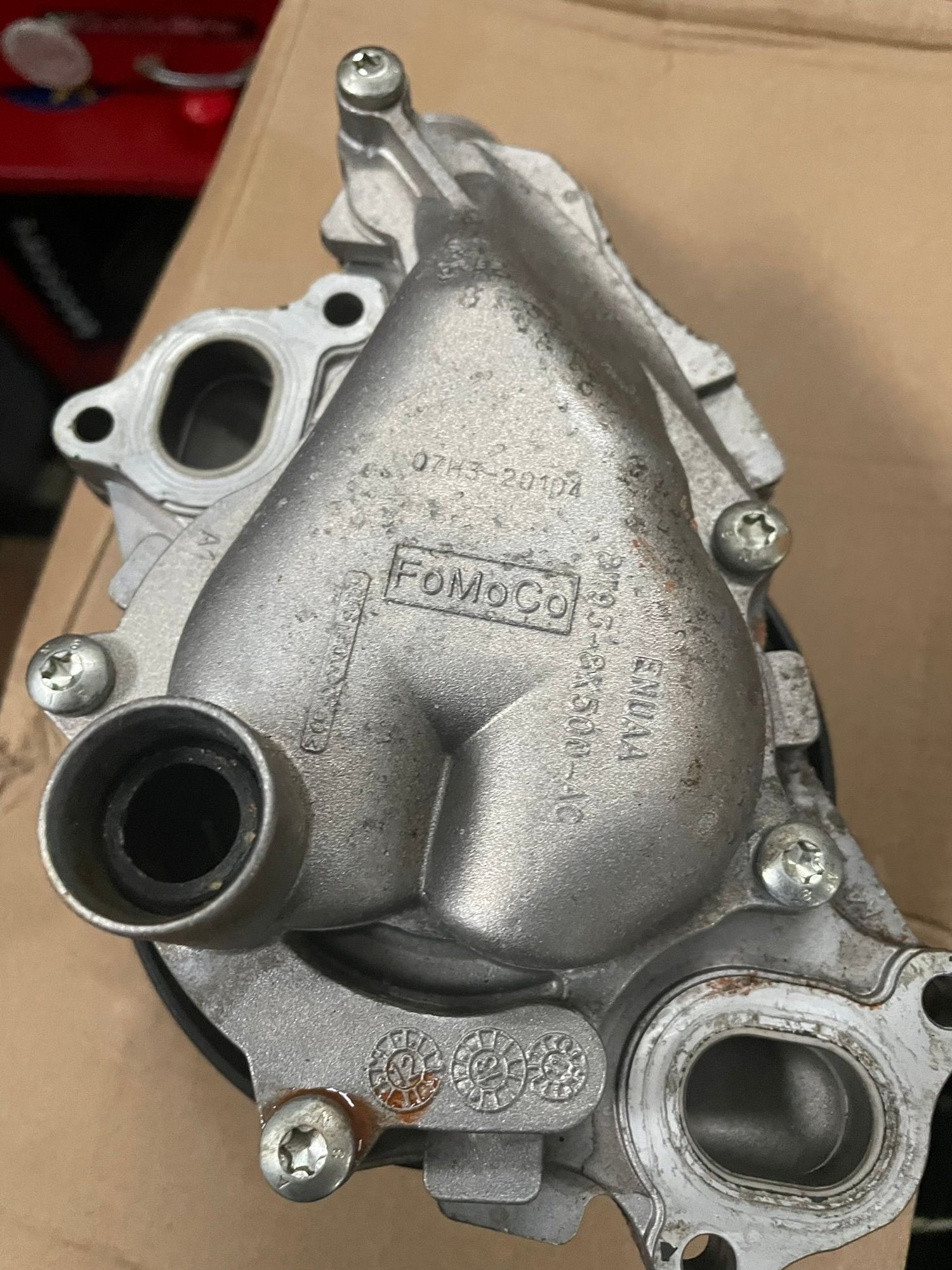

OK so we have dismantled the parts and by naked eye everything looks like new. Y pipe, cross pipe, heater pipe, pump, oil cooler pipe, overflow hose, throttle body hose. The oxidation on the block is probably from standing water and/or moisture from the SC foam which I will not put back, because it is everywhere under the SC.
I did not check the thermostat yet. Only one suspicious thing was o-ring on oil cooler pipe, that is quite hard and a bit squeezed on one side.

@J444G Keep up the great detective work - that could definitely be the source of the fluorescein flecks you saw via endoscope a while back.
