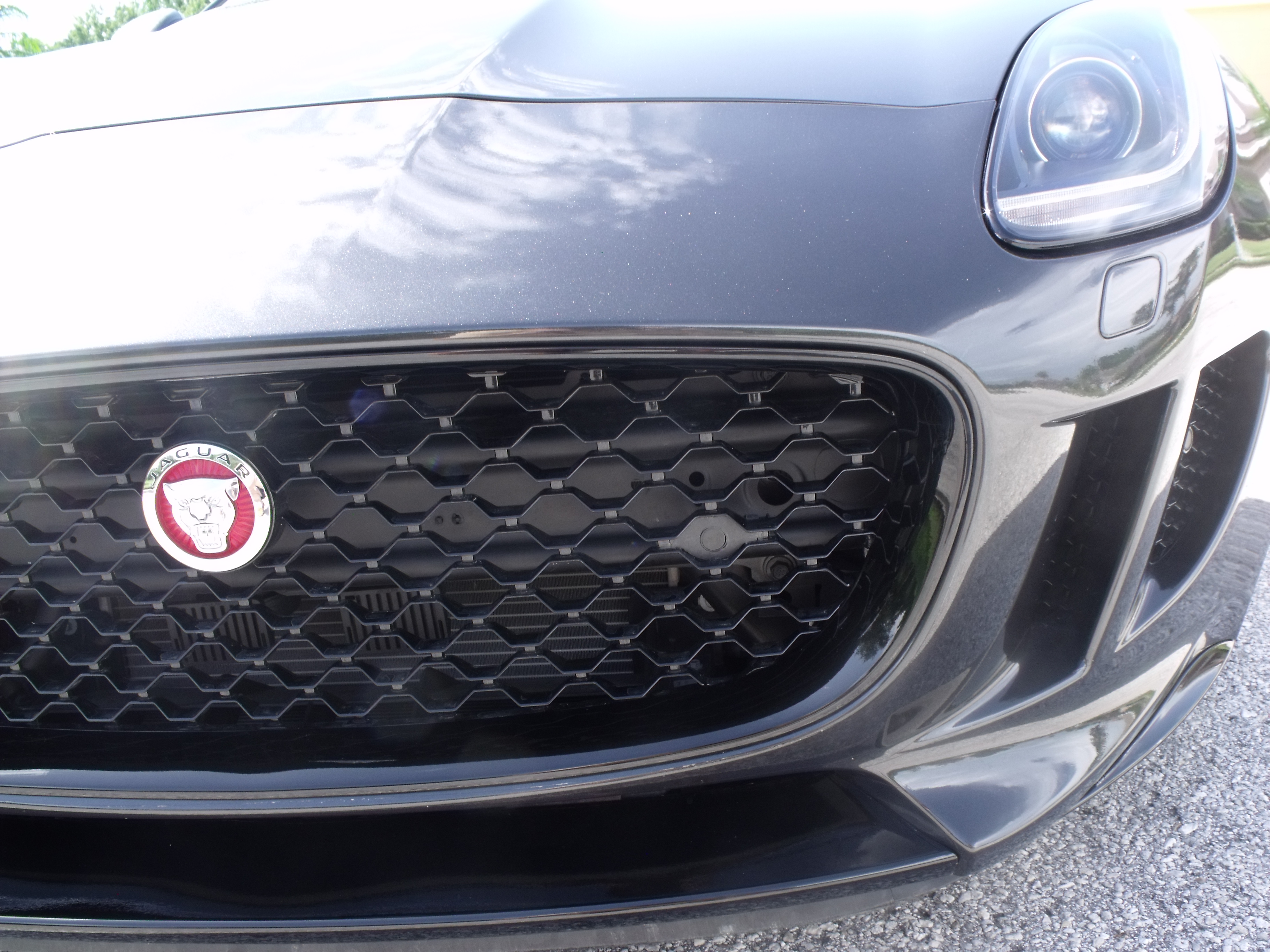

Not sure I agree. From this photo provided in the original post, the wires cannot be seen, yet the bumper bar behind the grille is readily visible, certainly from up close, thus I suspect that camouflaging the entire wire harness - which isn't made to be pretty - will become more of a challenge.
