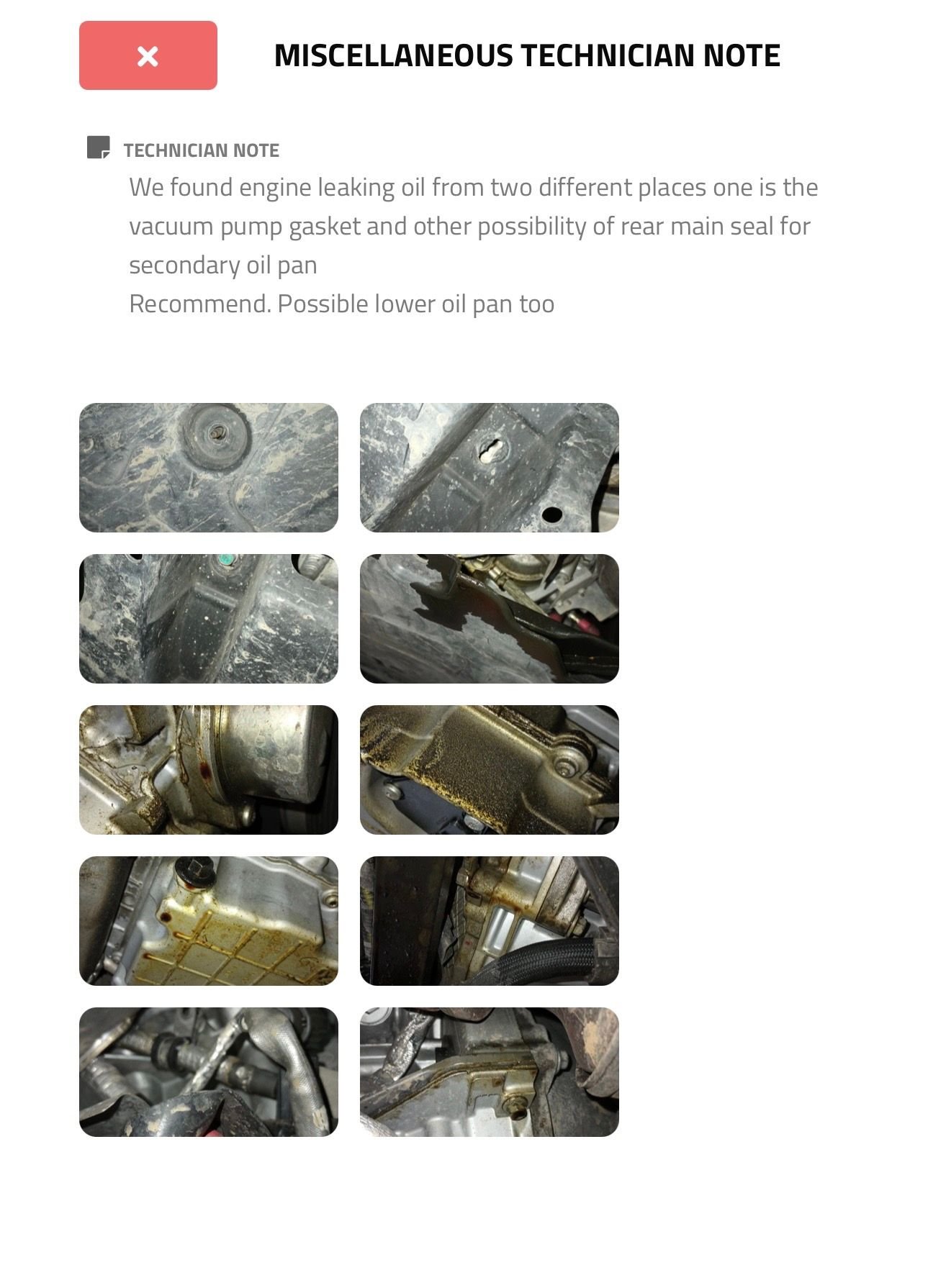

I just pulled an invoice from my local indy shop because I remembered they replaced the vacuum pump with a new one at the end of June 2025 (less than 6 months ago).
The plot thickens. I'll let you know the outcome, probably many months from now.

Dec 19, 2025 | 09:18 AM
I had taken it in to the shop for some noise from the rear tires while driving. There’s another thread started by me on that one back in June. While it was in the shop, they found oil leaks, one near the vacuum pump gasket (see attachment), so I had that repaired.
They said while they’re in there, they might as well replace the vacuum pump. They ordered an aftermarket one from their normal parts supplier, Worldpac.
Going forward, I’ll lean toward replacing with an OEM part, even if it’s more expensive, unless the design of the OEM part is already identified as a weak point (e.g. plastic coolant pipes).
