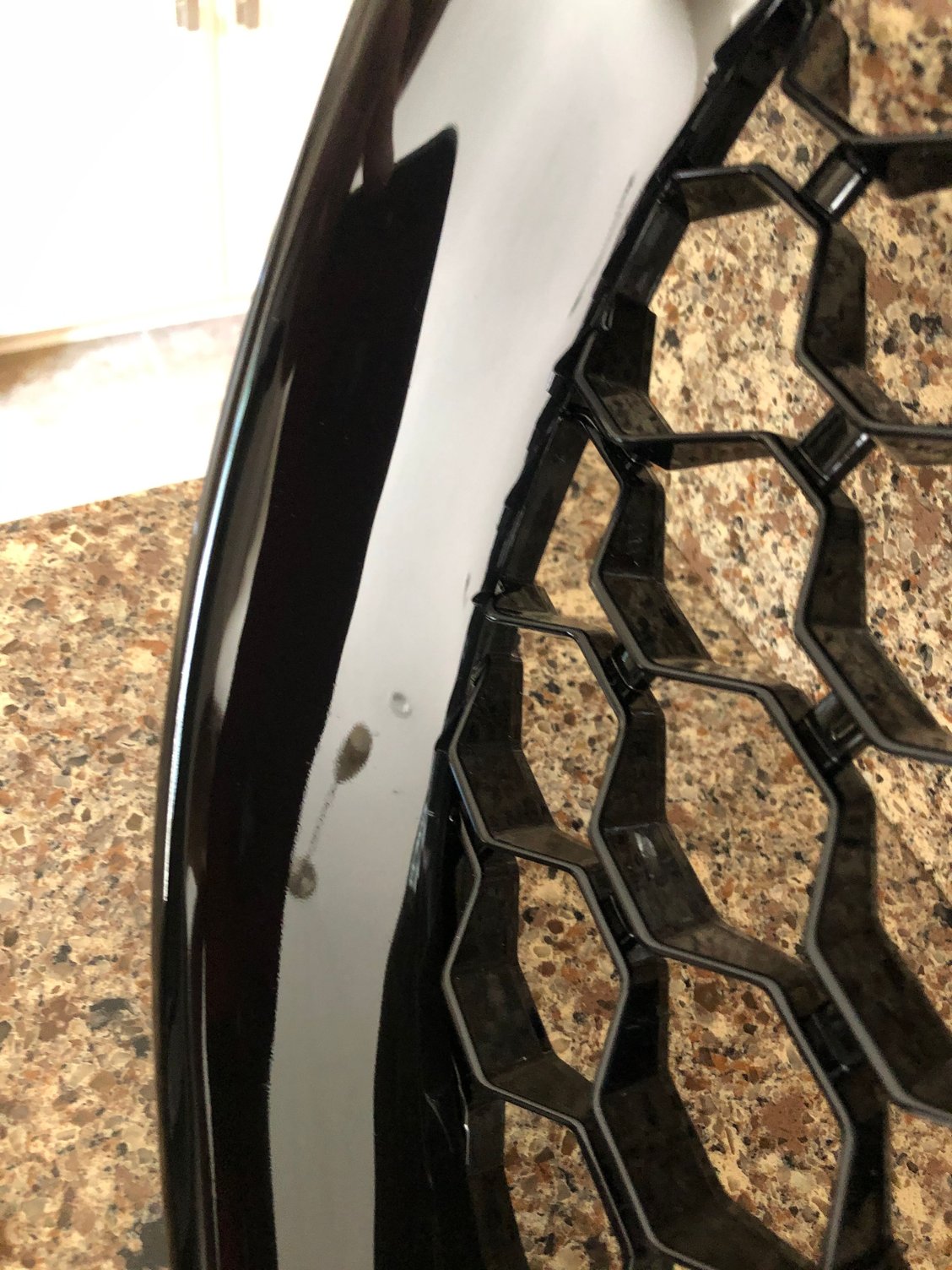

Good call, I started with a wrap and took it off before I finished trimming. I went with automotive paint and 2k clear (my original choice)- I worked in various areas of automotive including body work and have a full complement of sprayers but I opted for a good quality rattle can paint and clear. Of course, color sanded and wet sanded the clear and polished to a high shine. Looks amazing and cost less than $50 and I like knowing I have the right stuff for touch up and polishing plus, the sanding in between 6 coats of color and 5 coats of clear left is smooth as glass and a good match to the factory black pack.
