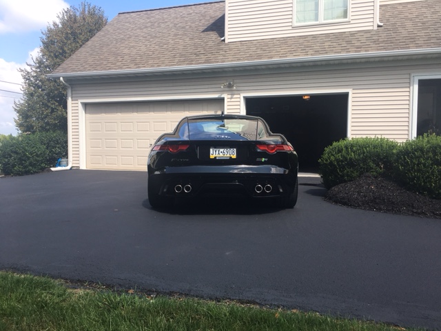

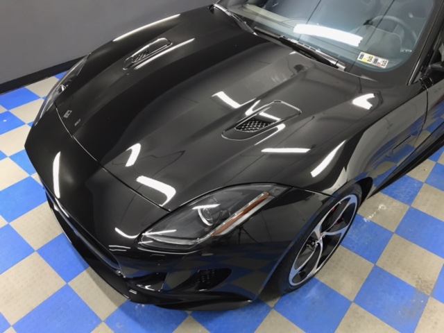

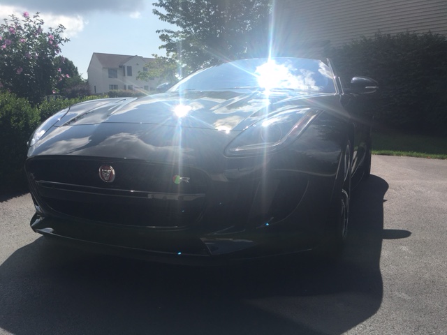

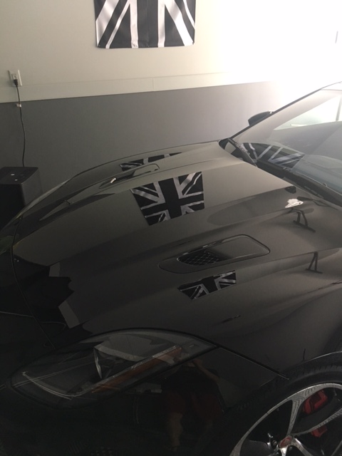

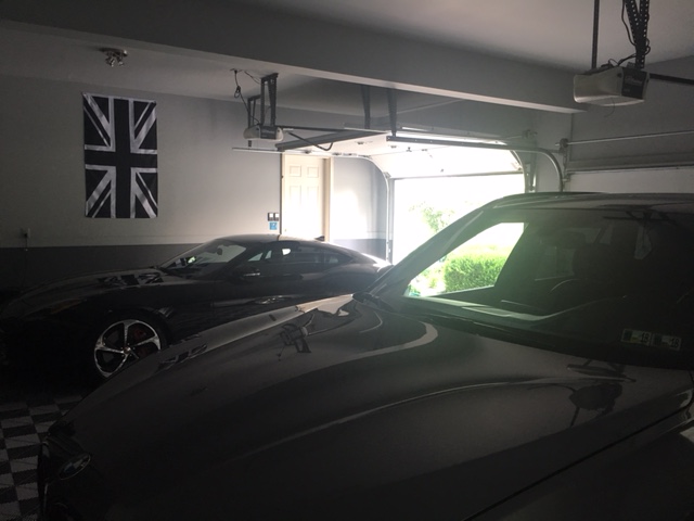

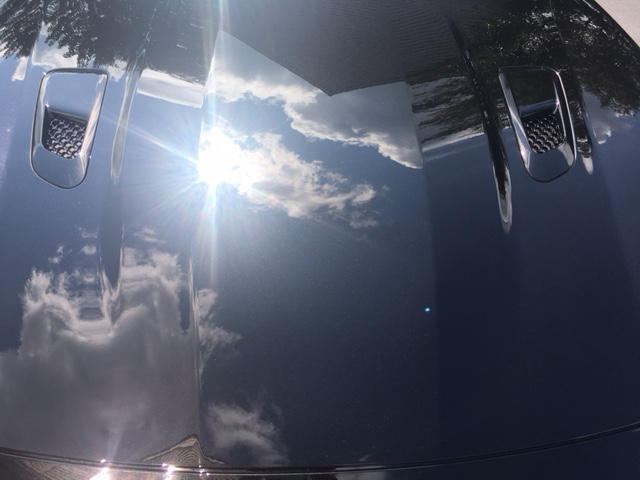

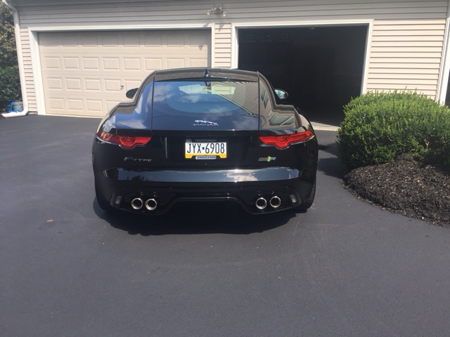

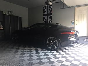

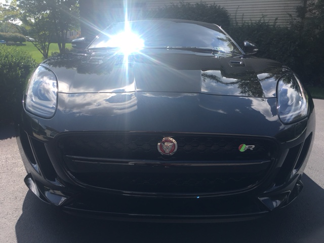

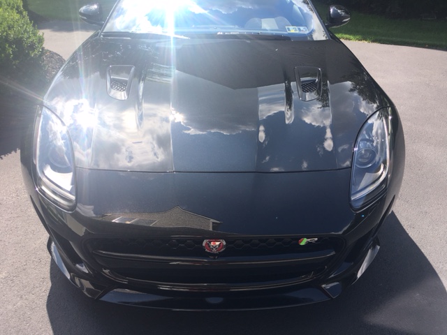

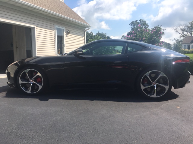

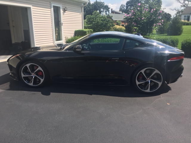

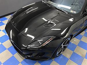

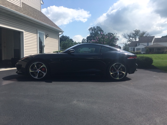

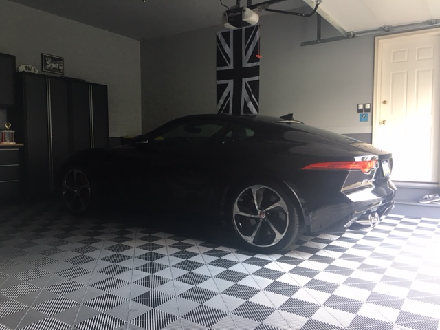

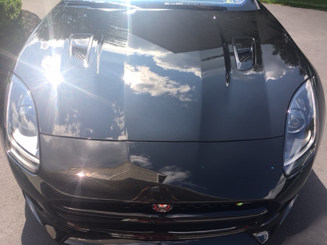

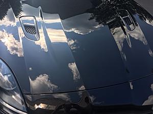

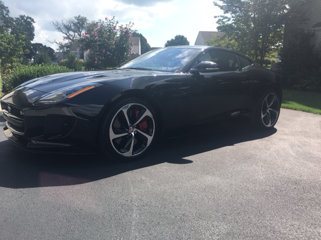

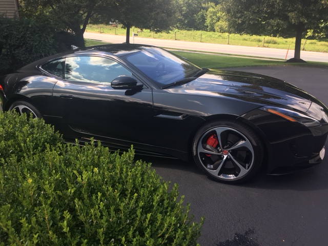

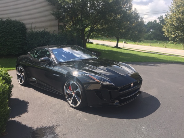

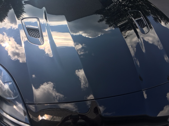

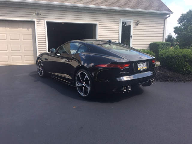

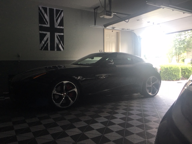

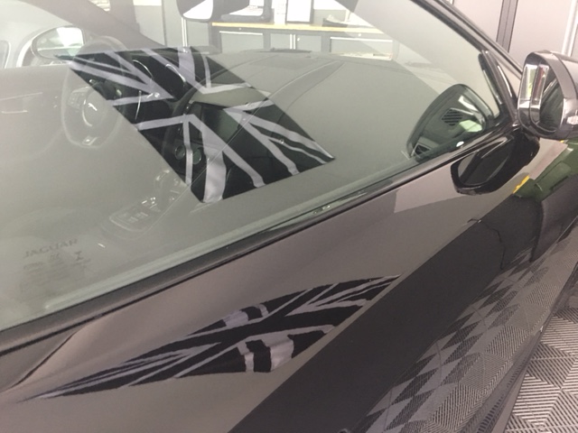

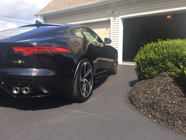

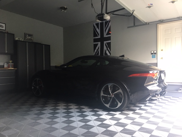

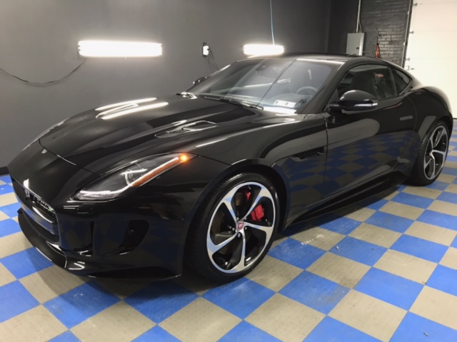

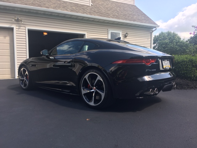

Just returned from having my R's entire exterior paint professionally corrected from the n/c dealer-installed swirl marks. My guy spent 3 days on the car. He then added two layers of coating for added resistance against future marring. The finish is now brilliant! Sorry for the low quality iPhone pics.
Question for others who have had these paint coatings/nano-glass ceramic coatings applied with regards to aftercare washing and drying. My guy recommended a foam cannon and power washer, but I wash my cars in the early morning, to best avoid the sun angle in relation to my driveway, and I worry about the noise created by a power washer-albeit an electric one. BTW, the car is loud enough at that hour LOL! I also like to use hot water when washing my cars. If I just do my typical two-bucket method and spot dry afterwards, do you guys think this would be just as good at avoiding swirling up the paint?

Damn that's clean!

Looks great Ryan. I've been thinking about getting a foam cannon, power washer, and leaf blower. Helps for winter washes too. Touchless obviously prevents new swirls, but with multiple coats of ceramic, you should have plenty of protection.

Damn, that looks awesome!!
