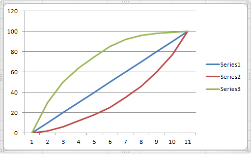

I whipped up this quick chart to better demonstrate what I was talking about:
I didn't label my axes, but the the horizontal axis is pedal travel and the vertical is what's called "requested torque" in some software I've worked with. It's what you're asking for, in any case.
With a linear mapping (blue line), you get 50% when the pedal is halfway down. With the red line, you don't get 50% until the pedal is about 80%. The green line gives you 50% with only 30% of pedal travel.
The mapping for the green line makes the car accelerate more quickly with less pedal. That can make it *feel* like you've got more power but you don't. Notice also that the last 20% of the pedal travel makes almost no difference. Zero is always zero and 100 is always 100.

Altering the pedal mapping can change the driving experience. My car actually has a built-in setting to do just that. As a matter of preference, I like one setting more than the other and never change it. Neither one makes the car faster, but there is a "noticeable difference."
A tune's benefit can be measured on a dyno. The pedal response remapping has proponents, but the main benefit seems to be subjective. There's nothing they can do that can't be replicated by moving one's foot differently. That said, some people like the change.
As I noted in post #2 of this thread, discussion on the topic can get contentious.
