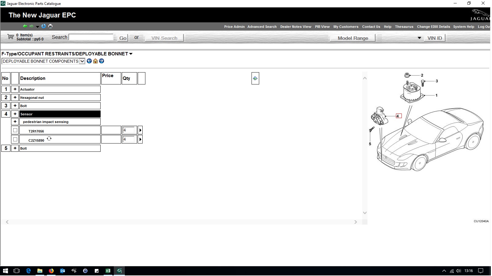

Checking JEPC for the F-Type PPS components, I see they are identical to my XK.
The Impact Sensors (item 4) behind the front bumper are prone to failure and trigger a warning message. I had one fail on my last XK. Because the associated DTC's are extended error codes, it requires Jaguar SDD (Symptom Driven Diagnostics) or equivalent to read them.

I took the whole unit off, 1 on the diagram, and just put a cancellation thing on it, it's been about a year and a half no issues
