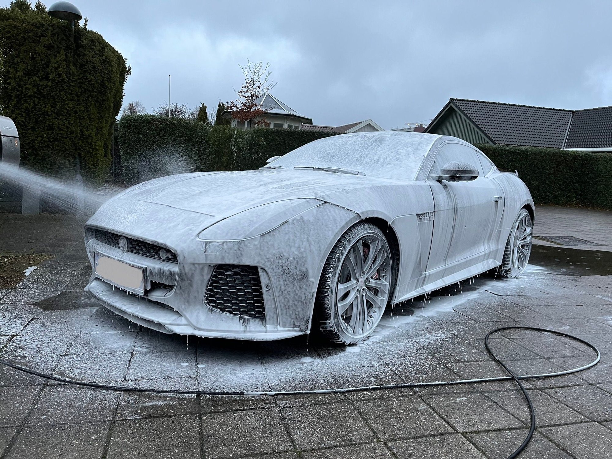

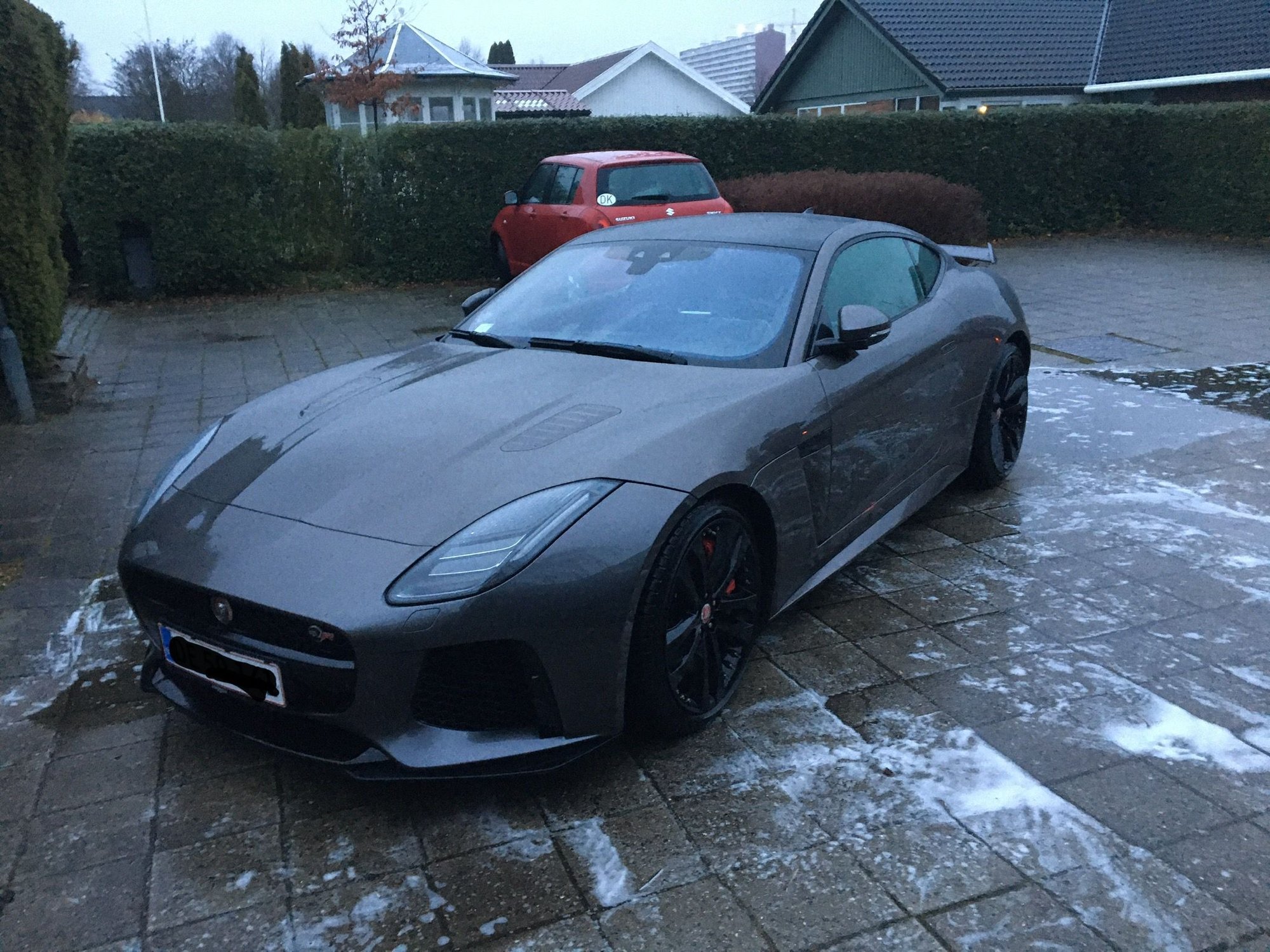

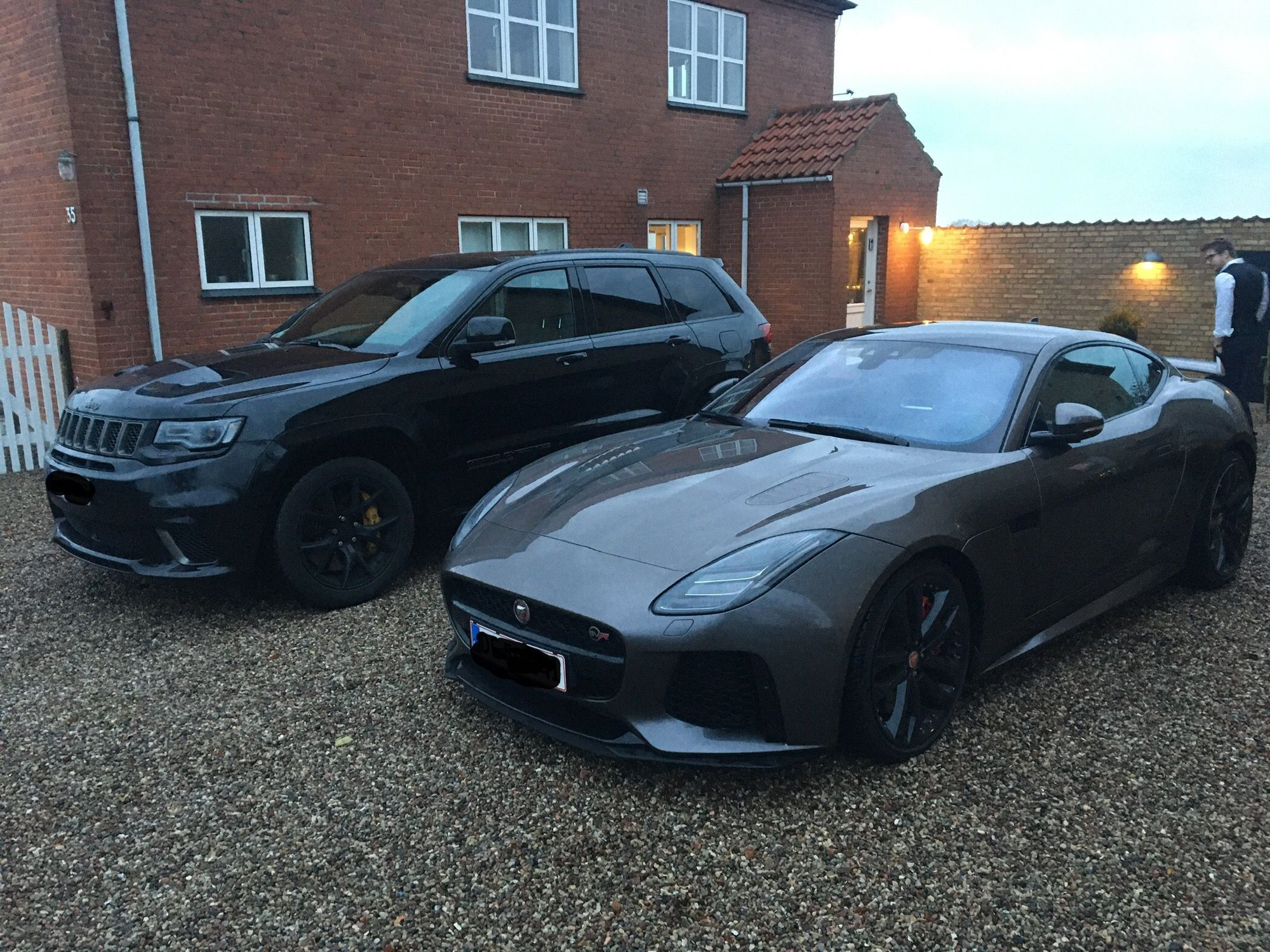

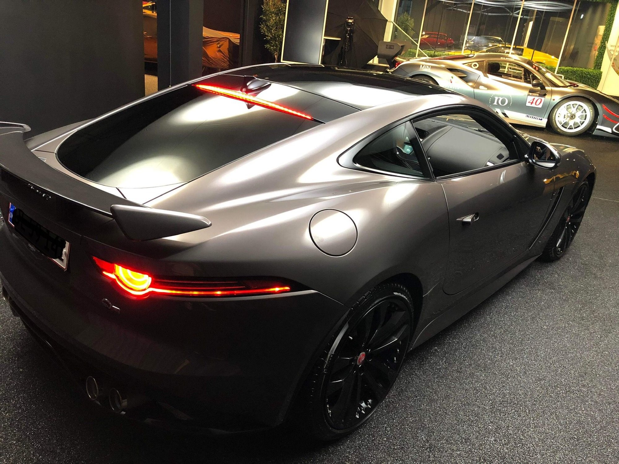

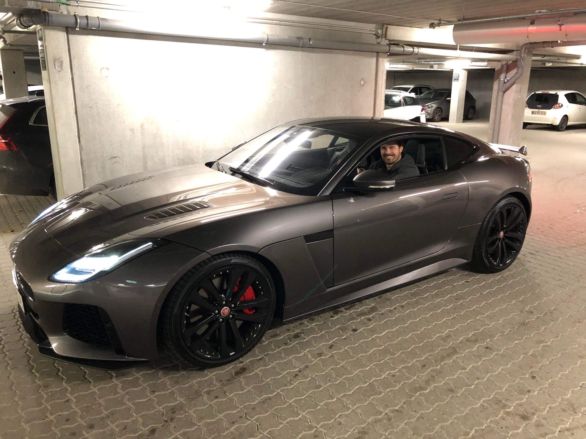

Finally got around to upload some images for you guys!
Here’s a few from when I picked it up. One with my brothers Trackhawk. One with me and my big smile! And one after the first hand wash (Ofcouse it started to rain just as I was finishing up)..

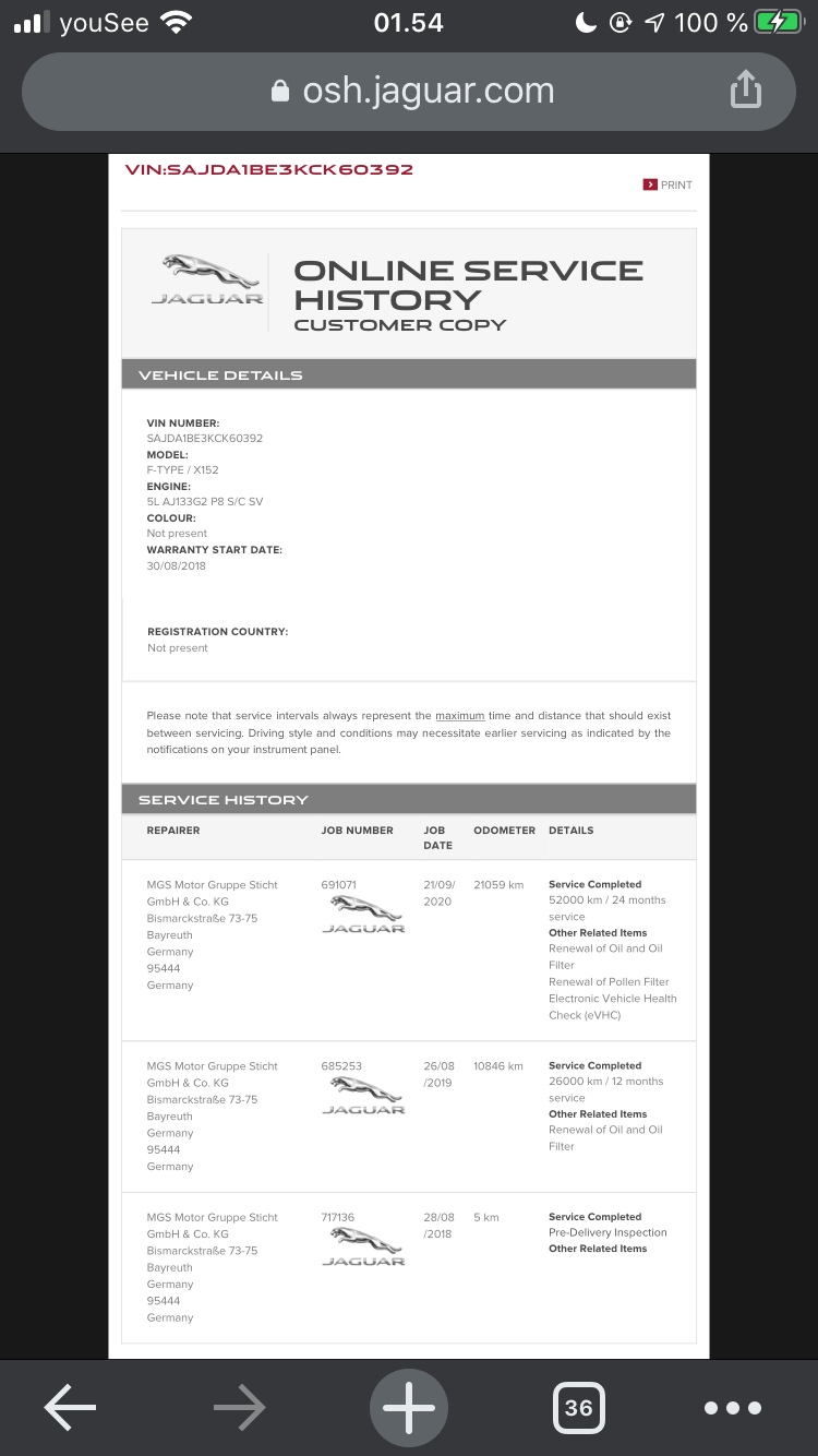

In the UK we can go to https://osh.jaguar.com, type in our VIN and download service sheets specific to the vehicle. Not sure if it'll work for you but worth a try. Regarding the "service due" message, it could be the date that's triggering it - when was the 21,00 km service done?

@scm & @Ftyperegistry it worked! I was able to pull up the data.
Now the Jaguar mechanic I talked with wanted to change the oil filter, the pollen filter, 2 air filters and then add about 10liter of new oil.
looking at the records it looks like the pollen filters were replace at the last service (24 month service) and this service that’s due is the 36 month service.
i’m unsure if thats needs replacement then?
as you know I only just got my f-type so i’m rather green in this world, and truly appreciate your insights 👌🏼

I reckon that mechanic is looking to rip you off!
The pollen filter is due for replacement every two years and as it was replaced a bit over one year ago it is not due yet.
Even then replacement every two years is IMHO overkill unless you constantly drive in very dusty/dirty conditions.
It's also a simple five minute job to do it yourself and a new pollen filter is easily and cheaply available on Fleabay etc.
Yes, the oil and oil filter are due for replacement as it is now over 12 months since they were last replaced.
But not 10 litres of oil, your car takes 6.5 litres!
The engine air filters are due for replacement every four years or 104,000 km whichever comes first and therefore they are nowhere near due for replacement on your car. They also cost a fair bit (but again much cheaper on Fleabay or from Rock Auto) and they are a labour intensive job to replace (therefore expensive), which you can DIY if you are at all handy with the spanners.
Last but not least the one thing the mechanic has missed is renewal of the transfer case oil which is due every three years or 78,000 km whichever comes first.
You probably don't really need it done just yet but it's best if you get it done to preserve the warranty just in case something goes wrong in the drivetrain.
Edit - Maintenance Schedule attached. It's for the 2016 model year and yours is a 2019 but I don't think there were any changes and I have never seen or heard of a later version:

@OzXFR Thanks for your 2 cents! That maintenance checklist are golden, I've reached out to the mechanic and send him the lists and overview.
Appreciate your insights!
