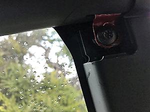

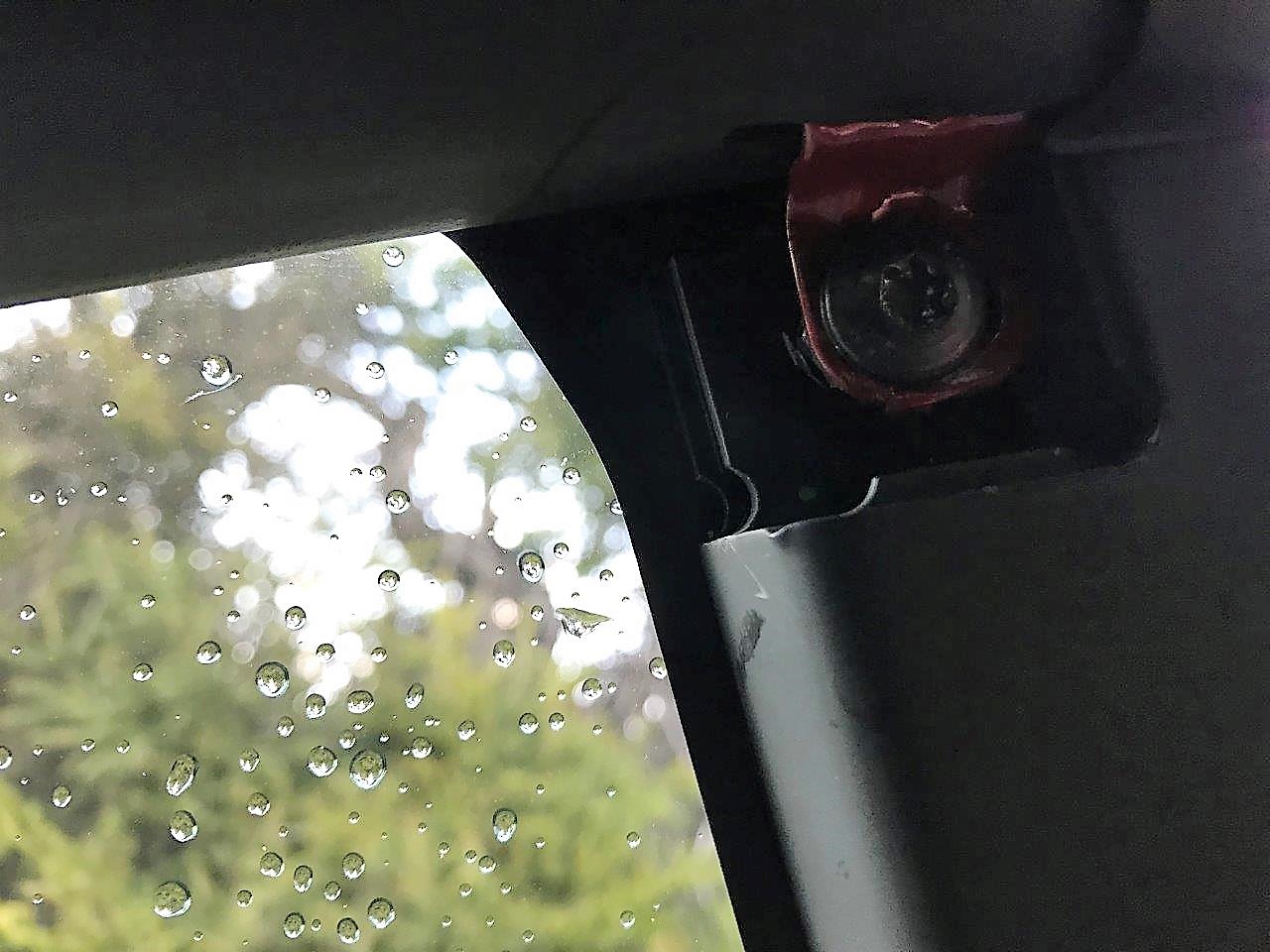

Hi guys,
Yesterday I got a 2015 IRR Coupe R, and it's great - except for what I consider excessive wind noise behind the driver seat when going in higher speeds.
I took a closer look and saw that a piece of plastic trim - like a plastic cover of sorts - is missing over a screw in the B pillar, and it looks like the screw has been tampered with. It also looks like the interior trim over the B pillar isn't perfectly fitted. See attached pictures for illustration.
So questions popping up in my mind are:
- Can replacing the plastic cover get rid of the wind noise?
- Can there be something else not refitted the right way creating the sound isolation problem, if there was work done there previously?
- Why would you be unscrewing that bolt to begin with? Should I be worried that there's some other problem that I haven't discovered?
Thanks a lot!
/Jonas

Anyone ever find the part number for this thing? Mine is loose and at high RPM (over 6k) makes noise.... Notice it a bit on fun drives...to much....want to just get a new one, driver's side.
Thanks!!
jeff
Old Jun 25, 2023 | 07:41 PM
jcb-memphis's Avatar
Joined: Oct 2021
Posts: 673
Likes: 334
From: Seattle
Well, went out to the car, pulled it off, found a weird number on it (photo on phone).
Put that weird number into a jaguar parts search - nothing.
Into Google. One site in Poland had it the information and in the mix I found the number in JLR terms....it is simple and cheap:
T2R11564
Done.
FYI to anyone looking for the same part.
JB

I had my shade crap out and the whole headliner needs to come out to replace that shade To do that, the side window has to come out so the headliner can come out in one piece. That cover has to come off. I remember mine flew off after the repair with the windows down. The dealership ordered a new one, so they should be able to locate the part number. I think that screw may be the one that holds in the wing window. The window slide in from front to back, then I think that screw secures it, possibly.

thanks for the part number. I recently had my headliner replaced, and the quarter glass removed to get the old headliner out and the new one in. This little trim piece was a casualty of that process, so I’m looking to get a replacement.
To the OP, it sounds like your car may have had the quarter glass replaced, or at least uninstalled and reinstalled, possibly to replace the headliner, like mine. If the quarter glass isn’t reinstalled properly and adjusted correctly, it can leave a gap that allows air to enter between the door glass and quarter light at speed, which might explain the wind noise. I ended up reinstalling my quarter glass myself to correct this since the guy who did my headliner was a bit sloppy.
