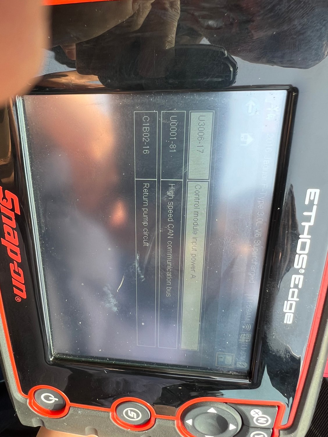

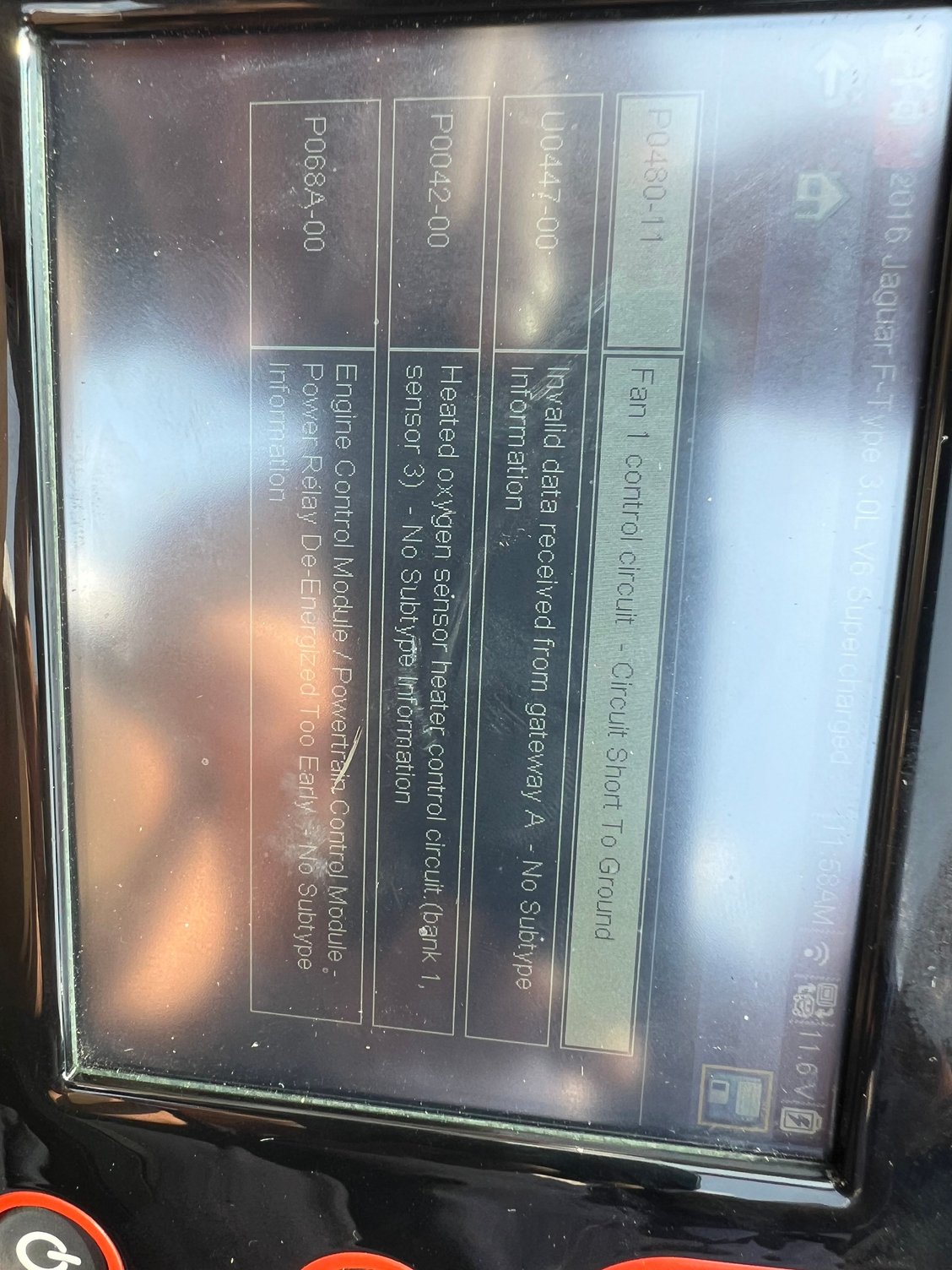

Hello jaguar family, we have a check engine light and the roof won’t retract
Any help would be greatly appreciated

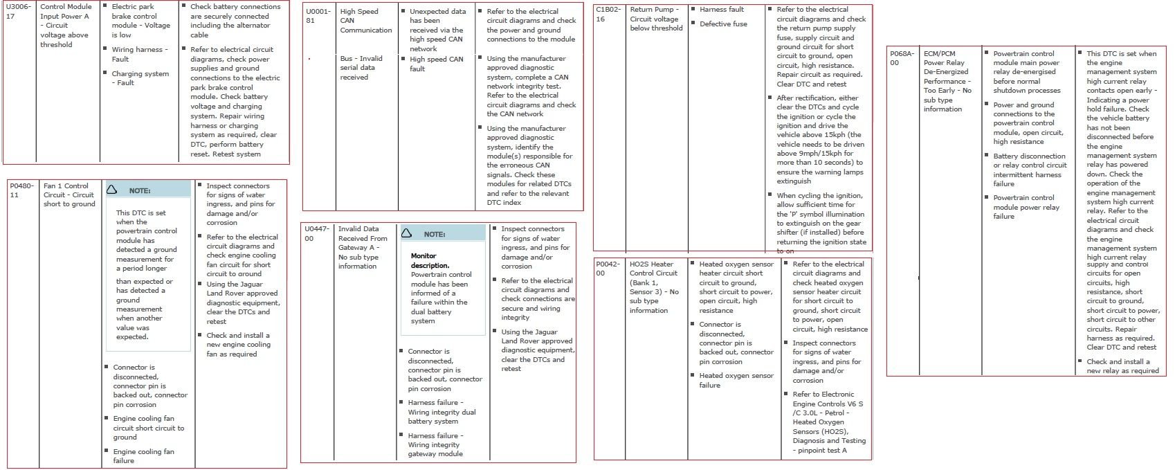

These are all very random codes. As other mentioned, I would check the battery condition. My theory is that a low voltage situation is causing incorrect readings from the ABS module (which, btw is tied to the module that controls the softtop) as a result, not closing. Those incorrect reading are then freaking out the ECM. I would definitely start with a healthy battery, clear the codes, and see if it comes back.
