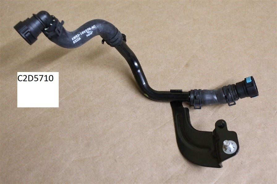

Here is the factory version;
Note that terrible bracket and captive bolt. That bolt is a real bear to get in and out. Jaguar eliminated that entire metal bracket in the later cars (2018+ I think?) BUT never went back and updated any of the older cars that used this part. I did this to my 2014 XJR and it's a nice improvement. I did trim the hose length about 1 inch to make it fit better but that was just me. It fits without doing anything.
Here is the replacement hose. Shorter, no bracket and WAY cheaper to boot! Note the factory plastic bleed port!
I still owe thanks to whoever posted this. His mechanic mentioned it to him and that shop now replaces every rear heater hose with this better version.

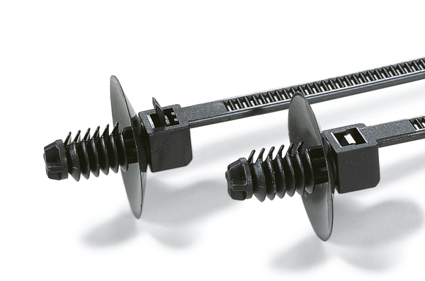

-anyone know the part number for the small clips that hold the harness to the heater pipe? they sort of look like this:

I used some general clips from scamazon that had Christmas tree tabs.
