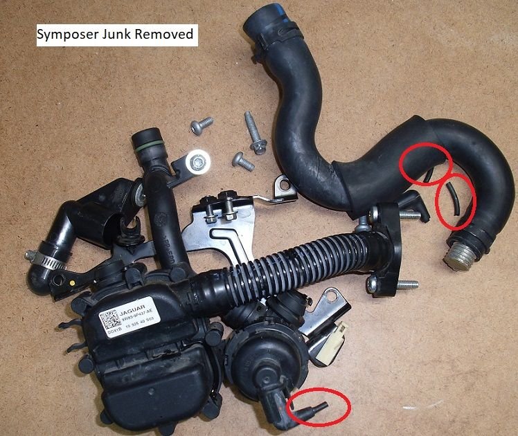

When I removed the symposer that small vacuum line was very brittle and just fell apart in multiple places. Bits also fell down behind the engine so these are just the chunks that I got out.
I don't know if Jaguar still has any of these parts anymore. Might need to round up a rubber vacuum line. The OEM is a hard plastic line that did not age well in service.
No I don't have any of this anymore. I was very happy to throw away anything that had to do with the Symposer!

Had I know parts of the symposer would break, I probably would have ordered a delete kit.

I think VAP has a symposer delete plate?

You can purchase the delete kit here in the US.

Just need a plate, drill holes for mounting, then some RTV for a good seal.

-do a symposer delete. It will make reassembly and further disassembly so much easier. I wish I'd done it.
