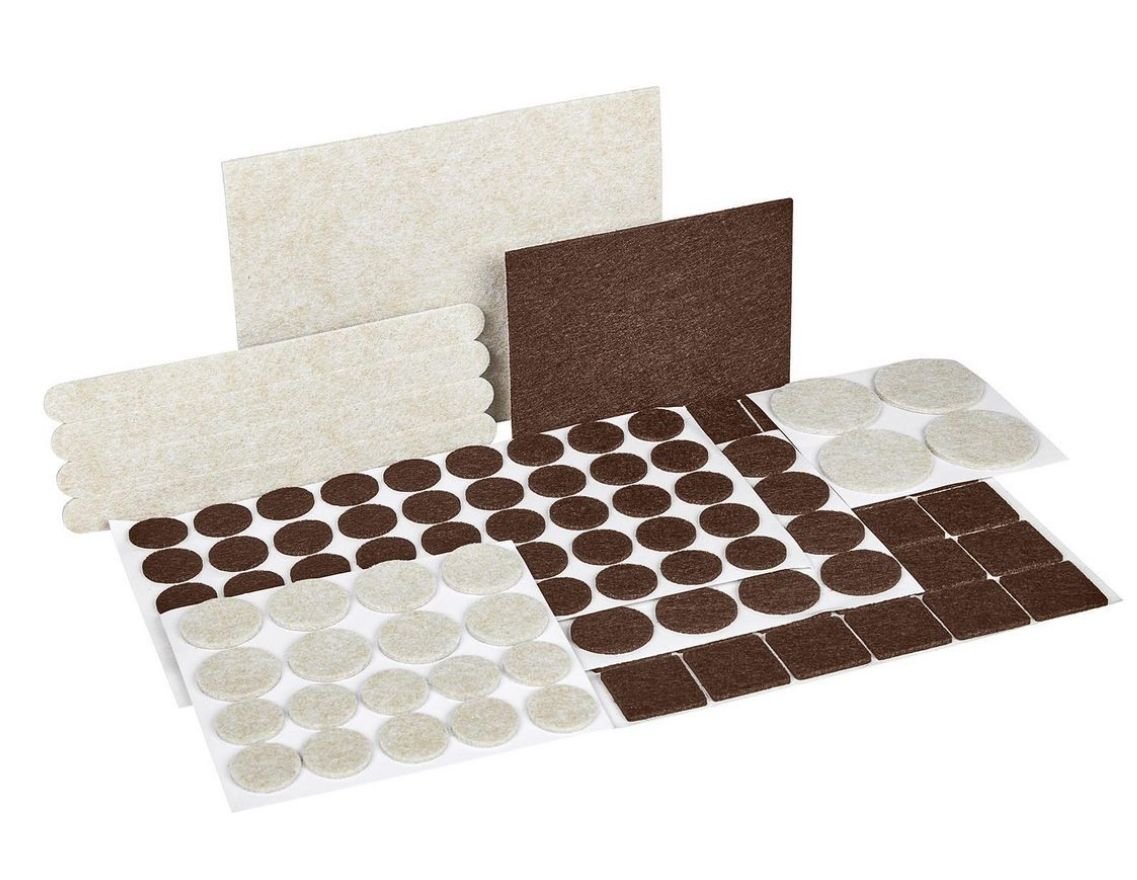

Yep, I had a box of thin pads (I think for furniture feet) that have adhesive on one side and padding on the other. Guessing maybe 1/8" thick, maybe a little more - cut a small square and placed it in a way so it stops the pedal from triggering the switch - 100% throttle is still reached but no more kickdown. Works perfectly.

I'm avoiding foam or padding as I like to have a hard stop at the end of pedal travel, but knowing that your pads worked gives me lots of confidence Thanks again!

I have plenty of extras, I could cut them up and mail them to everyone, I think I could supply a solution to most F-Type owners on this forum lol. Works pretty well so far - these are furniture pads so they don't compress easily, but will absorb any shock. Let us know how the 3d printing solution goes.
