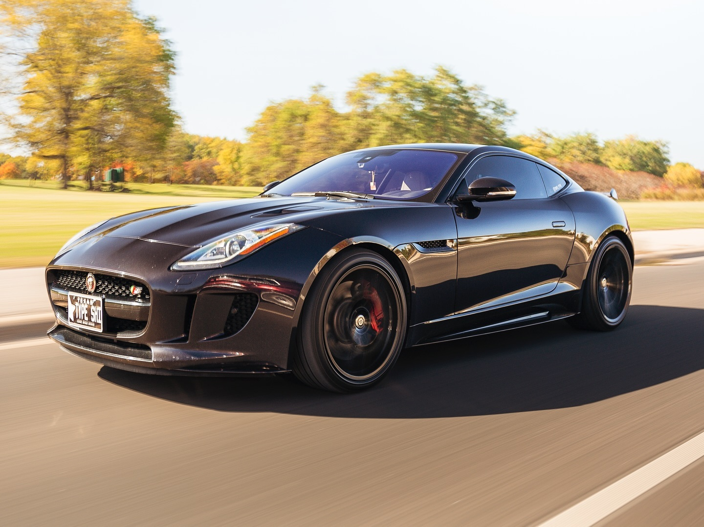

(the car in question)

Blackberry is a nice color, imo. Nice to have that under the wrap.

I would ask if there are also OEM wheels. Also the car looks lowered but maybe it is just that the wheels have less offset.
I did, he no longer has them - was planning to use them for winter tires, but ended up storing the car in the winter and so sold them (will confirm @ inspection, but yay if so!). I'd like to swap these for some 19" at some point, but it's not a buying decision.

From the reflections in front looks like has has hit several curbs,

The tires are newish, but all-seasons. He says he had some bodywork done on the front bumper to fix some stone chips etc before getting it wrapped.
Some say there's no such thing as a bad product, only a bad price. If the price is right and there's nothing major wrong with it, then I'll likely be picking it up.
FYI this is a kinda shaky photo of the car pre-wrap. I can see some stone chips on the front, but that's about it. I appreciate your concern, Tomkatb!

I also do not like the picture and wrap thing.
must be a deal.
there are a lot of low milage garage queens out there.
Holes for mounting the license plate?

Honestly, I'm not a super fan of it being wrapped, but the colour is interesting and I would probably keep it on for at least a year or two before getting it stripped. The price is about average, but I'm not going to offer what he's asking, based on what I've already seen and what's missing, etc. Not sure what you're asking about the plate holes, but it does include a front mount for the plate, since they're mandatory in Ontario.
