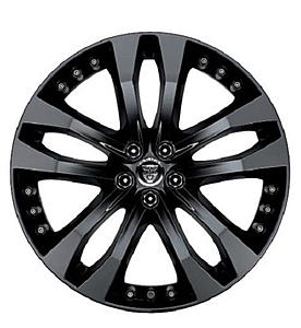

If I want this paint .. what do i tell them ? Satin black or Gloss Black ?
Any shop will have samples of all their colors. I may have said it in another thread, but consider a dark gray metallic finish as opposed to gloss black. I think it makes the wheels stand out better. Otherwise they disappear in low light.

Just request the lower heat treatment. Almost all shops will comply.
As for the pic above it comes down to whether or not you have the black pack. In that case the hood inserts and door trim, etc, are gloss black.
Gloss black wheels are a better match than Satin.
