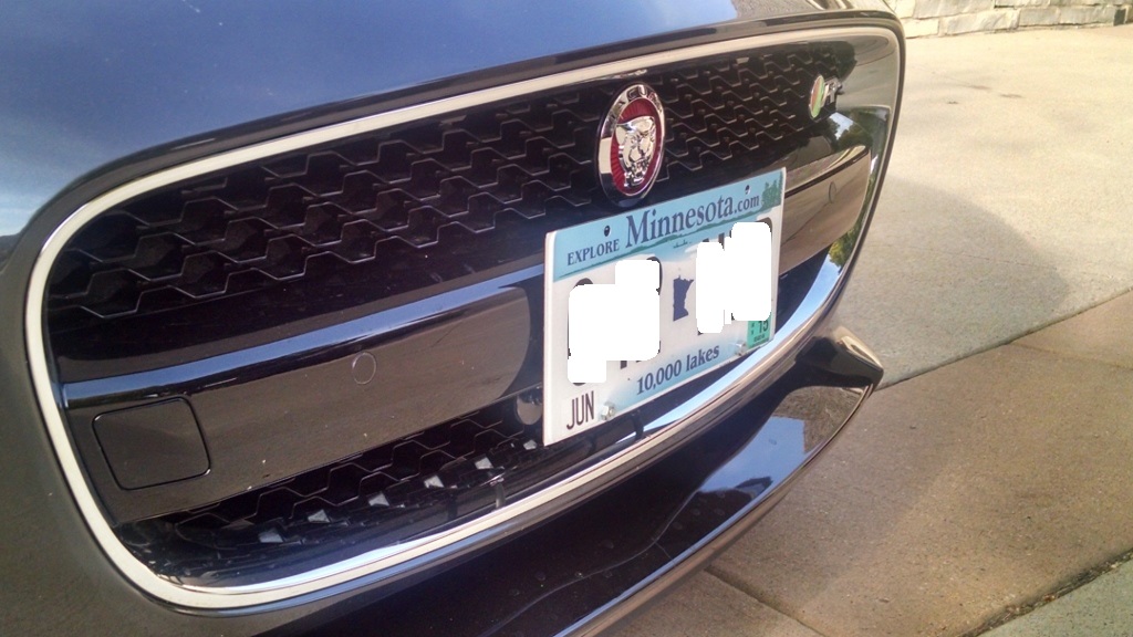

As seen in the attached photos the plate ‘floats’ about ¼ in in front of the grille bar.

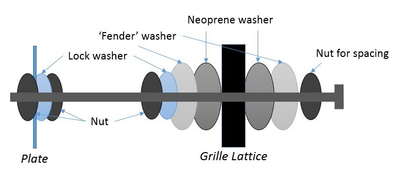

One pic shows the 2 carriage bolt assemblies connecting through the grille lattice. The grille lattice allowed me to line up the bolts in a very good spot. The fender washers and neoprene washers I used to protect the lattice also allows you to precisely position the bolts and eliminates any vibration. But I have only tested that up to 95 mph thus far. I won't be mounting my GoPro on the car to check but I’m sure at highway speeds the license plate bends back against the grille bar, so I put two of those little rubber bumpers you use on cabinet doors on the plate of the plate. Although I saw no chaffing without doing this.
I used my tin snips to remove the ¼ of the edge on the top and bottom of the plate that would be covered by a plate holder to give it more of a longer ‘euro’ look. Well, not so much, so I may snip the sides (seen in the photo) and make it that much smaller. (US plates start ugly and nothing you can do to dress this up.) I used a black sharpie pen on the raw plate edges to help black it out. Most states plates have a stamped framing around the plate at this ¼ inch dimension so it is really easy to snip it along that line. Obviously you can skip the snipping and just have the bigger plate profile.

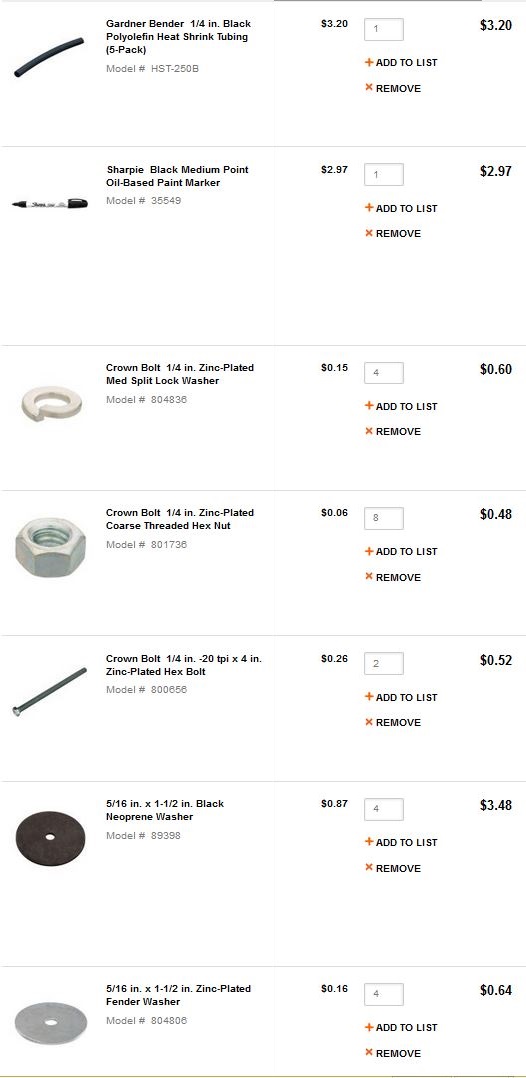

The Home Depot BOM is attached. The 4’ carriage bolts (2), large neoprene washers (4), large metal ‘fender’ washers (4), lock washers (4) and nuts (8) cost about $10 at Home Depot. As shown in the diagram I added a nut on the head end of the bolt to adjust the spacing of where the plate ended up relative for the grille crossbar. I didn’t want the bolt sticking out beyond the nut holding it onto the plate. This setup leaves the plate ‘floating’ about ¼ inch in front of the grille crossbar.

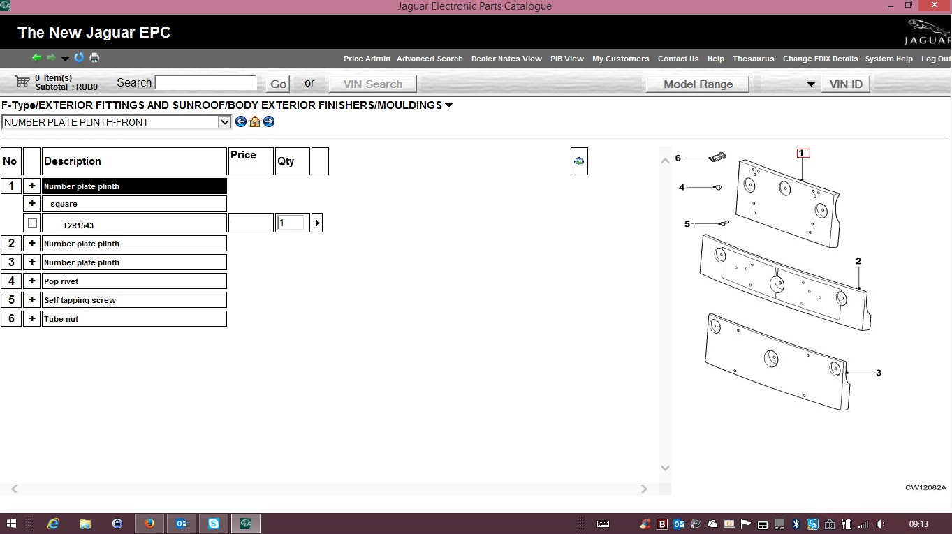

For USA members who also have to fit front plates, Jaguar list a rectangular plinth for the USA size plate (see item 1 - P/N T2R1543):
The rear of the plinth is moulded to the contour of the front bumper so it at least looks as if it's meant to be there! I've seen UK owners of earlier models fit the plinths with magnets to avoid drilling but when it has to be displayed all the time, there seems little point.

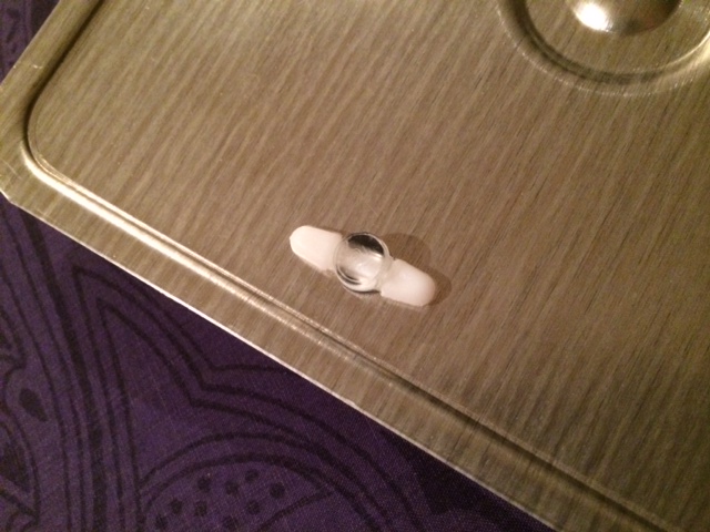

I use this pin-in-cup solution mounted in my front window in parking situations only. Picked them up at my local Oreilly Auto Parts store. Passed the "street-test" many times, though I often wonder if the meter people live in my trunk...
