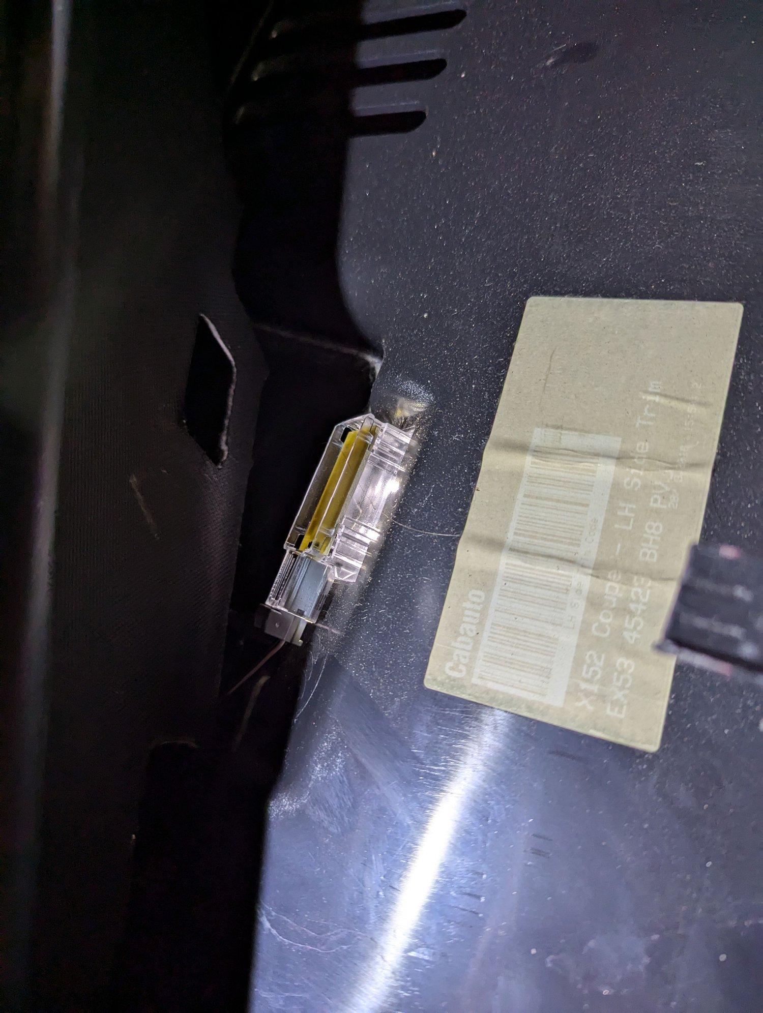

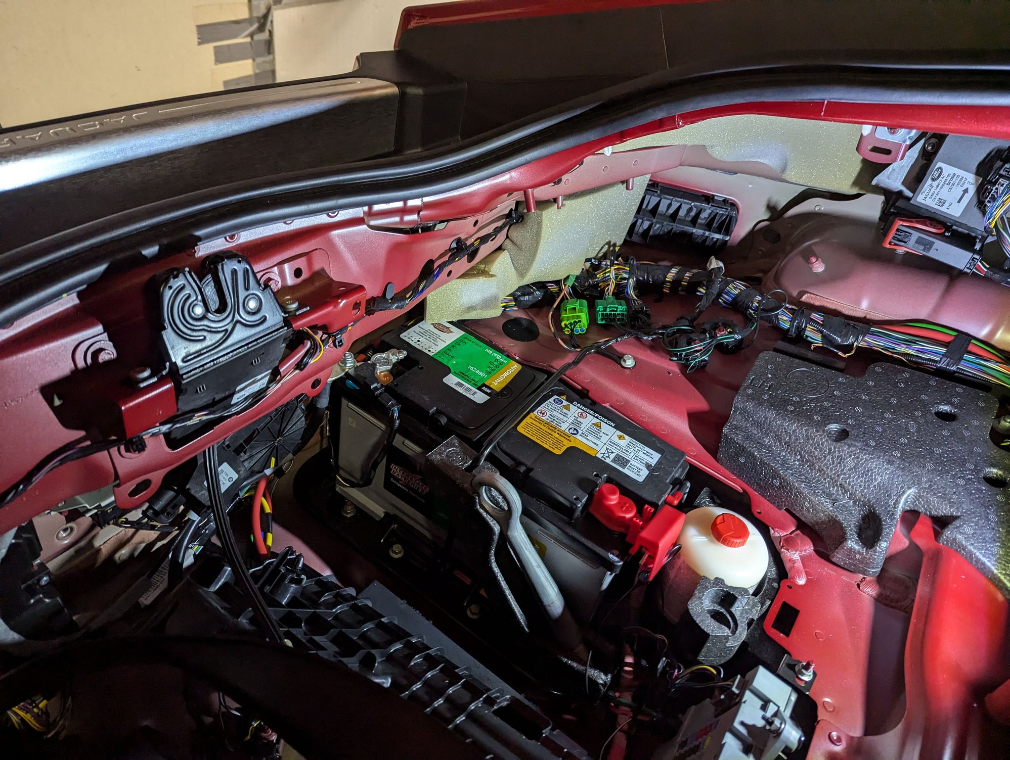

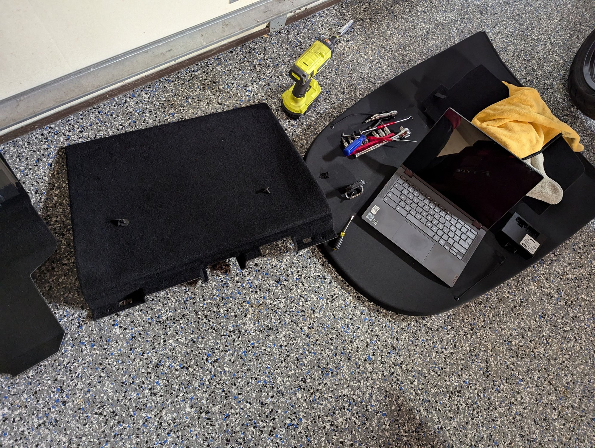

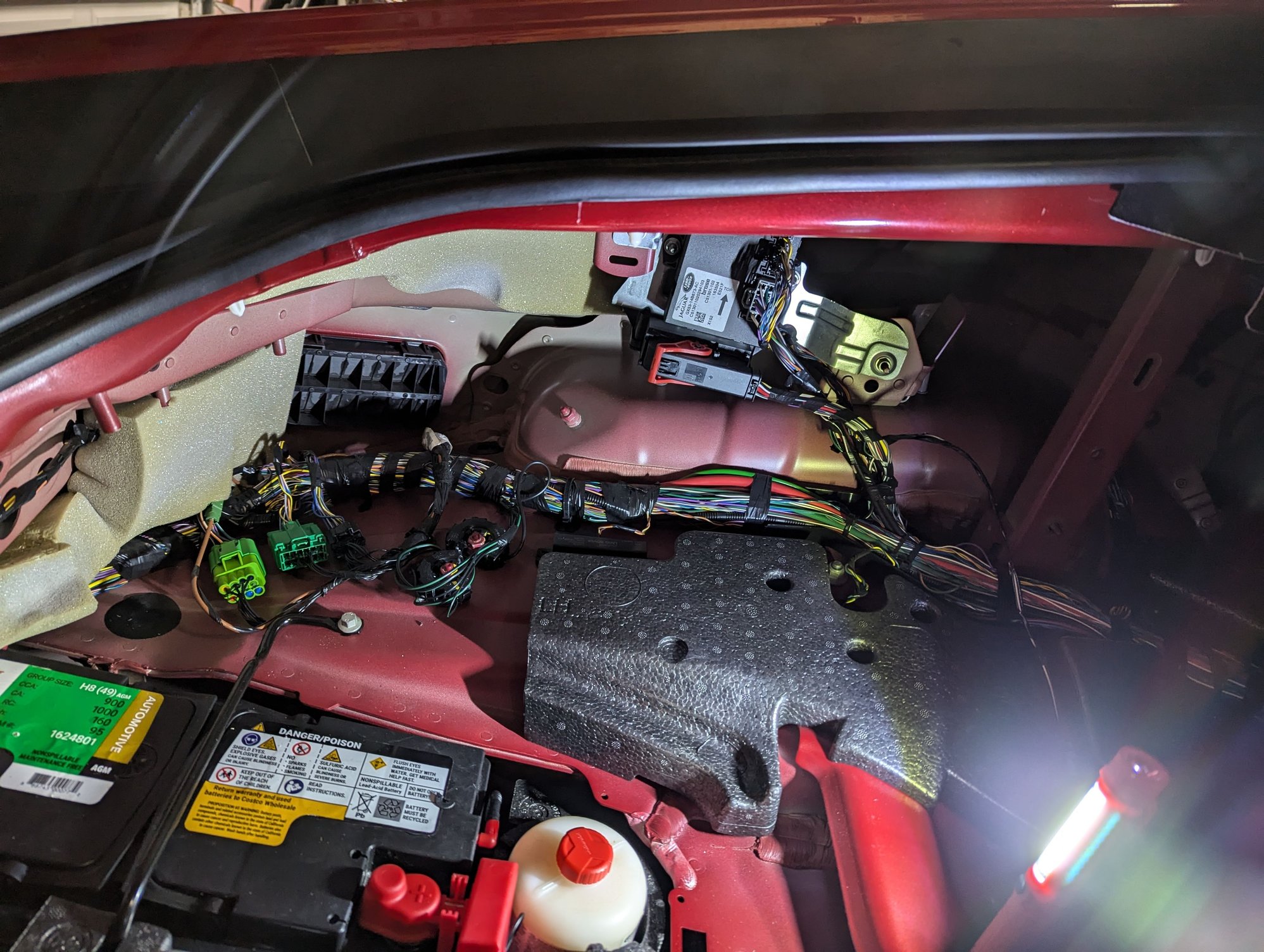

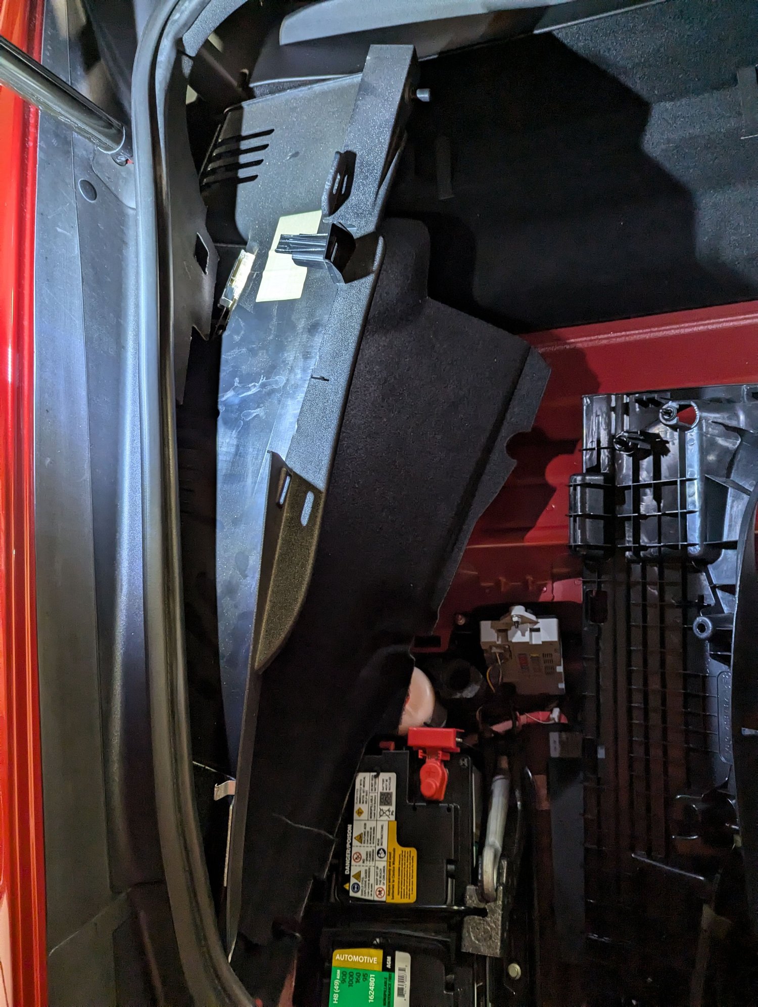

Okay, after a couple of hours (maybe more) of carefully muddling through it all, I finally got the panels off and the module installed. It worked! I am so damn happy that I finally got it completed. The part cost about $50.
So the panels were the hardest part of the project. Once I removed all the compartments, flat panels, battery cover and the hatch panel (?), the final panels were the hard plastic rear panel (the one with the emergency release handle) and the driver side panel that covers the modules. I carefully popped out the tabs from the compartments panels and side panel, then popped out the rear panel which needed force, and then a plastic trim piece on top of the side panel.
I got the module and tested it, but it wasn't working. Then I realized that I needed to disconnect the negative battery post. Once I did that and plugged in the module, then connected the battery again, the hatch worked!
Here are some photos for you all.
compartment panel covers and hatch umbrella
major driver side panel
everything is out
everything is out
the module location
the module location
driver side panel
driver side panel
trunk light
trunk light
