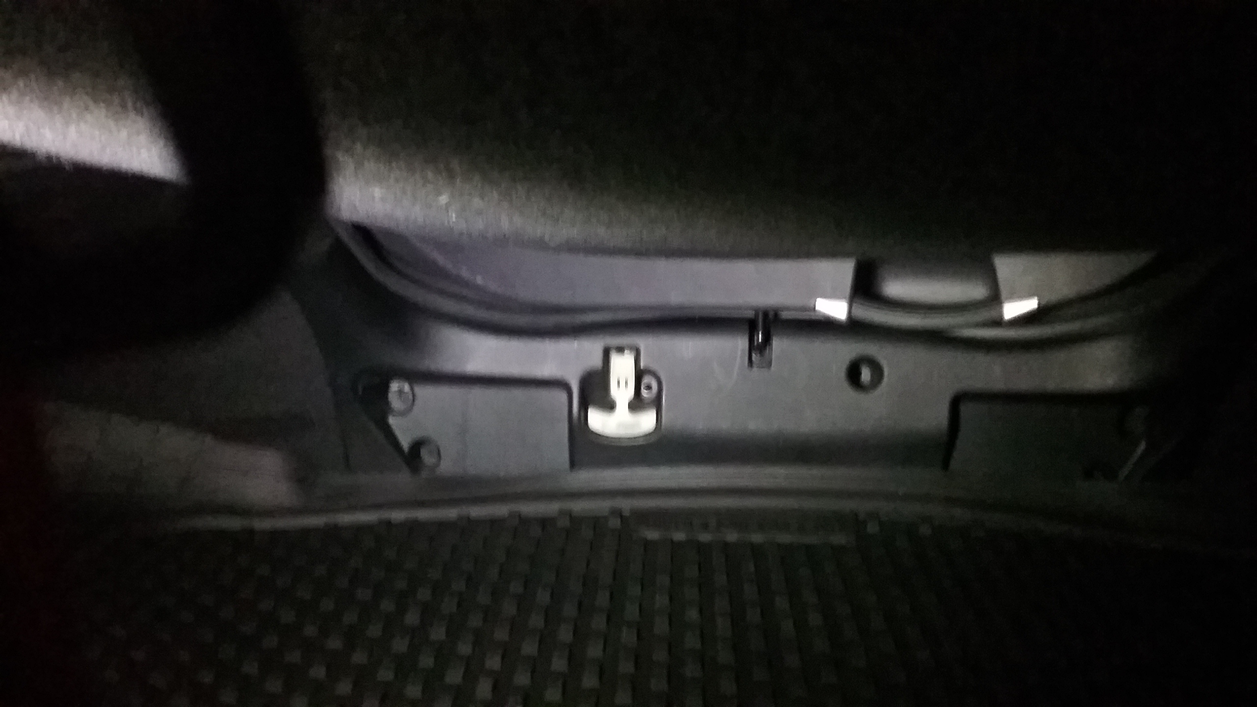

2016 F-Type S Coupe. Need to open rear hatch after accidentally closing with battery disconnected. Also which relays activate the starter sequence located in the engine compartment fuse box. The starter clicks when the ignition button is pressed and the clutch peddle is fully depressed but the starter will not turn over the engine. I get a second disengaged click after a couple seconds. I pulled the starter and a bench test seemed to show it functioning properly. I did order a new starter but not sure it’s my problem.

If you can get the hatch up from the front seats, high enough to insert a long rod with a small hook on the end, you can snag the emergency opener pull.

First I’d like to thank Valerie as to opening rear hatch, got er done! I attempted a push start in my driveway basically to ensure the motor turns over, the engine did fire but would not stay running. I think even with the new starter something isn’t right I’ll know more tomorrow. Thanks for the input.
