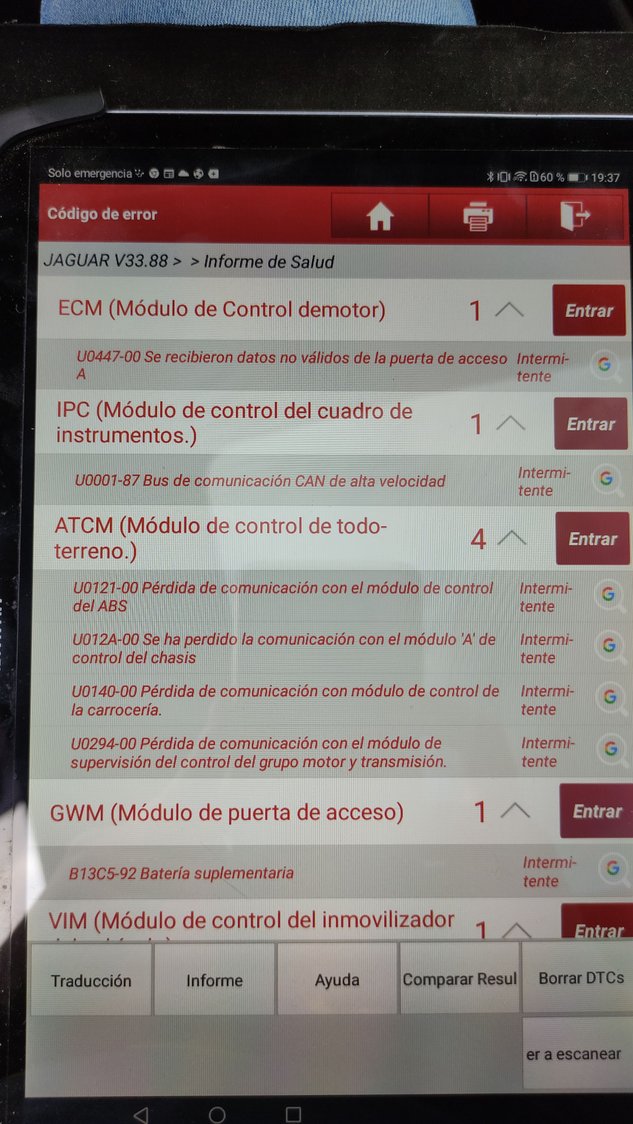

Diagnostic machine error codes
No idea what that says (I only speak English, and Italian and French curse words ).
Since you just changed the fluids, I am going to suggest something is out of line, or loose. When you or whomever did it, you may have not re-fastened something properly. Assuming it was not there before you did the work?
I would try that first, before assuming you have bigger problems. Check for loose fasteners, heat shields and plates.

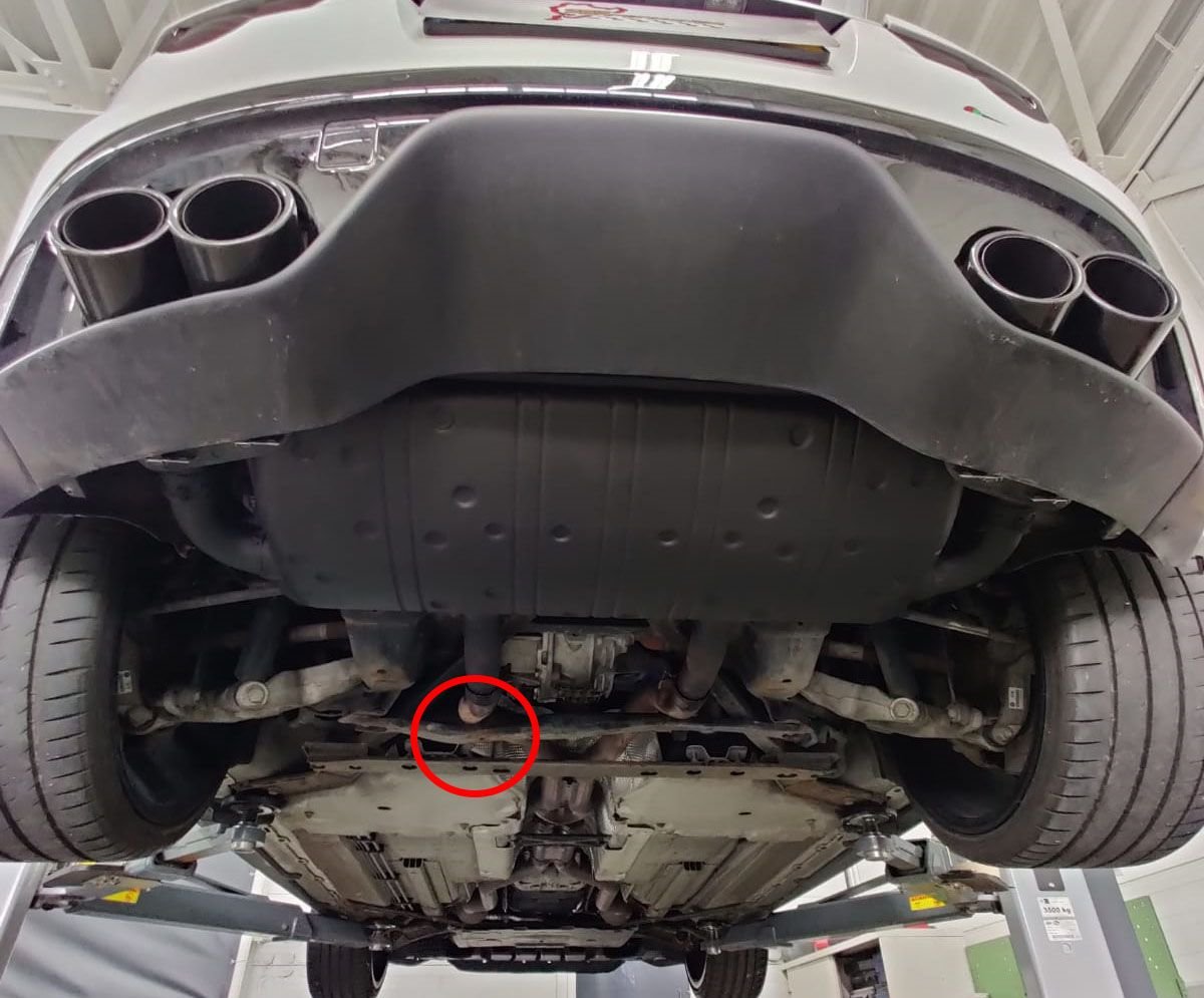

I had my diff refurbished (not sure exactly what Jaguar fixed under warranty, listen about bearings, etc but they didn't specify), at beginning also felt some vibration under seat and on back, i assumed was Winter tyres but then a whining started a low speeds. I also asked for all fluids changed (flushed) on gearbox. Is perfect now.
Also, they fixed exhaust piping rubbing on subframe, and it vibrates quite, check that (by your description looks exactly that).

Try go under the car and check if the exhaust pipe (my case was the left one) is not too near any reinforcement or chassi, use a crowbar (gently ) to verify.
