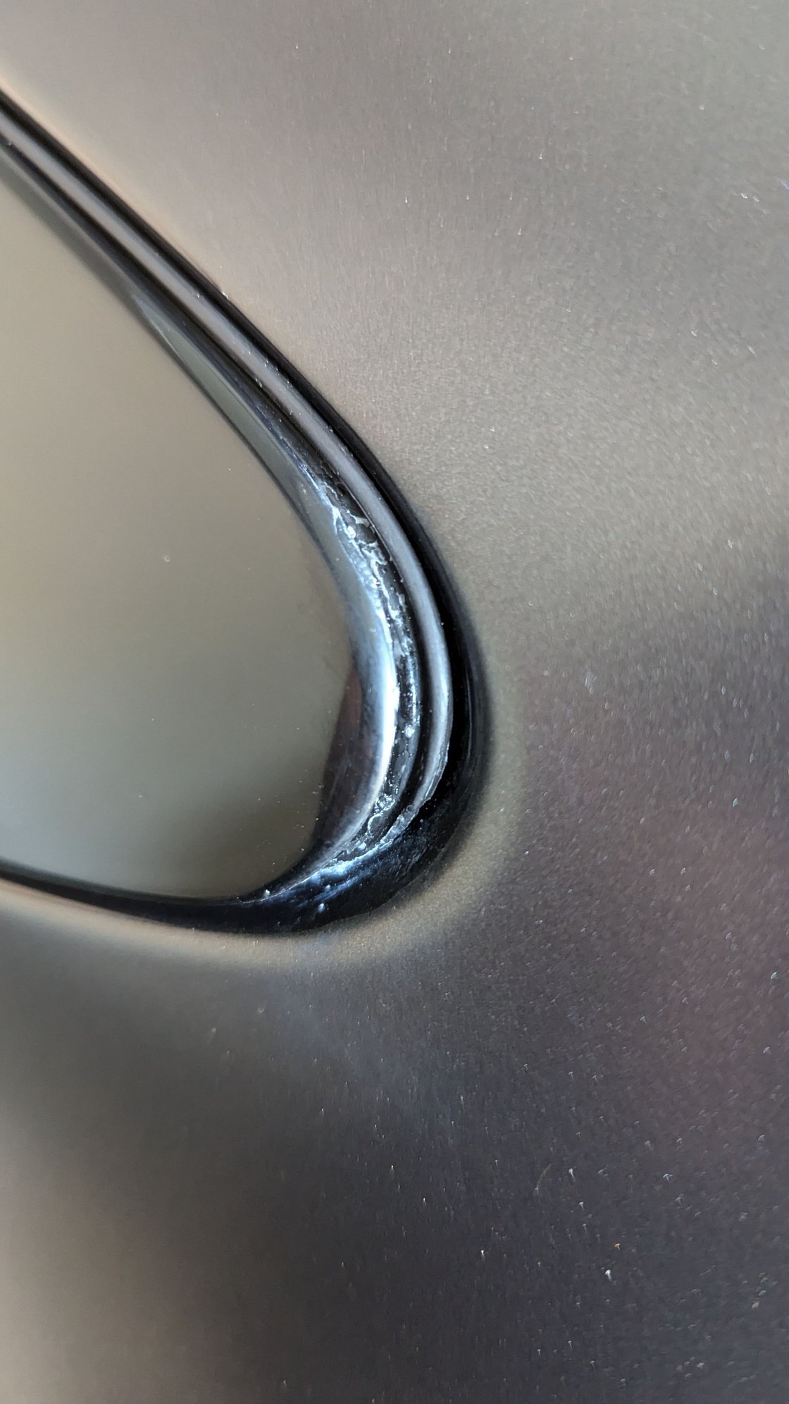

Update, here is a couple of photos showing the trim lifting. On the driver side (left) its more noticeable from than right (passenger) which is fine because I tried some super glue to fix it but it didn't hold and left white flakes underneath from the glue. Less noticeable from a distance but is up close under light.
driver side trim
passenger side trim

There was a thread around here somewhere and in it, suggestion to just superglue it back in place. Yes, a new F under warranty shouldn't have to be repaired by its owner and should be repaired in a timely manner, and it's not, so decide for yourself!
I had the same problem on my MY2017 premium coupe. Oz suggested super glue or the Oz equivalent thereof. I have some of the gel formula, it doesn't run on the vertical as much as the regular kind. I used FrogTape to protect all around that rear corner and gently squeezed some in from the top. Pressed it down and held it until it stuck on its own. Left the tape on until I felt the glue was cured and then removed it. Worked fine.

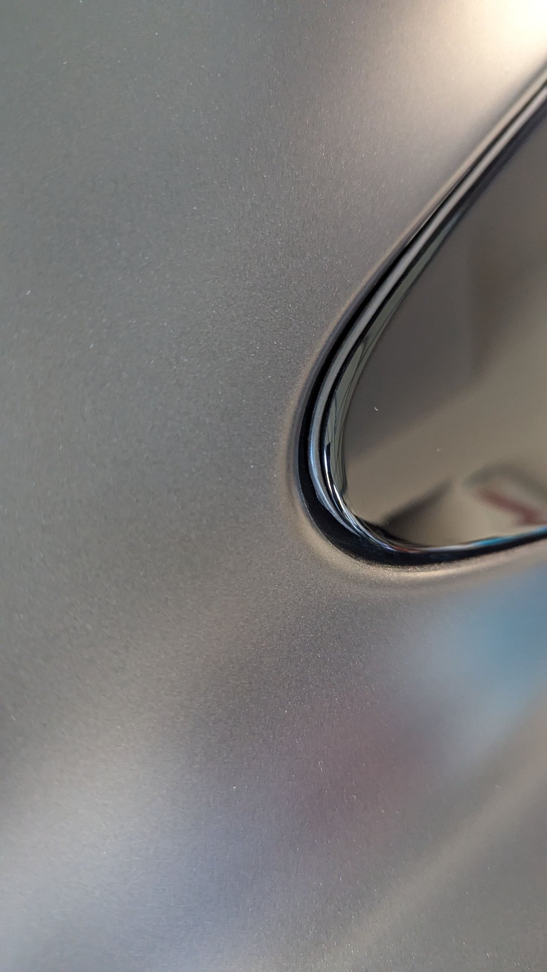

Here is a picture of the Quarter Light Trim lower leading edge issue on my car, where it has come away, on the right hand side of the car. The other side is the same. There is a slight curve in the body below this point and what I think is happening is that the plastic Trim moulding doesn't have this curve moulded in and it relies on the sticky pad underneath to hold it down, but over time and hot summer temperatures, the sticky pad has failed?
Old Sep 30, 2024 | 07:25 AM
OzXFR's Avatar
Posts: 9,030
Likes: 3,664
That is how the exact same bit of trim on my car looked when I first got it just over eight years ago now.
Easily and permanently fixed back then with a small dab of gel super glue.
Must be gel not runny to avoid the glue squeezing/running out and making a mess of the trim/paint.
All I did was put a drop of the gel glue on the end of a toothpick, gently pry the offending trim up a little further (say around 2 mm), carefully poke the dob of glue well under (away from the edge), spread it around a little using the toothpick, extract the toothpick, then press down medium hard on the trim and hold it like that for about 60 seconds.
Came out looking like new, no fuss no muss, and hasn't budged a micron in the nearly eight years since.

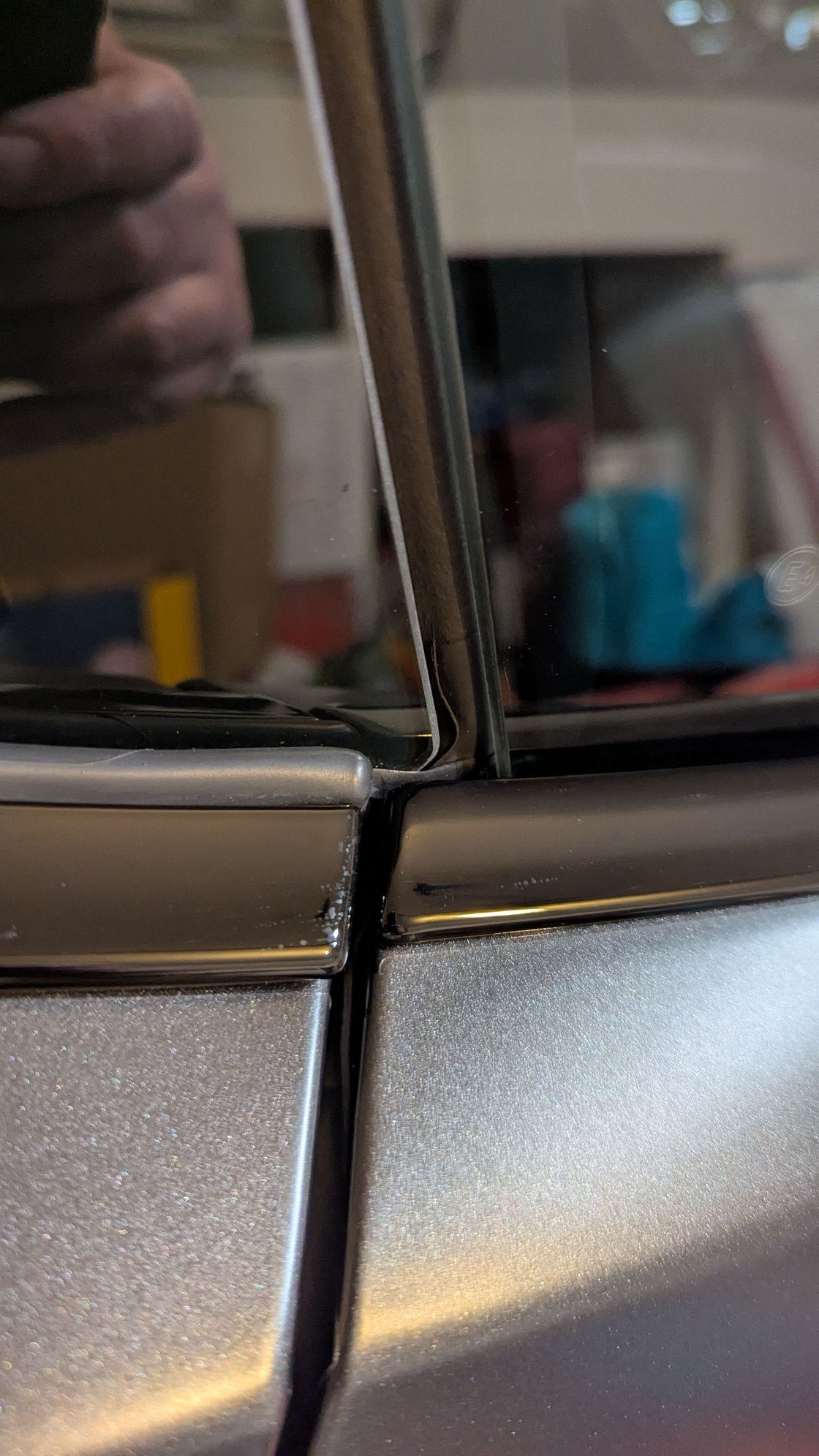

Update that I finally had my 2024 F-Type's trim fixed under warranty by a Jaguar dealership. Thankfully they had the part in stock and the Service Advisor said the part alone was $1,503 😲 Also said they had to remove that side rear fascia glass and some headliner to replace that trim. Stupid that Jaguar couldn't make it with clips like any other car manufacturer could.
The trim was replaced and looks fine however they misaligned the side rear fascia glass so it wasn't flush with the driver side window, see below photos. Not only looked odd but it created wind noise so I had to take it back but today they fixed it all well and good thankfully.

My local dealer isn't terribly skilled at this repair either. This is a new car in their showroom for 90K:
