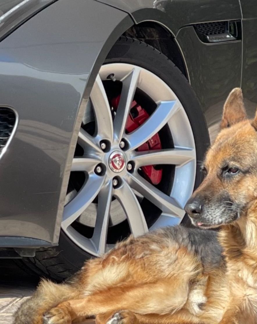

Edit - I can tell just by looking at close up pics what brakes you have so if you can take some reasonably close up and clear pics and post them up (no need to take any wheels off) that would help a lot!
Rear
Front
front
Old Jan 16, 2023 | 05:30 PM
OzXFR's Avatar
Posts: 9,020
Likes: 3,658
Thanks for the pics (that was fast).
Sorry, bad news.
You have the base model brakes, 355 mm front and 325 mm rear.
The red does not look like the factory red colour to me, my guess is someone / a previous owner has painted them.
