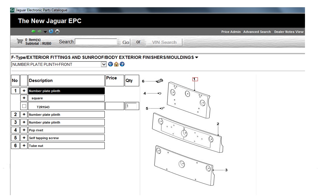

I expect the US will use the rectangular Plinth (item 1) which is usually fixed with pop rivets but could be done with self tappers:
