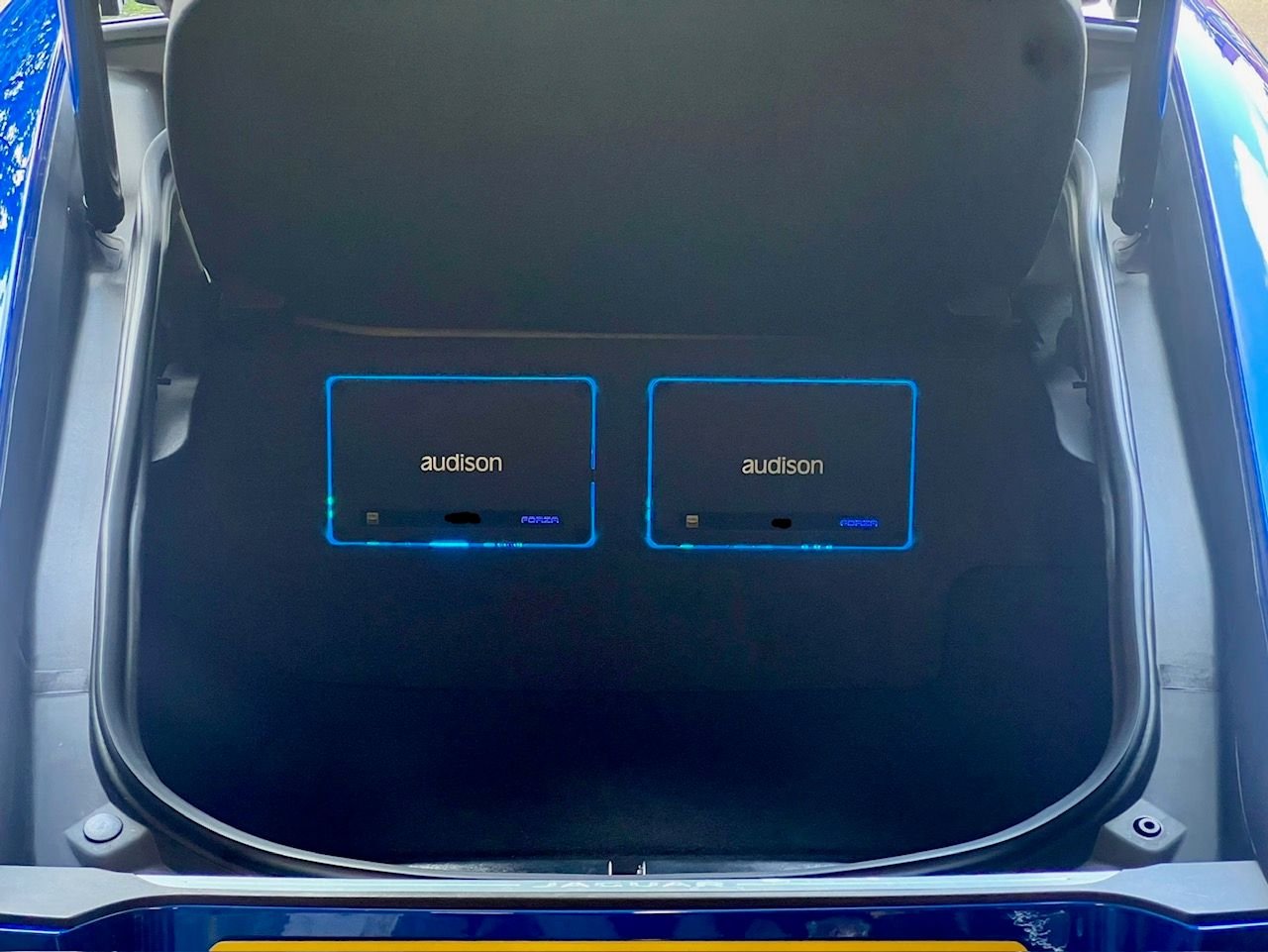

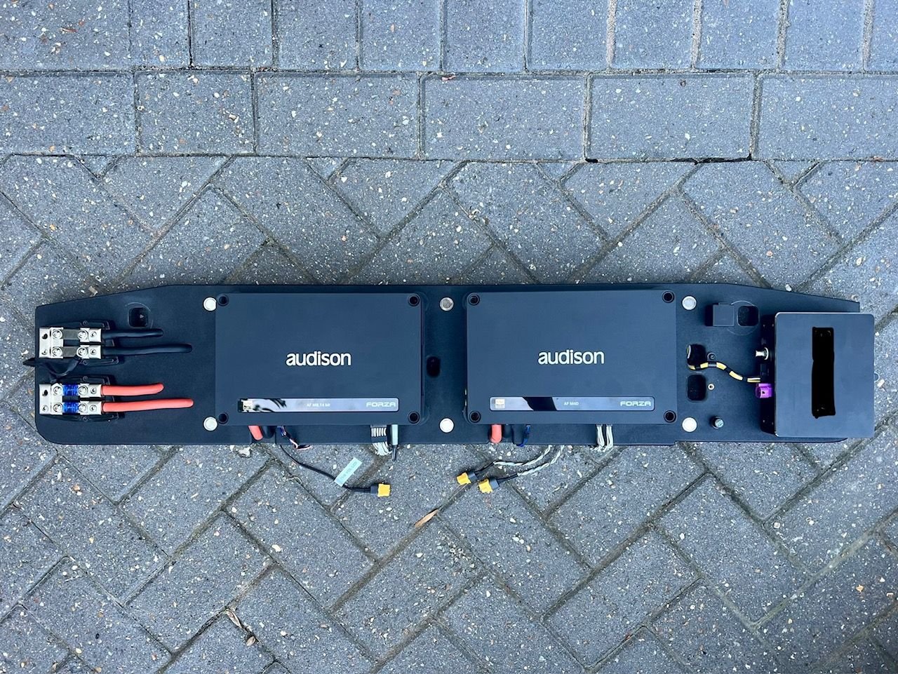

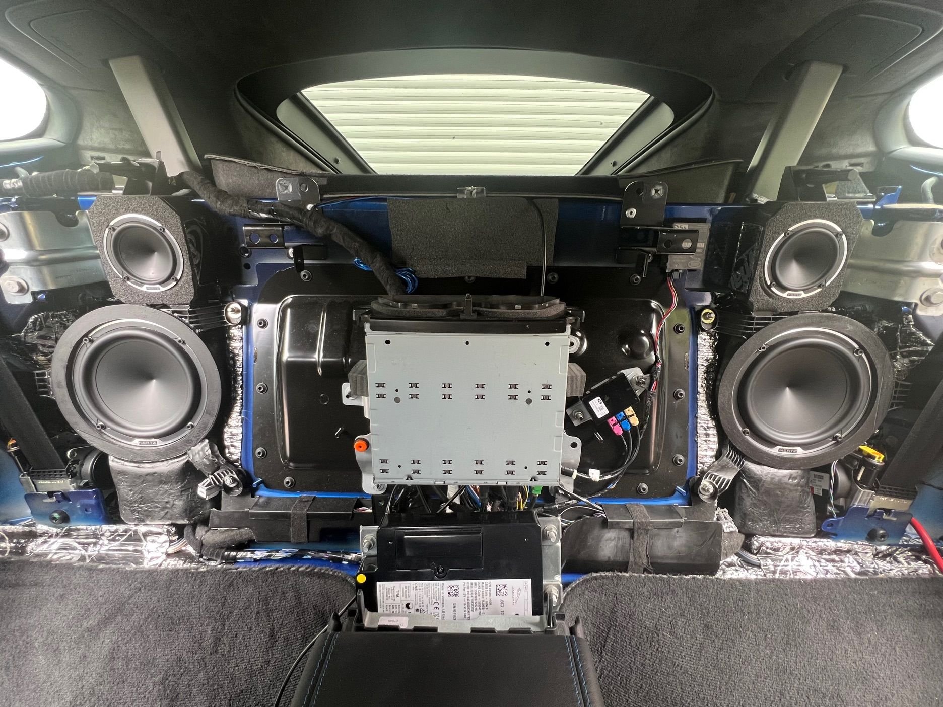

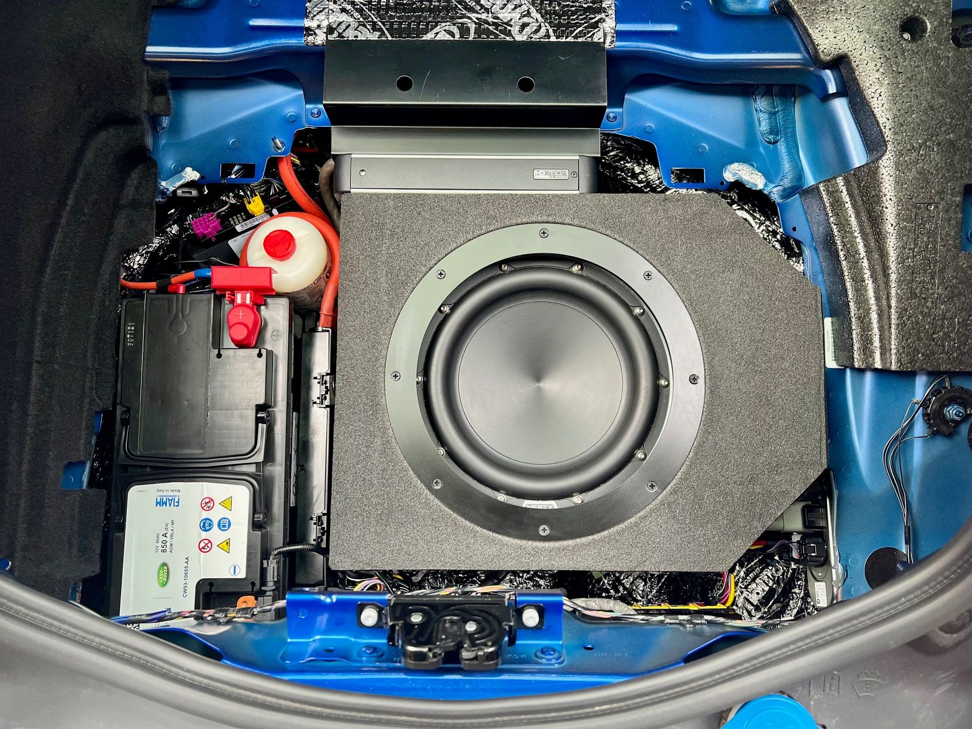

Might be ahead of the curve here on my 2019 SVR with two new Audison Forza amps (one a DSP) powering new Hertz Legend speakers all round with dedicated wiring. Also a JL Monoblock amp running a 10" sub in the boot to provide over 2500 watts in total with still room for golf clubs. OEM amp gone and replaced with Digital Ethernet Decoder (not a Mobridge as they won't say when theirs is ready). Maybe the first currently installed in a f type. If you have M.O.S.T protocol (fibre optic ring) in your car instead of the most recent ethernet then you use a Bit DMI instead of the Digital Ethernet Decoder. Either one goes between the head unit and the DSP. Without these you leave the OEM amp in place and use the speaker outputs from the amp as your low level inputs to your new DSP amp. Still a nice sound but elimination of the OEM amp brightens things up albeit naturally a little loss in volume due to the elimination of that amp. But not much though as it's insanely loud :-). Catch more info of my self build at new instagram page.....TrueBlueSVR.
Forza DSP amplifier with slave amp. Alcantara covered beauty panel.
Amp mount with Digital Ethernet Decoder
Reworked OEM tweeter sails. Covered in nappa.
Re-worked pods for mids plus custom grp housings for woofers.
Custom enclosure with 10" sub and monoblock amp
