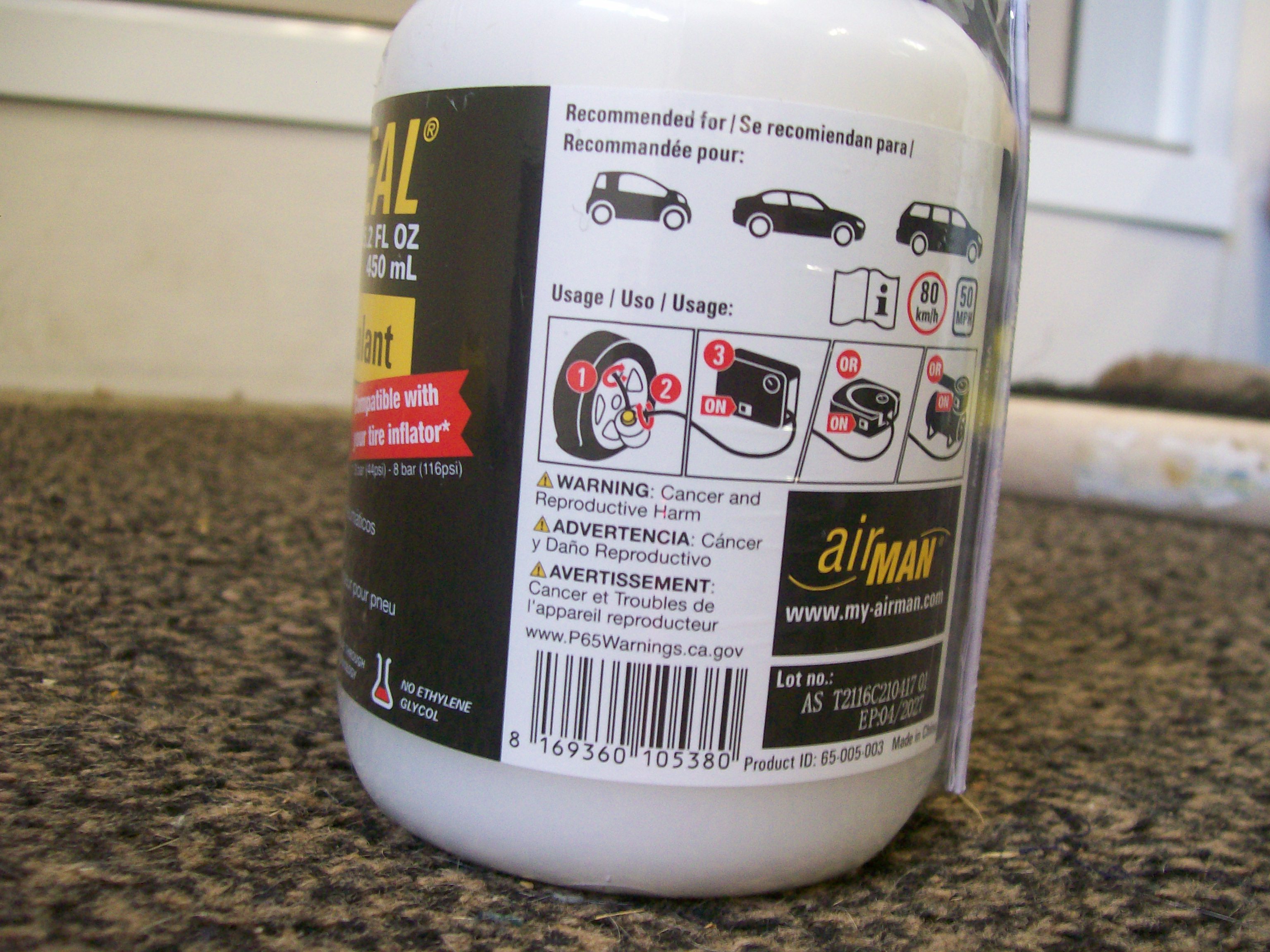

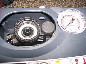

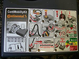

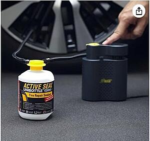

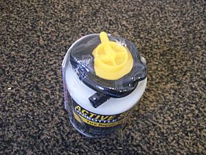

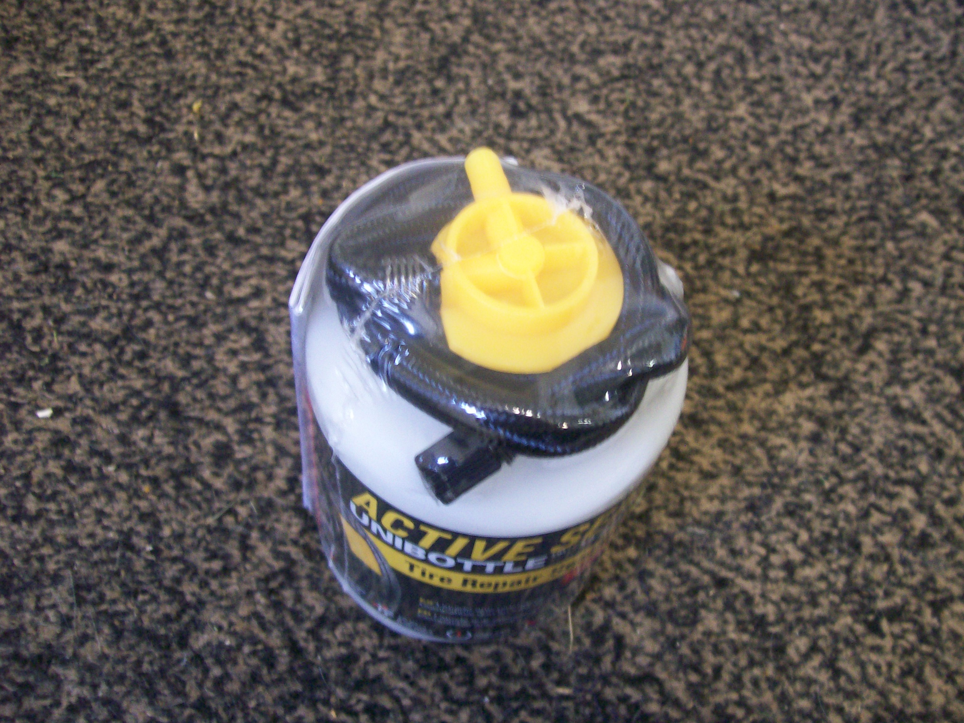

Default It's the Unibottle
AIRMAN Tire Repair Sealant 450ml UNIBOTTLE ‎65-005-003 which measures ‎3.54 x 3.54 x 7.48 inches and costs $24.99
Which one was ordered that was too tall and do either of them work with the existing Jaguar compressor system ?
I bought the Unibottle 65-005-003 , it fits perfectly in the old spot in the trunk and as I wrote above, connected the hose/line from the OE JLR compressor to the little extension on the Unibottle cap. It's threaded the same as a tire valve The original setup for using the JLR tire sealant was to screw the sealant bottle in the top of the JLR compressor, then connect the hose/line to the tire valve, IIRC, put the car in accessory mode, plug in the pump's power connection and fire away.
With the Unibottle, you connect the tire hose/line from the compressor to the threaded extension on the bottle's cap, then the second hose goes from the Unibottle cap to the tire valve.
