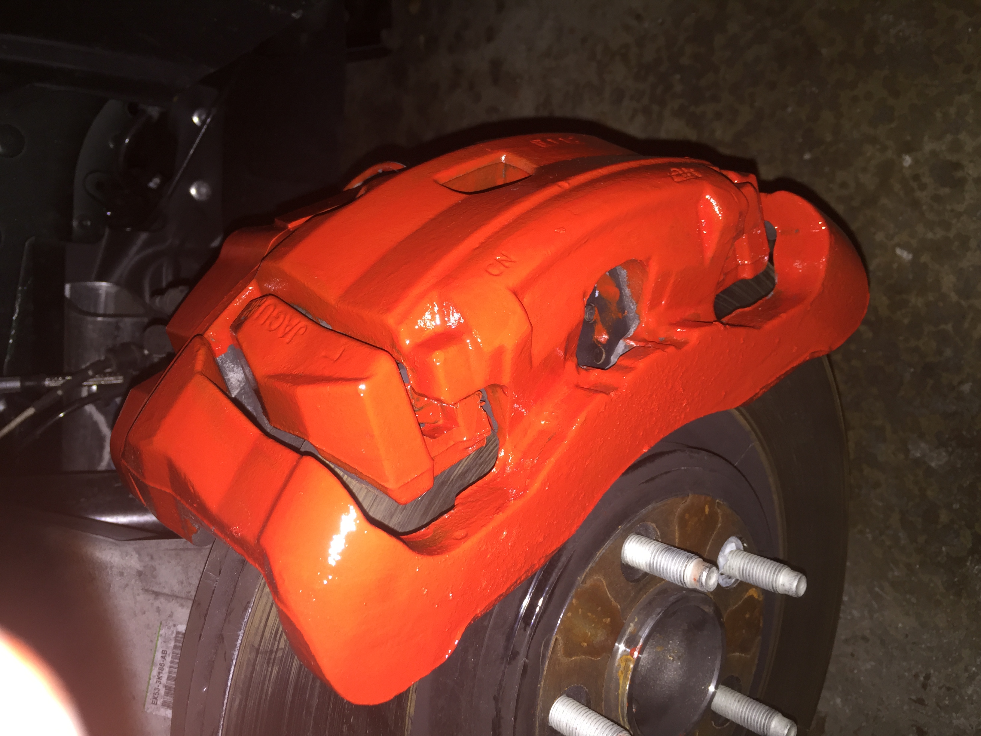

Default G2 Red Paint
Just finished painting front calipers with G 2 red paint. I did three coats. Waiting for it to dry before I replace the anti-rattle springs which I left unpainted. These will be replaced with any brake job and probably not with the same color red anyway. I will do the rears on another day. I apportioned 40% for the rears. I converted the 3.5 fl ozs of paint and 1/2 fl oz of reactant to ccs and poured 40% of that into graduated tubes from my lab. I will use that for the rears which are much smaller. The remainder was enough to do three coats on the fronts and then some. Love the glossy sheen. Red calipers were a $1650 option. The G2 paint was $40. I bought two foam paint brushes, one about two inches wide for the wide areas and one quarter inch for the detail work. No hairs or brush marks. I don't see how anyone can get a good result using the tiny hair brush that is supplied. I jacked up the car using a floor jack and a grooved rubber disc both for the jack and jack stand using the pinch weld track behind the triangular marker. No damage to any plastic or metal peices.
