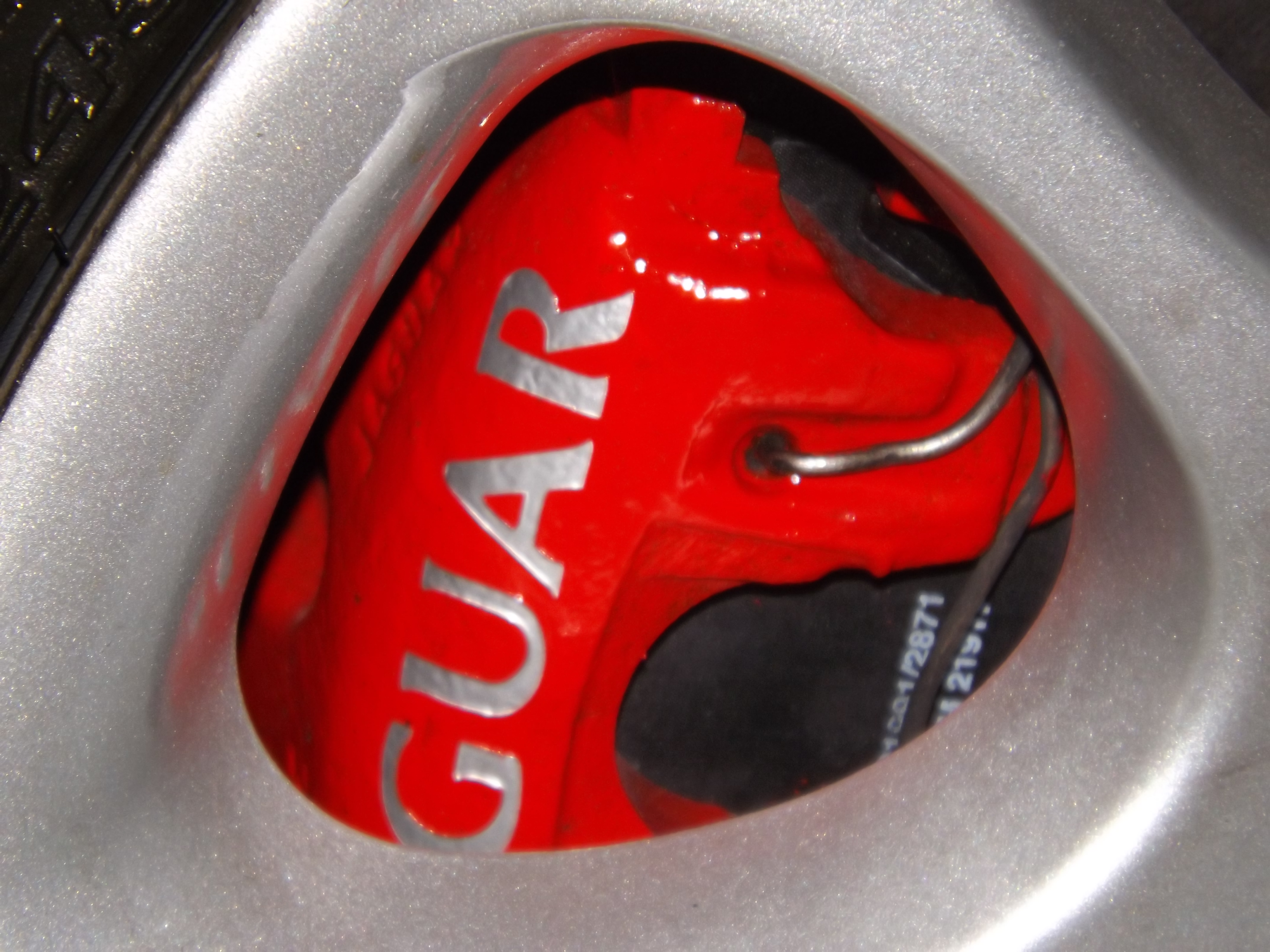

Many years ago, I painted the calipers on my X100 with the Duplo kit. It looked great for a while, but the uneven surface tends to trap a lot of dirt that you just can't scrub very clean without removing the wheels (which was a pain in the ****). But you can get very nice results as a d.i.y. project.

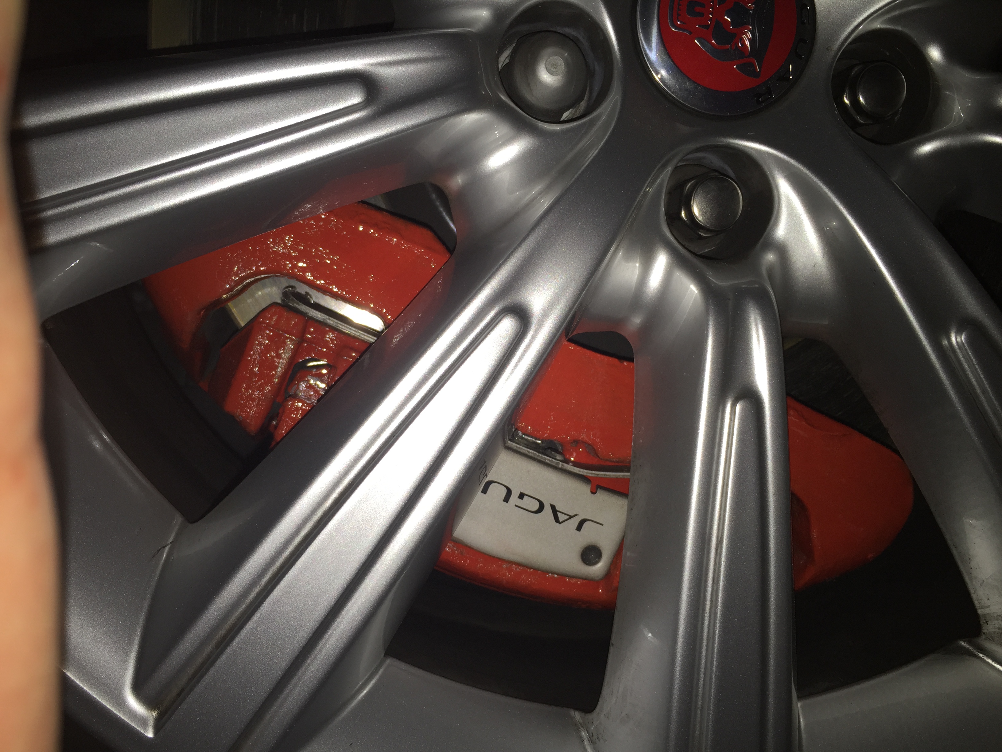

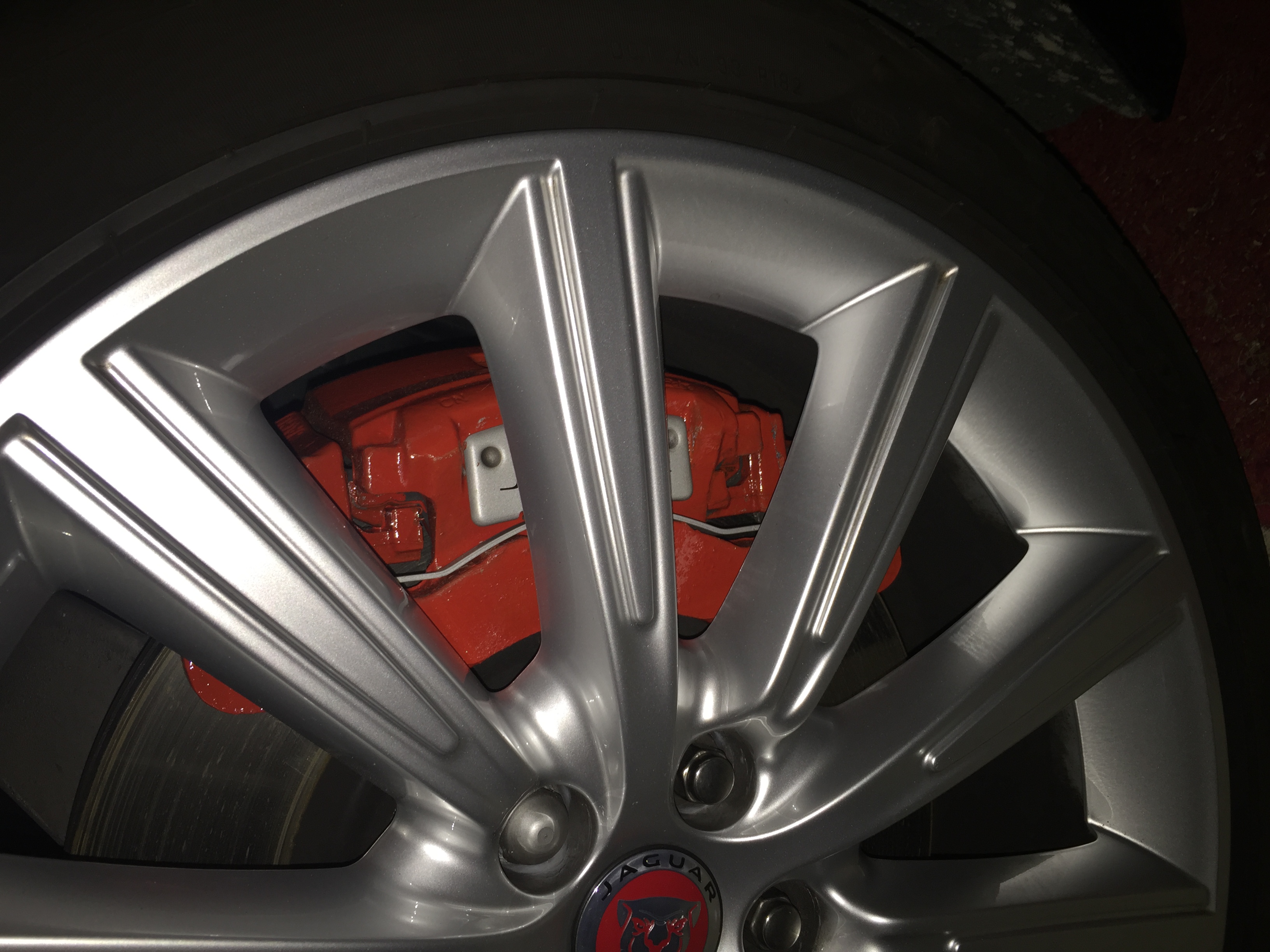

Here is a side view of before and after lmk what you guys think
After

Nice. Definitely a great shine. Would love to see the after pic in a similar light to the before pic to really catch the change.
