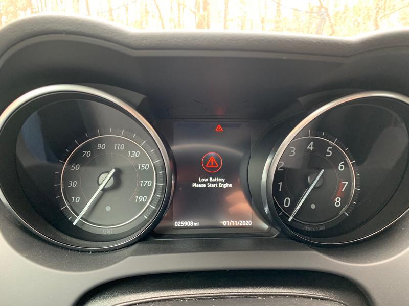

I went out to my car this morning and here's what I saw when I got in.
It seems to crank up fine though.

Originally Posted by Bret_T
I made an appointment with the local Jaguar dealership for nine days from now.
A low battery can still crank an engine, but the voltage may be low enough to cause a multitude of system failures. You may have a bad battery, or the OBD port may have been recently accessed.
Old Jan 11, 2020 | 07:23 PM
Bret_T's Avatar
Joined: May 2015
Posts: 299
Likes: 37
From: Georgia
I assume that the OBD port was recently accessed given that they pulled a code. I drove it some today and the check engine light went off, plus there no longer a low battery message. I don't know what to make of all this.
