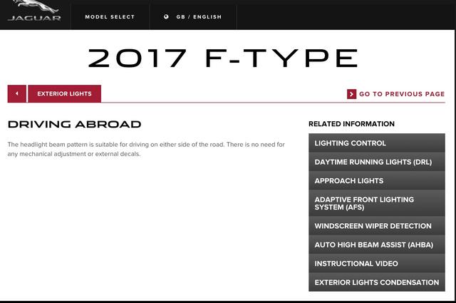

as to Jag's website, they are only talking about temporarily driving in another market, not as fitted from factory

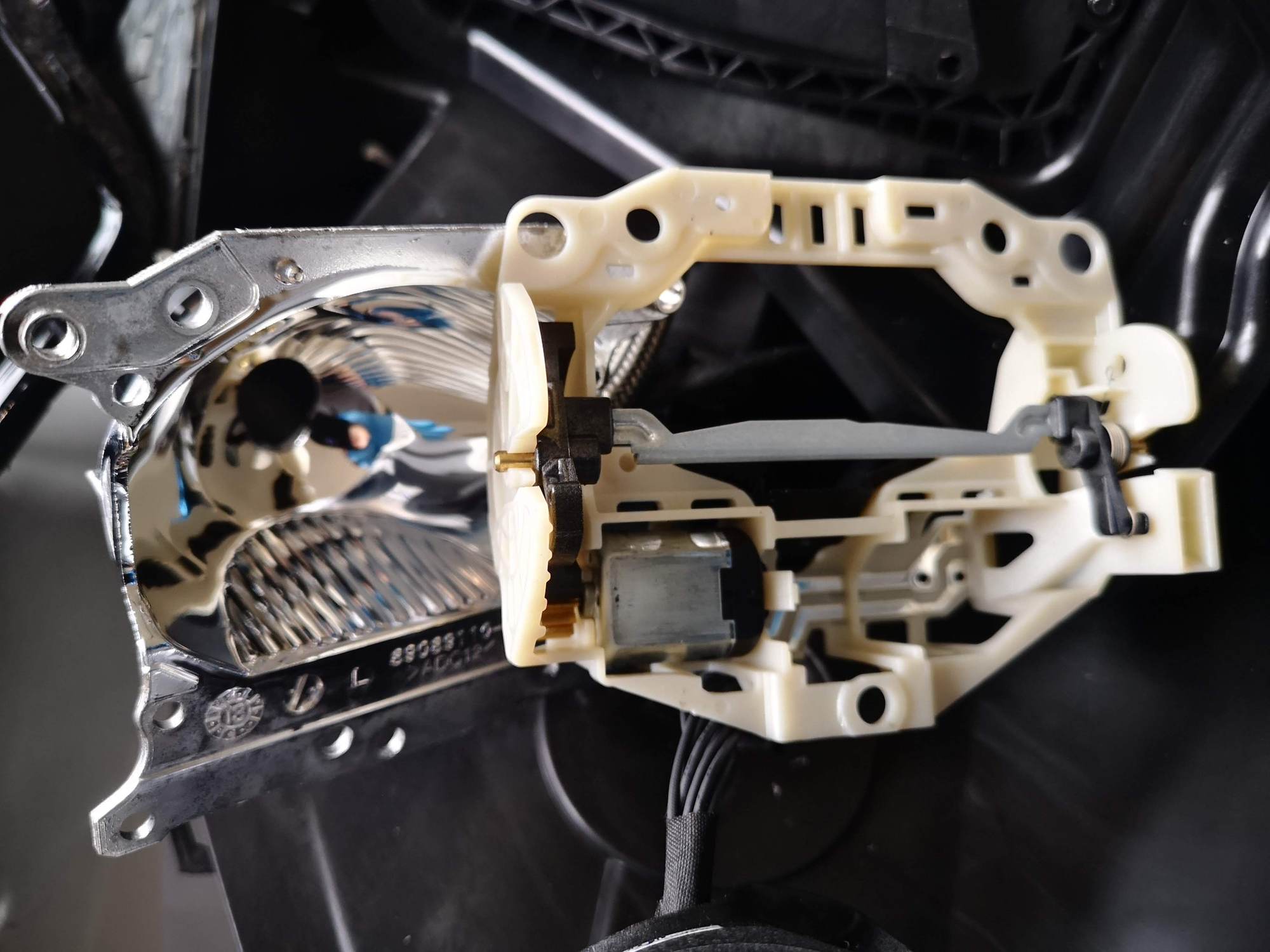

Hi.
The Photo of inside headlight without ASF. If you need conversation RHD to LHD than you repleace only shutter under lens .
Tips.!
The shutter fits from other bi xenons brand VALEO

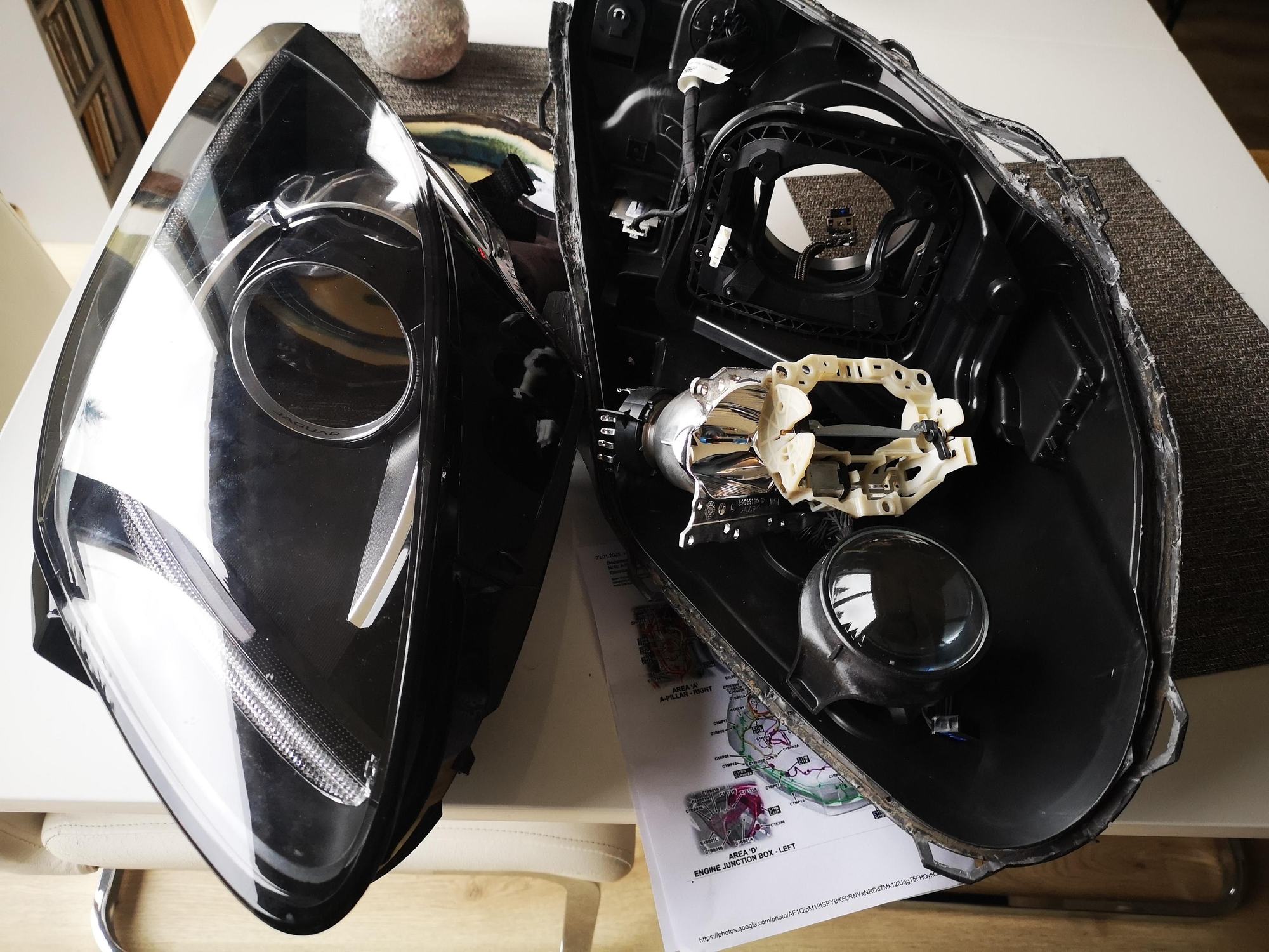

Hey off subject BUT you got the head light apart!
Can you share how you did it? Oven baking at a certain temperature works on other lights but these late model ones seem to be harder to split.
You need use to Hot gun directed towards the edges of headlihgt
Set up temperature about 270 C
