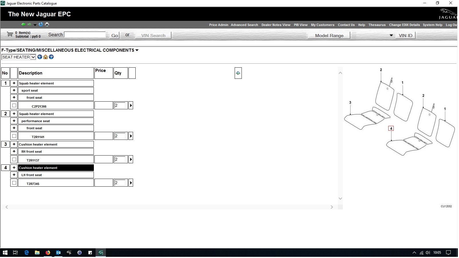

Even Jaguars with Heated/Cooled seats (like my XK) aren't linked to ambient or AC temperature. They all simply go to the selected setting.
The cushion and squab have separate heating elements linked though the harness.
(double click on the image to enlarge it)
It sounds like you have a poor connection but the cushion heating elements in particular are very easily damaged. A regular cause is from owners kneeling on them when cleaning the interior.
