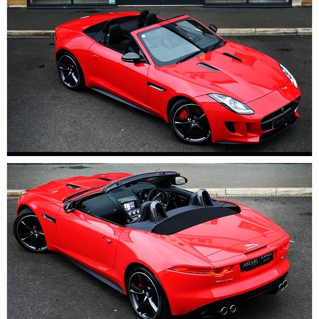

Hey all
My first post on here having bought an F Type a few weeks back. Hope you don’t mind me coming straight in with a question?
I’m planning on getting some of the Velocity progressive springs with the small drop in ride height. However I’d also like to space the wheels out slightly. The ideal would be about 15mm but I understand I’d have to shave the studs. I’ve read on here a company doing some 17mm which were designed to negate the need for stud shaving, however I also read some still have to?
Ive got the carbon blades fitted to my car, does anyone know what the minimum size spacer I need to get where I don’t need to mod the existing studs?

You can go with the 17mm spacers, but don't plan on lowering the car (15mm needed for that). If the 17mm spacers still cause an interference problem, you can always buff the additional clearance from the inside of the wheel (much easier than grinding hardened steel). If you do this, I would suggest rebalancing the wheel, but given the minimal amount of material to be removed (~ 10mm dia x 1mm deep at 5 offsetting locations) that probably isn't necessary.

I have the Blade wheels and VAP lowering springs and 15 mm spacers all round, and I have had zero fitment or rubbing problems.
Lots of posts here about 17 mm vs 15 mm spacers and needing to grind 2 or 3 mm off the studs, but as I have reported many times the Blade wheel does NOT need any grinding, not even with 15 mm spacers, as it has deep enough recesses between each stud hole for the original stud to fit comfortably with zero interference.
