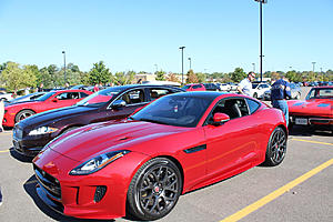

Blizzak LM-32s on Coventry ashfords that I had refinished to a dark gray. Stock size and offsets so no need to futz with hub adapters or spacers. I even pop in the growler center caps from the stock wheels when I swap them.
Nice. How about a photo.
Here's the wheel but with a different tire mounted.
Snow tires and wheels. Winter tires on dedicated rims for the F-Type. Recommendations-photo326.jpg

I really like the look of the black pack with black or off-black rims on the F-Type. Lookin good.

I assume you are running 20" rims? When I had Discount Tire call TSW/Coventry I was informed that their 19" wheel will not clear the 380 mm brake. Is that your understanding as well?

Originally Posted by Pard
Hi Nati,
Peter
Those are 19s, same as the factory wheels on the V6S
