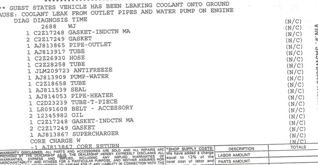

Old Style coolant pipes, determined to be starting to leak, replaced with "kit" which included new water pump.
They didn't note any part number for that 'kit'?
Or was it just a "while we are in there" repair?

So here is a scan of what was put in for the coolant pipe replacement. It appears that the SuperCharger oil and the Supercharger are both listed.
