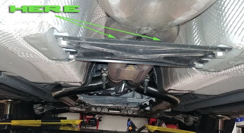

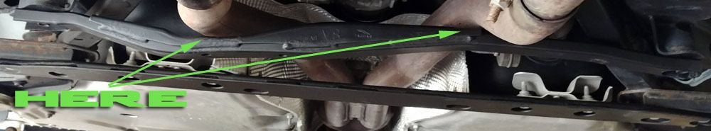

It could be what you described, but you can quickly check to see if the exhaust may be touching the cross supports at mid-pipe or rear...They are very close anyway...Worth a look. Examples below on a AWD R...Others are similar.
Or any number of the heat shields touching..
