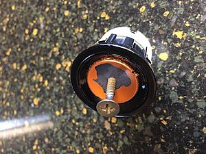

Default button simplified removal
like many, the start/stop button had become sticky. attempted cleaning with alcohol but removed the bronze color in the process. so i purchased a new button off ebay, reviewed the forums, and watched a good you tube on button removal. since i was removing the button to throw away, i wasn't concerned about destroying it. so i took a sharp sheetrock screw and drove into the middle of the button allowing me to easily pull the button out by hand. literally took me less than 2 minutes to change it out.
