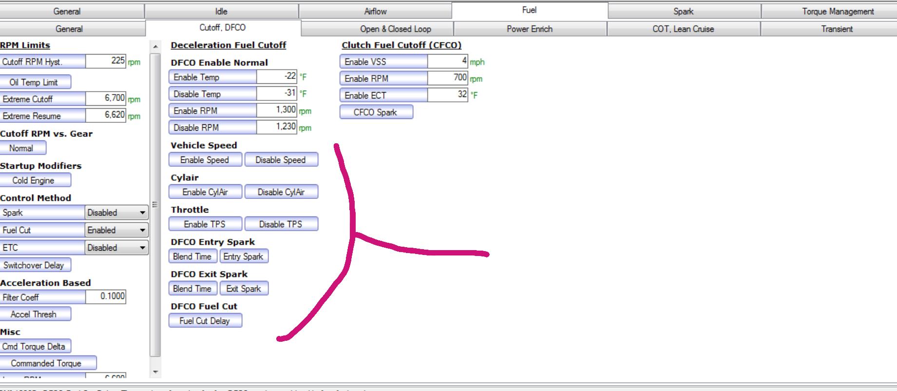

@OzXFR is correct. Exhaust noise on deceleration happens in the tune.
I tuned modern EMSs for about a dozen years, gave it up a couple of years ago. Using hack SW, I could access the various tables that the Engine Management System uses to manage Air/Fuel/Ignition.
This is a VERY large explanation VERY abbreviated.
In the fueling aspect of engine management, there is a component when you release the throttle pedal called Deceleration, Fuel Cutoff (DFCO). Via DFCO (and with numerous parameters) you can control the fuel AND the ignition AFTER throttle (air cutoff) is released, or closed. It is through these parameters that sounds on deceleration can vary, from nothing to very loud.
Many mfgrs that first introduced models that had lots of cracks and pops, and BC of very many EPAs around the world tightened up noise and emissions controls, upgraded their SW to eliminate the latent fuel and spark after throttle cutoff. So, some owners of cars that brought them in for servicing, had the tune upgraded (some with and some without their knowledge, but mandated SW upgrade). On later models of the same car, the newer SW from mandates was already installed. I played a lot in the world of the AMG GT and this is a classic example of the above.
With very light explanation, here is an example of what the page looks like in a tune where air/fuel/ignition can be manipulated on DECELERATION.
BTW, if I had access to the hack SW needed to get into any tune, I can make the sounds appear in about ten minutes of tune manipulation.
